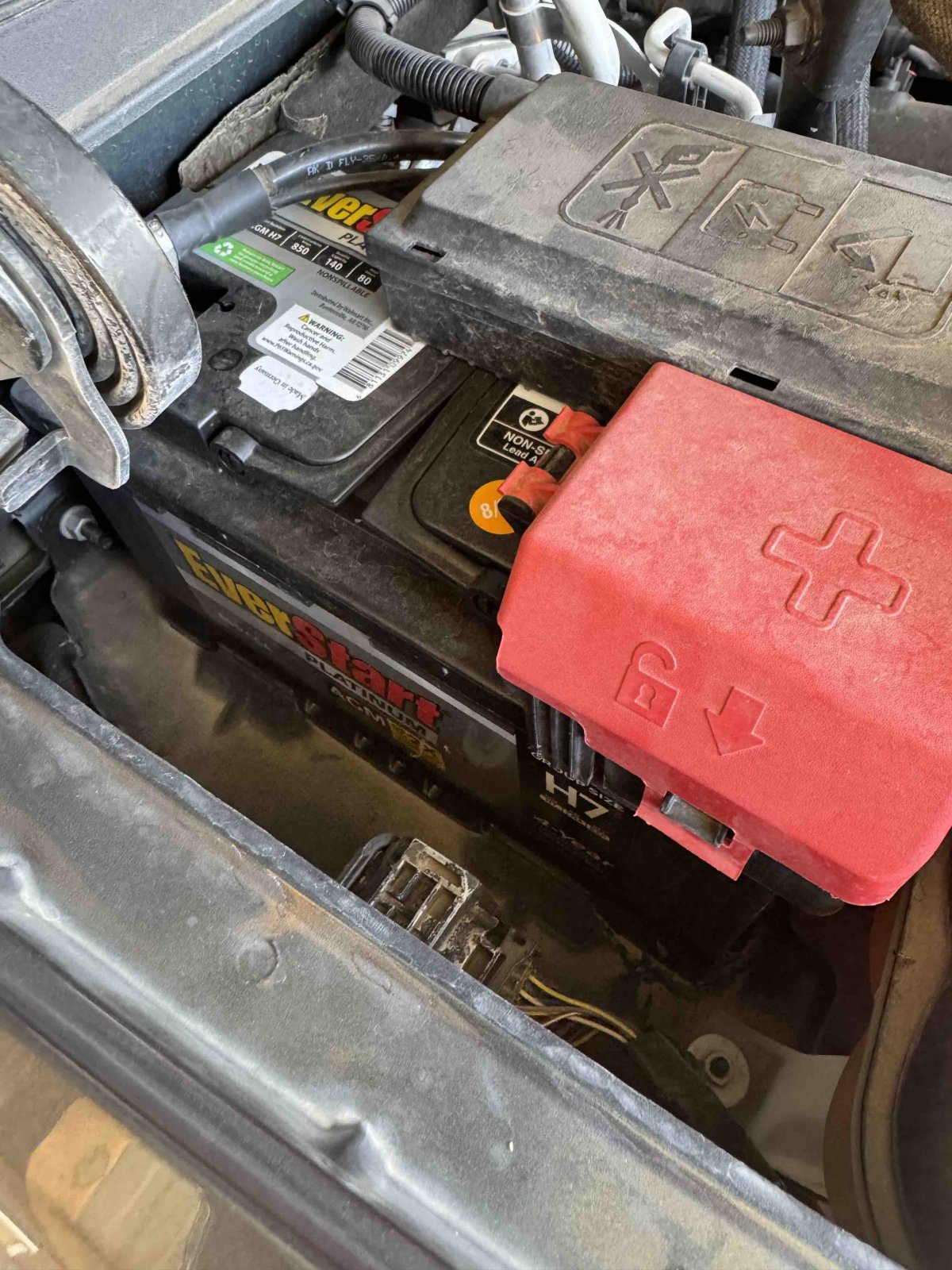

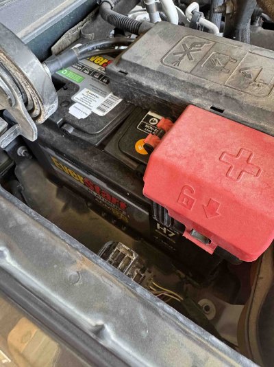

up my '21 YUKON SLT XL was giving me a 'no key' message, same thing happened to my Daughter in her Lincoln. I replace battery with Walmart's best battery and all that BS stopped. Great advice from the pro's here on TYF.com & everyday users. Thx. I put 'check Yuke' battery on annual reminder in my phone.
Right on! Good idea to check the battery on a yearly schedule, can't hurt I guess.
