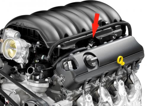

Disconnect the PCV line at the front of the block, near the throttle body. keep the other end of the line where the arrow is pointing attached.

Thanks for the help guys. So it looks like I just remove that gray “U” clip and the hose should come off? And then as I’m understanding I would spray away from the arrow into the hose portion and no spray to the “right” into the “L” clip/connector?

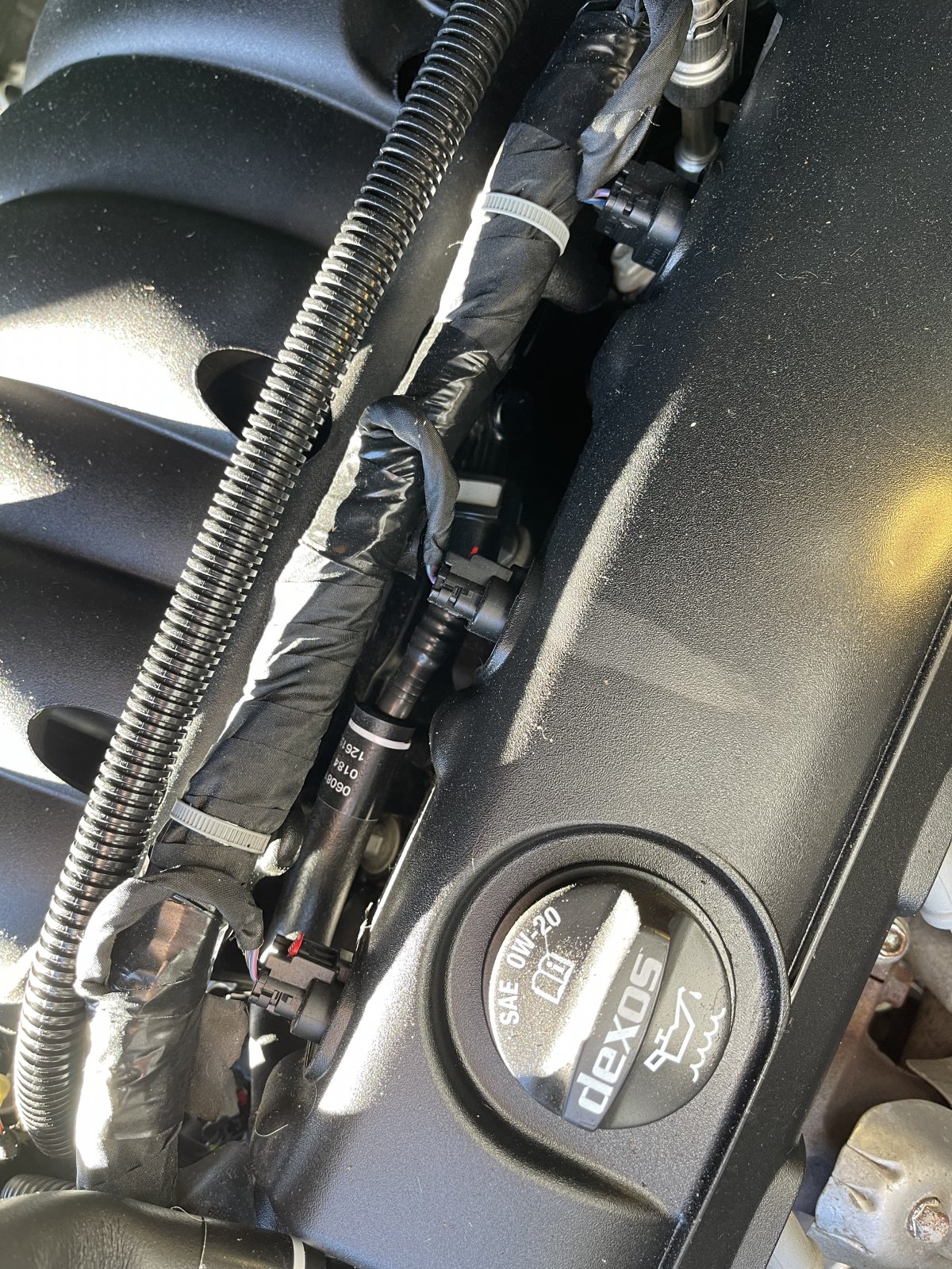

Mine looks a little different due to some sort of bunch of cables running through.

That is the hose, the picture had the cabling on top of it removed. That side of the hose id to remain on. You need to follow the hose to the front of the engine and remove it there. You leave the side on pointed to by the red arrow. Then spray in the hose. You will need to take off the air box in front of the throttle body to get to the other end. Look at catch can installs to see how to get to it.
