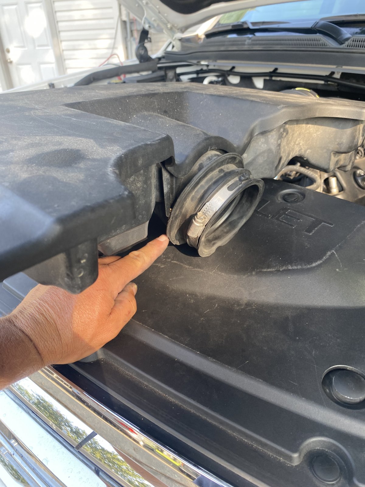

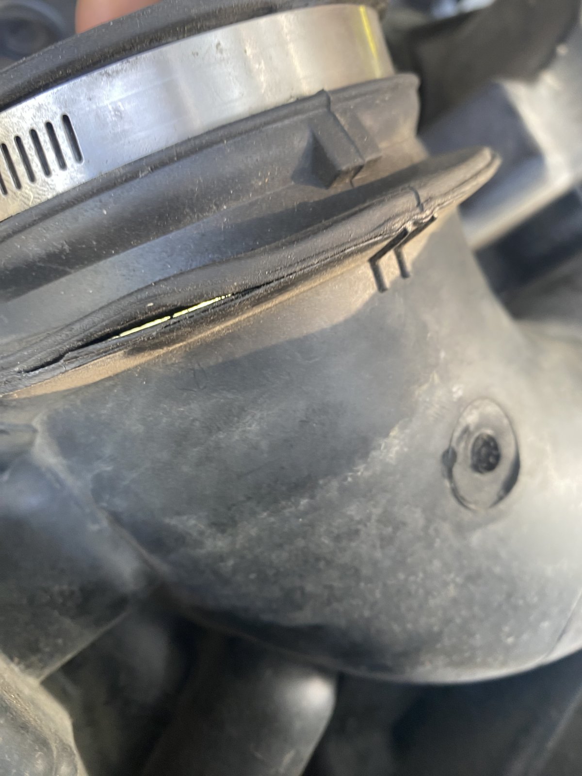

I finally made it to my friends house for smoke test. Found the boot leaking from duct to throttle body on bottom. I put a flashlight light in it and could see light. I’ve located the OEM duct. Seems there is one with the same exact part number for $186 and one with a new part number for $233. I’m leaning towards the new part number in the hopes of it being updated to fix the deterioration on boot.‍♂️

So I bought the newer part number duct. It’s the same as the old. Still has original part number on the new duct. Anyway it did NOT smooth out my rough idle. Amazing that much of an air leak 3” in front of throttle body doesn’t effect the rough idle. So on to changing motor mounts. May be a few weeks before I get to it, but my offseason is around the corner and I expect to be working on my wagon a lot soon.
