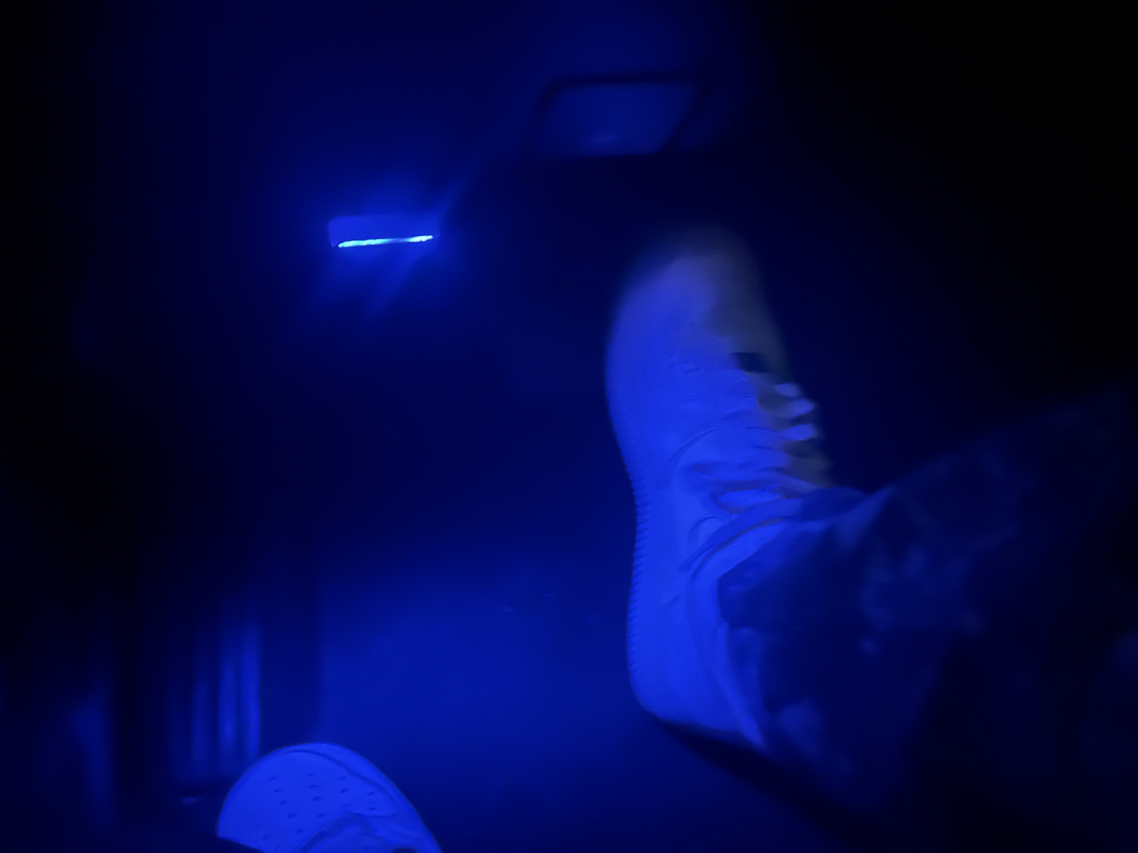

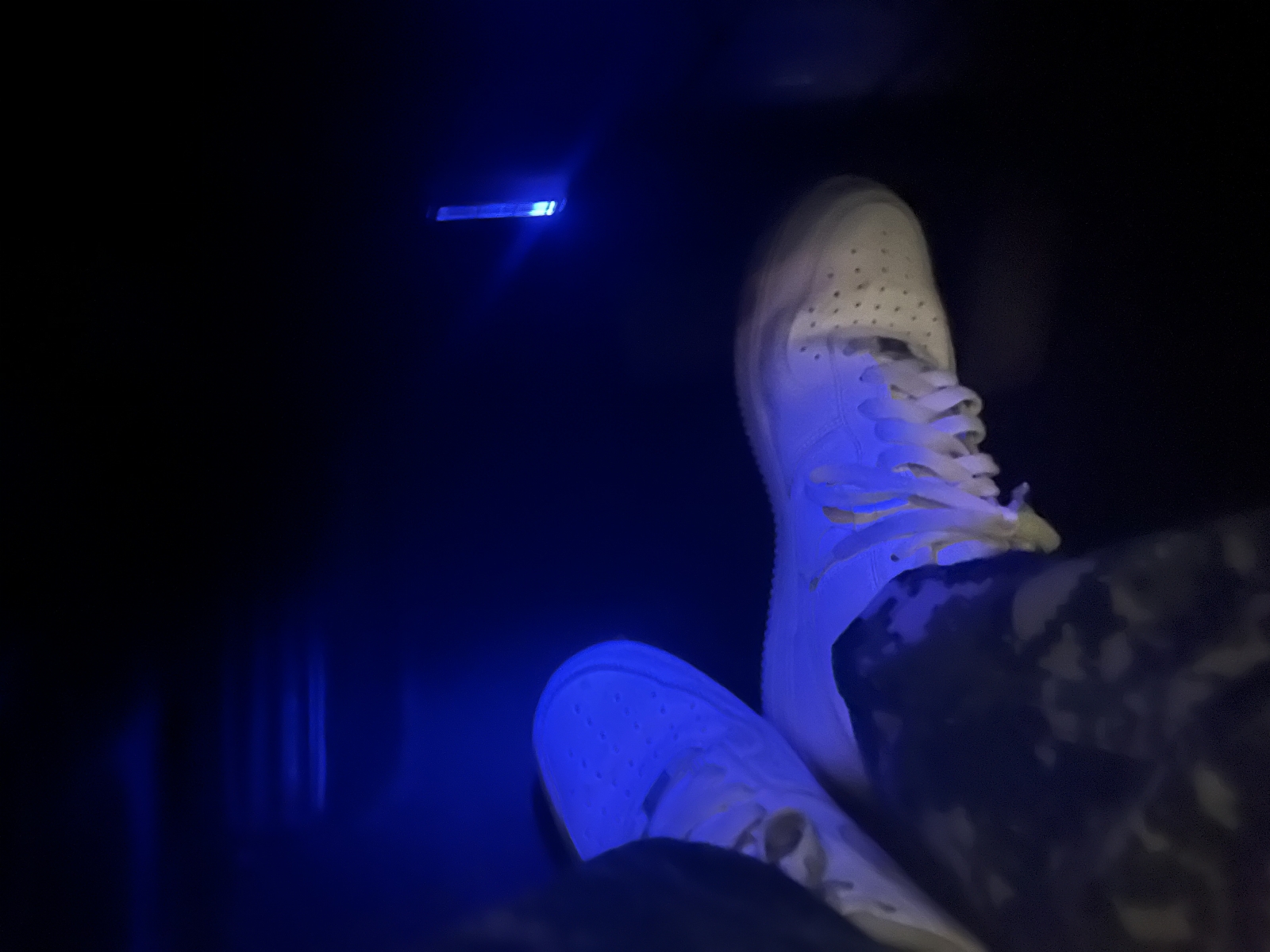

That’s what I was wondering. Everyone seems to think it does,
it doesn’t. The range unit has led’s that light up when it’s ‘working’ . . .
When at idle in park, in drive w/foot on brake, or during deceleration, the Led’s fade dim ie: afm disable is NOT in effect. It’s barely noticeable unless it’s night at you’re somewhere with no light.
it has been documented by some here that no aftermarket solution other than a mechanical DOD delete + pcm tune eliminates AFM at all times — same could be said for DFM though i have no hands on experience with DFM disable .
My truck had brand new plugs and wires, and everything else was tip top shape and consistently i still had a bit of a rough idle.
