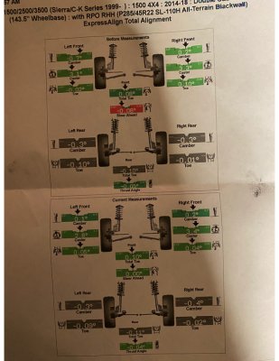

Has anyone else had trouble with their truck pulling right no matter what? I have a 2017 GMC Sierra 1500 Denali that pulls slightly right even after:
1. multiple alignments.
2. no crash history, nothing bent.
3. right castor set to 0.8 degrees higher than left.
4. new tires.
5. tire rotations.
6. no sticky brakes.
7. no bad wheel bearings.
8. 0.04 degree thrust angle.
I am at a loss as to what to do next. The service manager at GMC says it's fine, but I have never had this problem with a truck that I have ever owned.

The RF caster lead you have should be sufficient to offset the crown on the road and keep from the slight pull right. You can go higher, to a point, before you would get the dreaded caster shimmy. I would set the RF caster higher and see if pull goes away and hope you don't get the caster shimmy. You may also have a problem with the steering gear box internally causing this.
Can you please post a pic of the alignment print out of the before and after readings. I do better when I see them. Thanks.

I will post the picture of the full specs, but the RF castor is at 3.4 and the LF is at 2.6 I believe.
I get that but I need to see the printout for the spec and you can still do more caster lead, to a point. You asked for help and I am trying but I need the print out info.
You may also have a ball joint problem. The best way to check them is to put jack stands under the lower control arms close to the lower ball joint and lower the weight down to unload the ball joints. Then remove the outer tie rod and grab tire at 3 and 9 and turn them left and right to check for any binding.
You said, no sticky brakes and no bad wheel bearings. How were they tested? Does the slight pull happen at all speeds? Coasting? Accelerating? Just maintaining speed?

Sorry, I just got home to take a picture of it.
