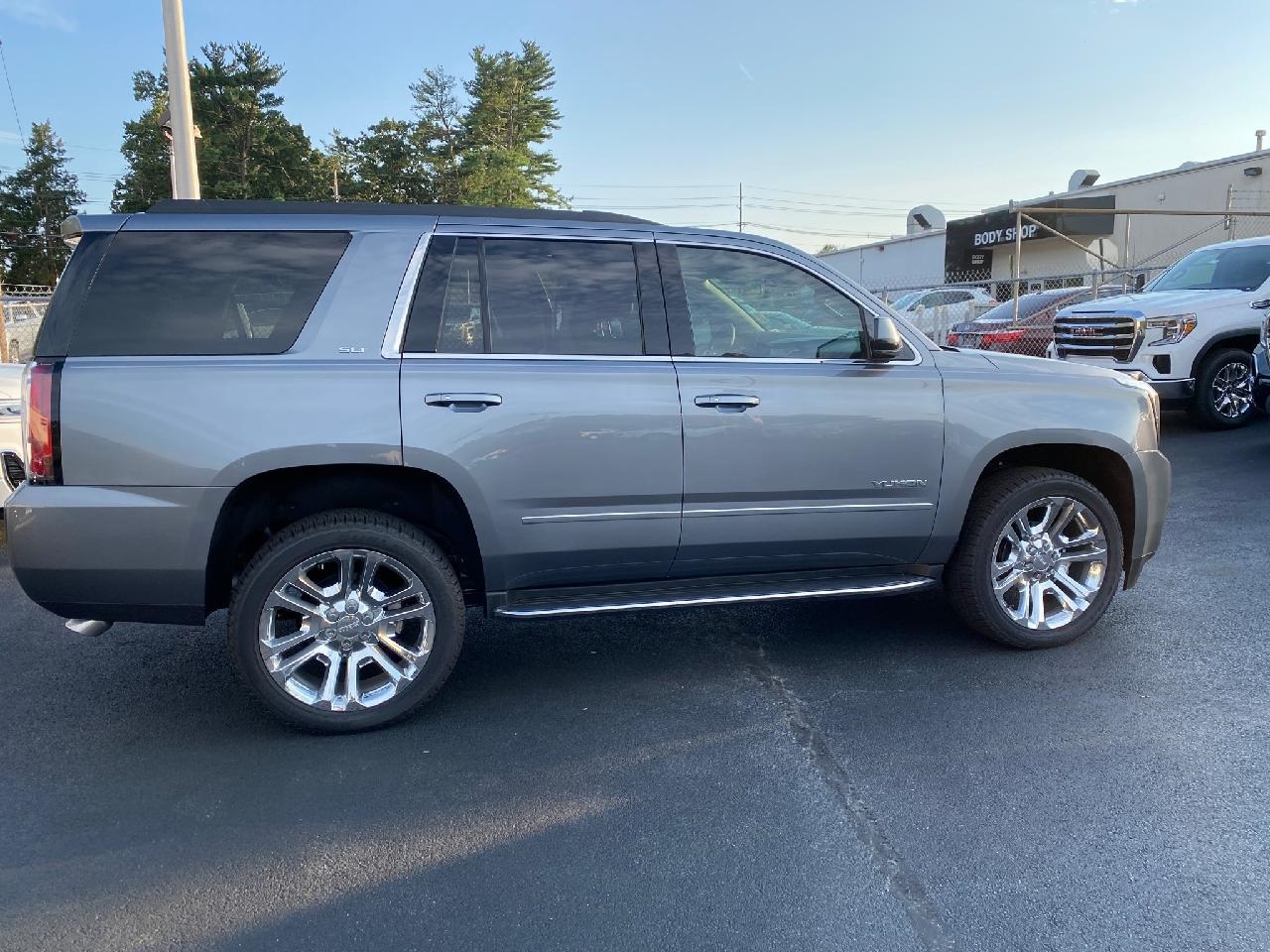

Wife's 2016 Yukon Xl 4x4 began shuddering on the highway Thursday night. She was 2 hours from home. Was able to limp to a nearby GM dealer and I drove the 4 hour round trip to rescue her. :mad: The service advisor called us yesterday morning and explained that they pulled the plug (maybe pan) and that there was a large amount of metal shavings in the fluid. They are recommending a complete transmission replacement to the tune of $4,900! Only 80K on the clock and she is diligent about keeping up with service requirements. Merry :favorites68: Christmas. 2020 just keeps on giving. Interestingly, our previous 2011 had the same exact issue at a bit over 100K. I've owned 7 Tahoes/Yukons since 1997 and all but these last two have been fantastic and have never had issues such as these. I reached out to a trusted person in the transmission field and they told me that the transmissions in my wife's vehicle has known issues. Apparently the torque converter is the culprit. Has anyone else experienced this unfortunate issue?
Here is another thing that begs to question.... So the warranty when brand new is 60K miles. This rebuild/remanufactured unit that they are suggesting we install carries a 100K mile warranty. Maybe someone can explain that one to me.
2016 2wd failed at 94k miles. No shutter just nothing past 2nd. Converter had sent trash through the trans. Had it rebuild by TK performance and run a PATC billet converter and have 0 issues at this point. Im only at 111k now but its holding up well.
