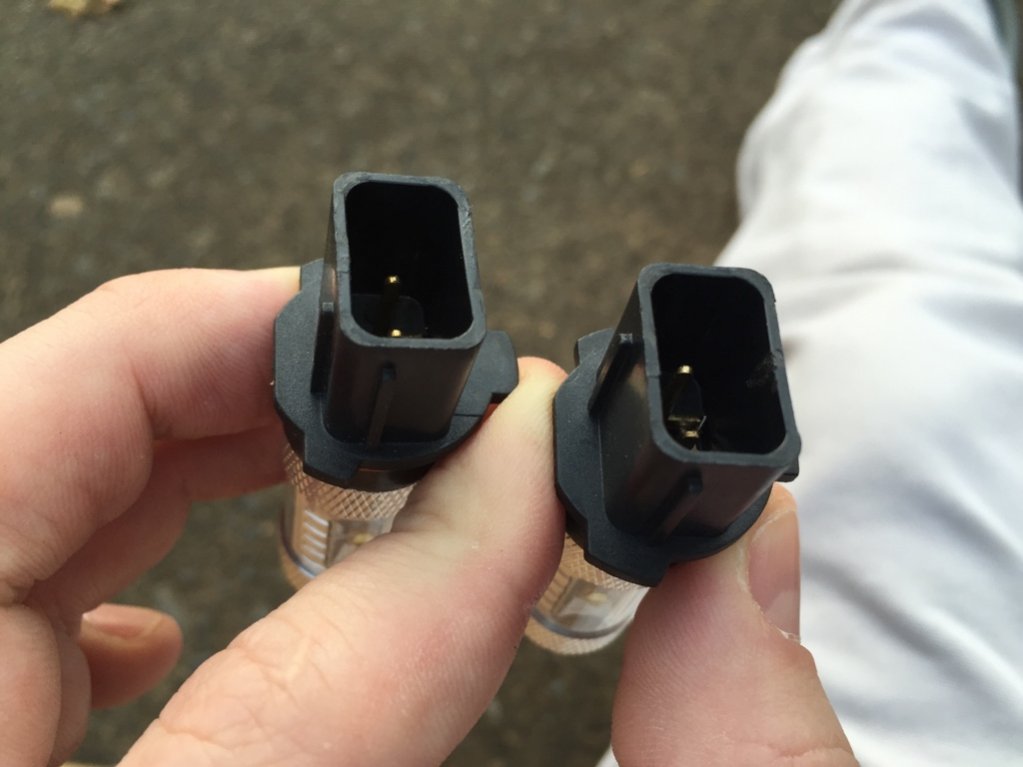

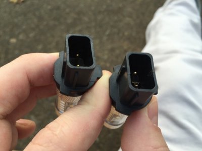

ImageUploadedByTapatalk1417024898.293501.jpg Screw you too Amazon.
jenielsen
Oct 11, 2010
59
I see it now. It's the placement of the small "keystone" on the left side...
One is down at the bottom left, other is at the middle/top left
Edit - Personally, I don't think it's Amazon's fault as they don't package them up. The manufacturer is the one who packaged them and sent them to Amazon.
Good is with Prime, they will take them back with no issues.

You're right, it's not at all Amazon's fault. I was just venting a little. :) Anyway, the return is in the works and the new one will be here Monday.
