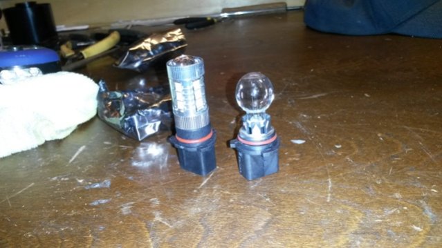

Well, I wish I would have read this before I ordered.
Reverse bulbs went in with 10 minutes of work.
After getting to the fogs, I found out what you guys have already discovered.
Lucky me though, they fit right in to my Silverado fogs..
I did need to grease the O rings though. Both sides were bulging and not snapping in together. A little dielectric grease on the O rings helped them fit.

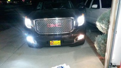

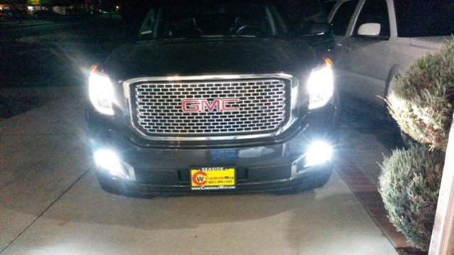

Just installed LED fogs for my new 2015i Denali. Ordered PSX26W 1200 lumens from wholecellurusa for about 28 bucks a pair. Installed them and no issues so far. What a big difference. They are so much brighter than stock.
I ordered the backup and license LED lights. Hope to have them installed this weekend. This thread has help so much!!

Wow that looks bright! Is it much "bluer" than the hids?
They are very bright compare to stock. It matches stock HID... IF anything they look a tad whiter. The color was rated at 6000k. Very happy with them.

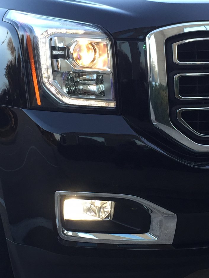

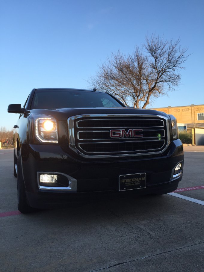

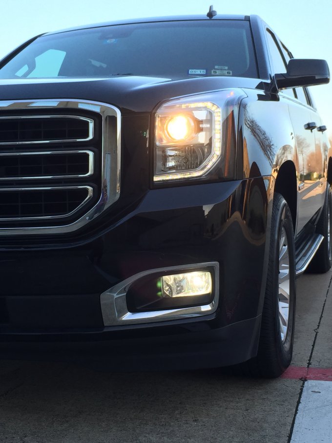

JPH, I Installed the LED fog light bulb yesterday on my SLT and here are a few pics. It looks very similar to the DRL LED. I'm going to replace the Halogens with HID soon.
I got my LED bulb from Xenondepot.com and I got the 5000K
http://www.xenondepot.com/5202-led-bulb-cree-p/xd-5202-led.htm
