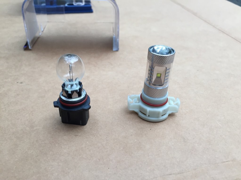

Can't seem to get the LED bulb to go in. Does it just require one to be extra firm? Anyway, the bulbs look similar but not the same. Here's a picture. ImageUploadedByTapatalk1416528195.681383.jpg
Any help would be appreciated.

The original bulb secures by inserting and screwing in. The replacement bulb lacks the tabs necessary to do that.

Whoa...that's not the same! Looks like they changed the bulbs for the 2015is. Can anyone else with an i confirm they used these?
Our 2015s (early) had 2 push clips on either side. No twist tabs. That's a different bulb! Sorry :(
At least amazon returns are a snap. You just need to figure out what number bulb that is and get the led version of it.
Makes me wonder what else is different....
Unannounced changes are painted roof antenna and now different fog lights (that I know of)

Oh good. It's a different bulb, I'm not just inept! I have no idea how to go about identifying the bulb type.
I'll start the Amazon return process now.
---------- Post added at 04:42 PM ---------- Previous post was at 04:26 PM ----------
Okay, the 2015i takes the psx26w type of bulb.
