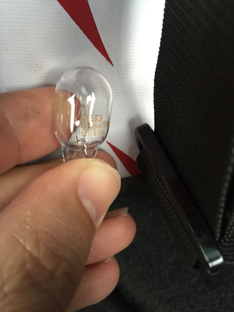

To confirm, for a 2015i Tahoe LTZ, it is the psx26w for the foglights.
Reverse lights appear to be a 921.

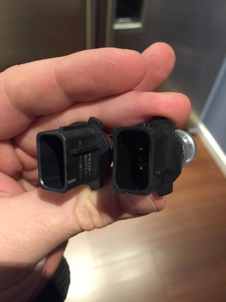

Hey guys! So I recently purchased a 2016 GMC Yukon SLE, and I already upgraded the reverse, and license plate bulbs to 6000k LEDs and its definitely a big difference! The only thing i am having an issue with currently is with the fog lights. I am an amazon supporter as you guys call yourselves lol and the one that says fits doesn't fit. My current bulbs fog light bulbs have to be twisted to be removed, but the ones that came in are like the ones you guys post here that the base is a clamp on. are the 2015 fog lights different from the 2016, or how did you guys install those? i am so confused! and I have tried searching on vleds.com for fog lights, and for some reason can't see the model of the fog light bulb that works. any help would definetly be appreciated! Tomorrow I will be upgrading the low beam headlights to 6000k HID, im excited hahaha.

Early 15' use 5202 or H16 bulb late 15 and 16 use PSX26W
You need PSX26W https://www.amazon.com/PSX26W-Power...t Foglight Bulb for Car**&tag=viglink20600-20
That one will be 6000k with little bit more blue. You have to trim one of ears about 3mm. You will see if you put side by side. When installing it push harder that led into fog light housing. Btw i didnt have to remove anything to get to fog light bulbs. Just lay down in front of vehicle and put hand from behing bumper up high, and you will find connector, disconnect it and twist bulb counter clockwise

My suggestion is taken the bulb out and is very easy to see exactly what you want.

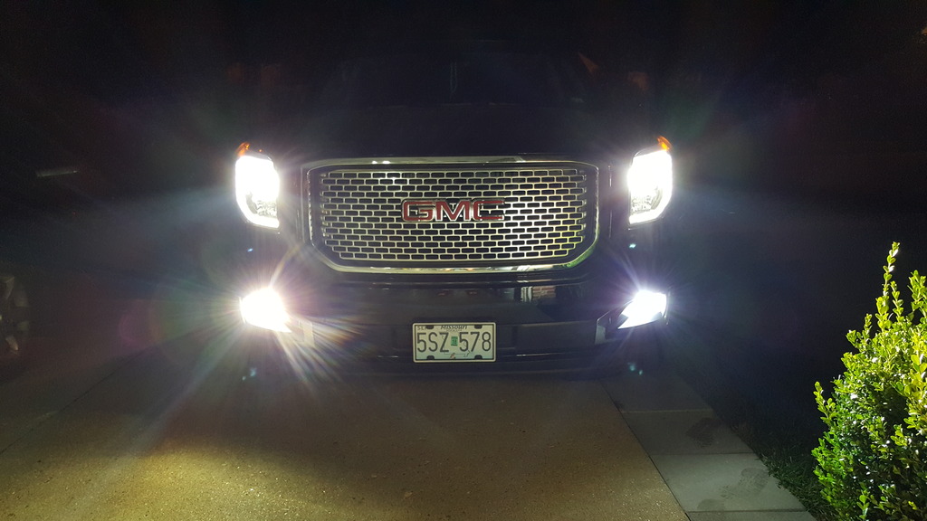

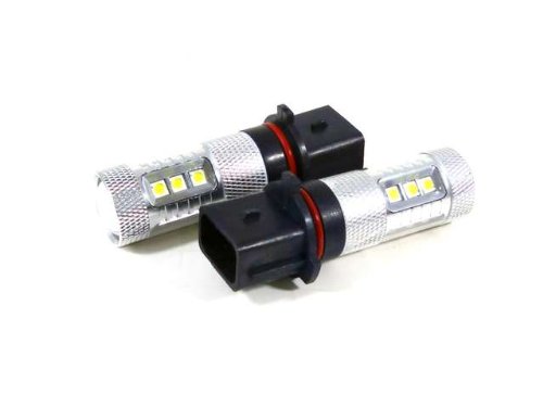

I just got PSX26W in 5000k from http://www.xenondepot.com/PSX26W-LED-bulb-cree-p/xd-psx26w-led.htm and they are white. Compared to Uxcell PSX26W from amazon they are much brighter and better match to the D3S and led DRL
And these leds from Xenon depot are real PSX26W bulbs, one from Uxcell are P13W
Here is some pics
Xenon Depot 5000k on passenger side, Uxcell 6000k on driver side
