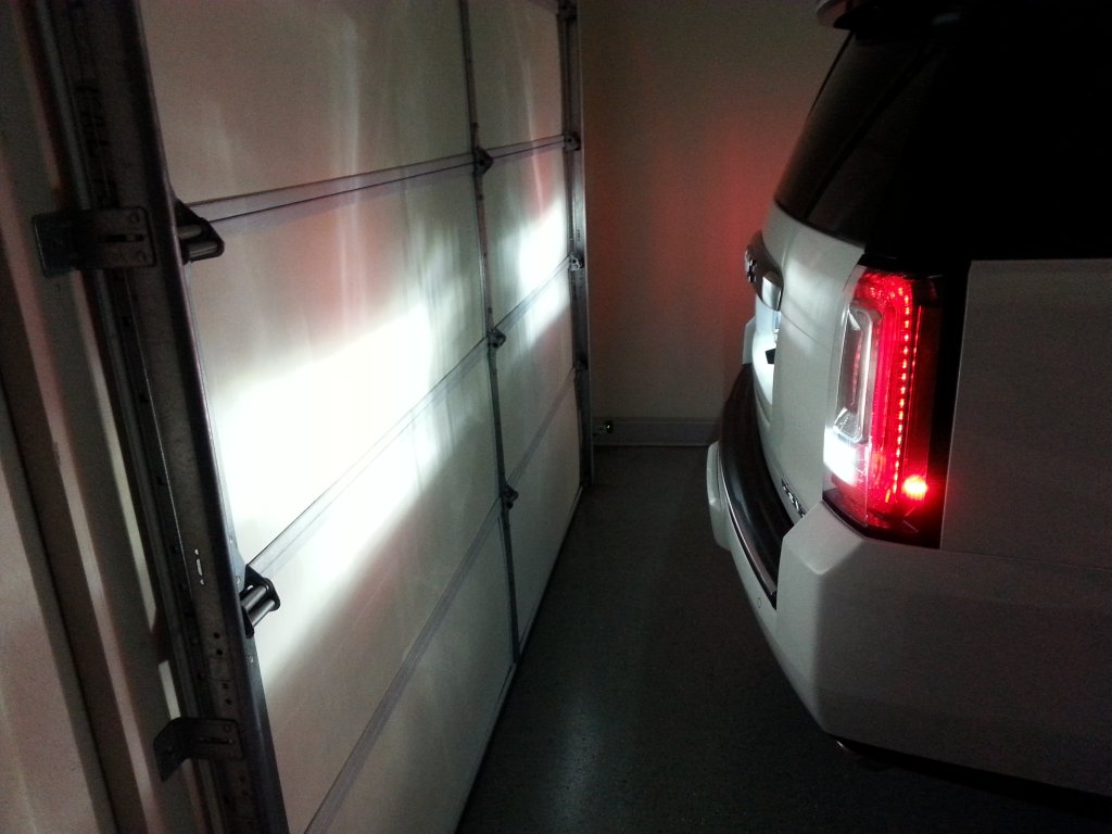

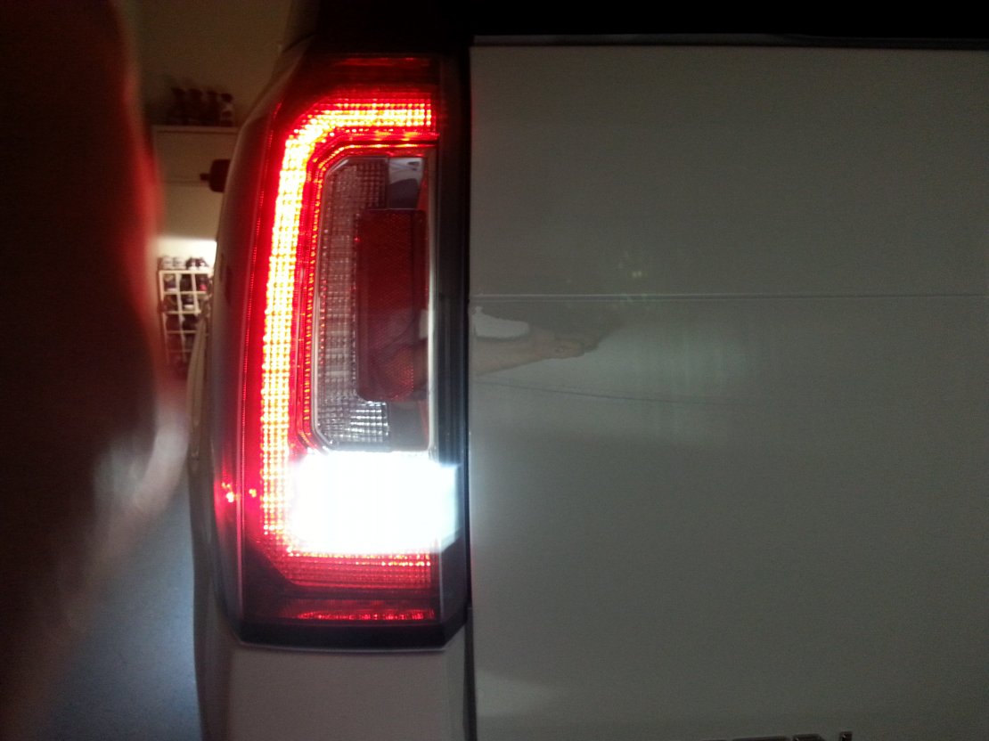

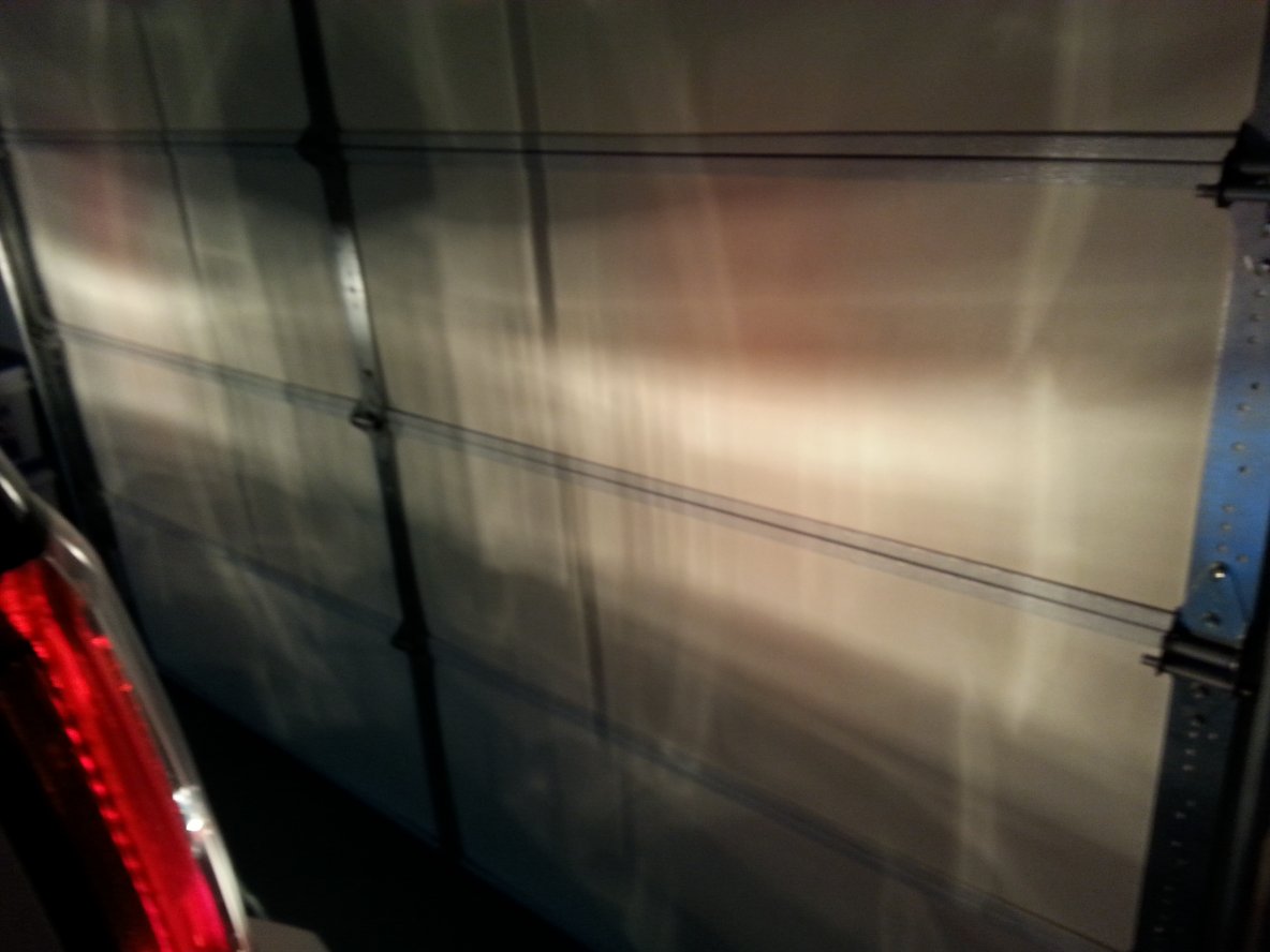

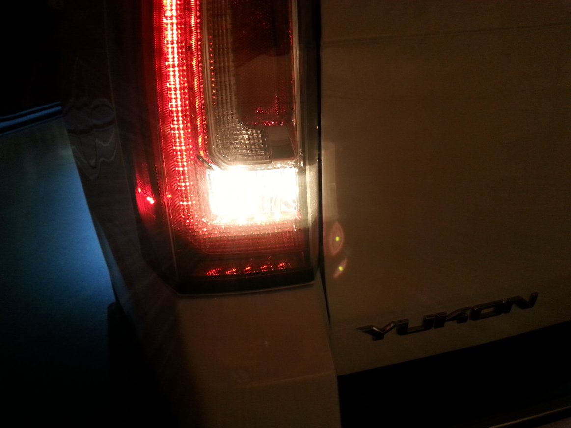

Philips led > OE 921 by far.
Perfect match to Sylvania led 194 plate lights.
Before and after pics.

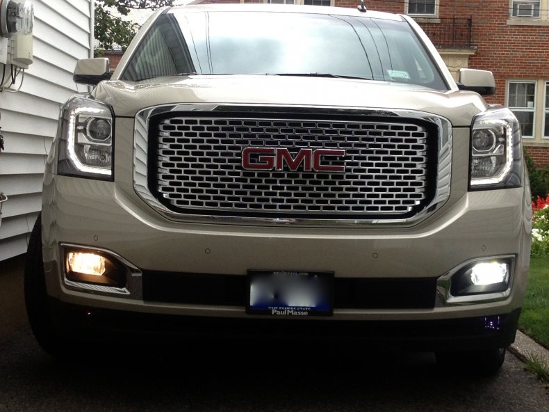

Couple more pics after LED fogs:
