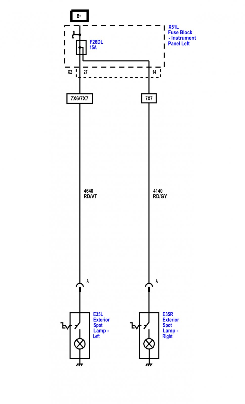

Does anybody know where the fuse is located for the spot lamp on a 2015 Tahoe ppv. I tried checking the GMupfitters manual and it doesn’t give a location/slot. Been trying to figure it out for a while now, can’t find anything online.
PPV2004
Nov 26, 2022
15
15
Fuse 26 15amp on the left instrument panel fuse block

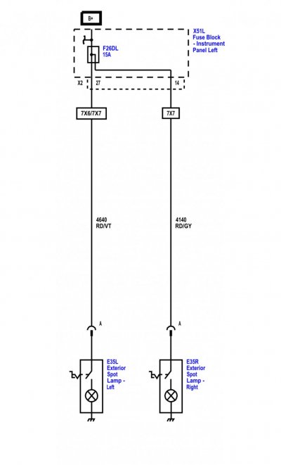

Mine is in line below the light in the column, about 3" down the wire. Bus fuse.
