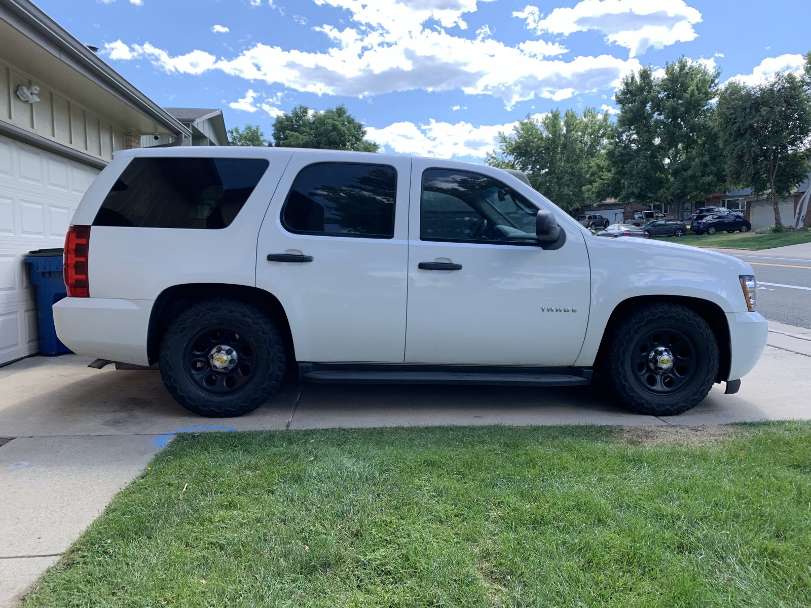

I’ve got stock size ko2’s 265/70/17 with a 2/3 drop and they rubbed in the back going in and out of our driveway (slightly elevated from the street). It took some heating and manipulating of the liners but now it doesn’t rub at all. I couldn’t tell you how close it is but if you look at the rear fender liners you can see where there’s just a sharp angle to them at the corners and that’s what needed warming up.
