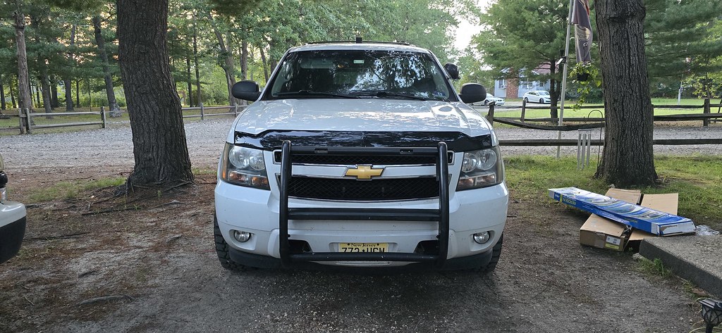

Hey yall! Long time lurker. Picked up my 2014 SSV a little over a year ago. Its my second Tahoe, the first being a 2005 LT. I loved that truck so much, I knew I wanted another. I always loved the look of the GMT900 Tahoe's and decided to pull the trigger on one. I was originally looking for an LT or LTZ, but I found this SSV with less than 120k miles and ended up picking it up for $7300. Having worked as an upfitter and building emergency vehicles for about 5 years, I wasn't too afraid of any electrical and/or wiring issues I might come across.
So here it is:
And the day I picked it up:
Having built quite a lot of emergency vehicles, it didn't take me long to find and powerup the lights that were left in the vehicle. ;)

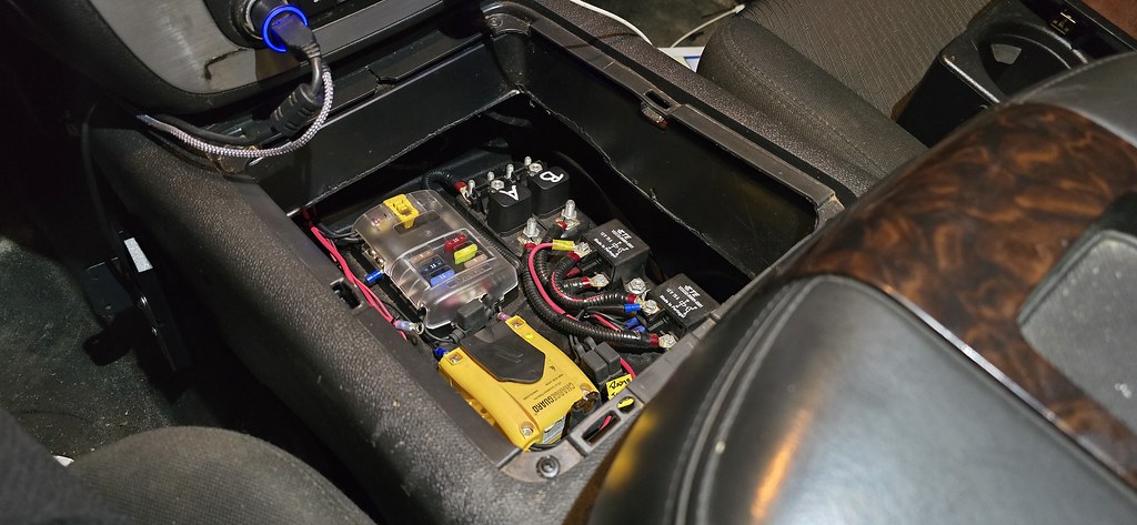

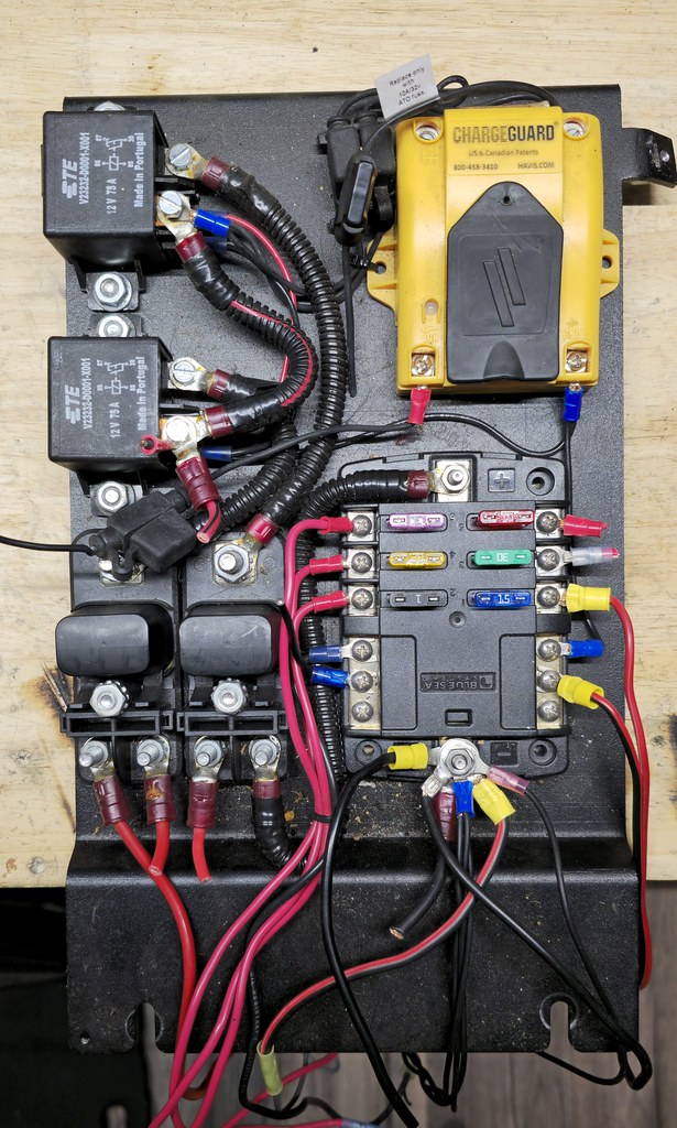

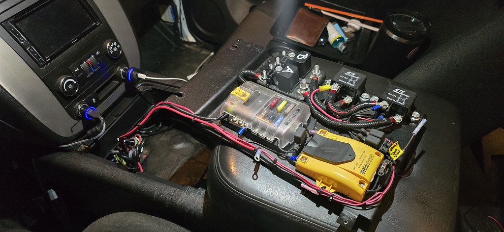

Did a bit of bench wiring today. I've, slowly but surely, been pieceing the wiring back together since replacing the Havis console with the civvy one. As well as getting a plan laid out for the updated wiring, lighting, and switch panel setup. I'll be using a lot of stuff I have laying around from past builds. Thankfully I've hoarded quite a bit of emergency vehicle stuff. Here are some things I've been up to:
Got a sweet deal on a bug deflector. Why repaint the hood because of rock chips when you can just cover them up?! :anitoof:
Here is some of the wiring I've been redoing. First photo is before I cleaned it up.
I quite liked the power setup they had originally so I'll be reusing it (this stuff ain't cheap!). That Charge Guard is an awesome feature, though. Basically it keeps those fuse blocks powered up for either; A) a set amount of time after the vehicle has been turned off, or B) until it detects battery voltage hit 11.0v. They would have used it to keep sirens and radios powered up after the vehicle was turned off. Both of which I'd like to add down the road.
As you can also see, I cut up the console a bit to drop the spaghetti board in the civilian console. Not sure how I'm going to secure it just yet, but I'm going to make sure to leave a good sized service loop on the wiring so I can pull it out to work on it. A much needed QOL feature.
Some other bench work I was doing today:

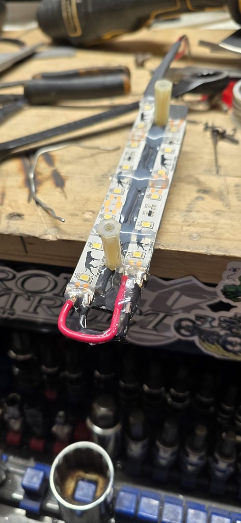

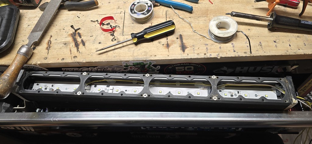

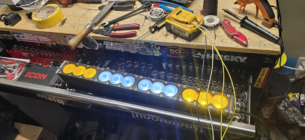

Rewired the light bar I had so I can controll the left and right Amber lights individually so I can tie them into the headlight flasher. Replaced all the cheap Chinese wiring and resealed it up as well.

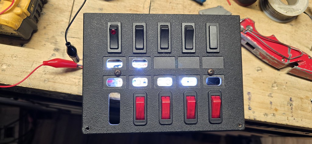

Also worked on the switch panel I'll be using. I was going to buy a new one that would have looked a little nicer, but this was free so I'm not going to do that. :cool:
It also had an illuminated panel for the switch indicators but it was really old and used incadecant bulbs. Used some existing hardware and LED strips I had laying around to make 'er gooder. Found some new stickers to stick in there too that'll be on the way soon.

We got another electrical tinkering wizard inhere now, nice!
Far from a wizard but I finagle ;)

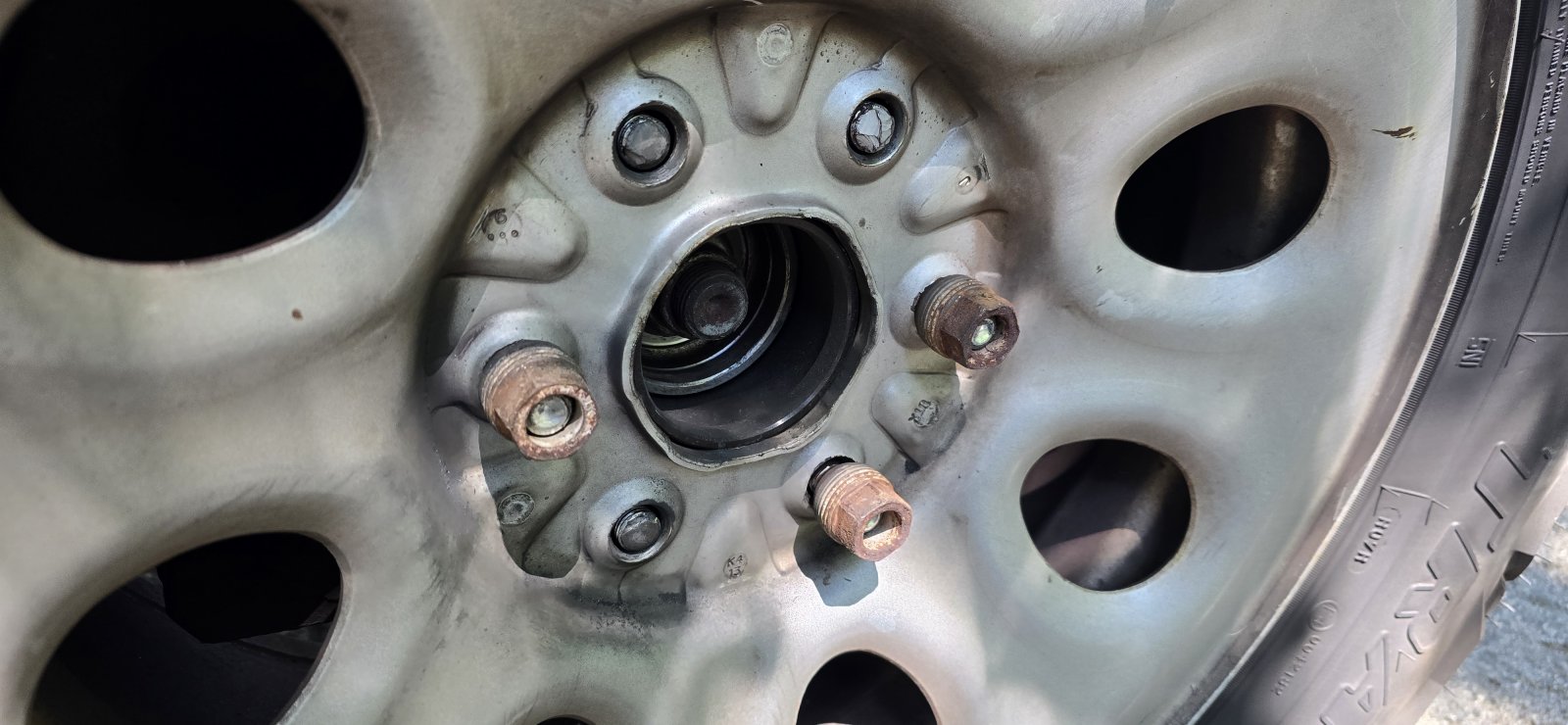

Well I was hoping the vibration I suddenly felt in the wheel on the highway was due to losing a wheel weight. Unfortunately, it was not. I've used wheel spacers for years and I've never had this happen. Guess I'll have to add new wheels to the list.

Do the wheel spacers have that recessed ring through all the lugs like the hub face? And did you run steelies on your other wheel spacers?
Could the lugnuts have just bottomed out leaving the wheel undertorqued? idk why, but the lugnuts on my steelies get chewed up on the taper, which doesn't happen on the alloy wheels..
You know, I'm pretty sure they don't have a raised section like you described, thats something I didn't consider. But the brake rotor is flat behind the wheel isn't it?
I wonder if they make anything for that like they do hub centric rings. I've never ran spacers with steelies admittedly, but with factory alloys plenty of times.
I don't think they bottomed out on anything. The wheel was definitely secure and lugs tight. You might be on to something with the raised sections though.
