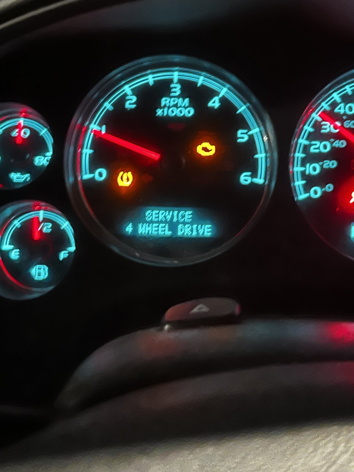

This is a pic last night when randomly the 4wd light came on. The service engine and other lights were coming on at random but as of last night service engine staying on. The tire monitor I’m aware of I need a pressure sensor in one of my tires but the other lights flashing at random are my concern

ding ding!! @intheburbs is right!! you have a ground problem. i bet 1 or both grounds on the back of the engine to the firewall and frame are bad or broken. i intended to put a big system in the truck , so one of the first things i did was replaced ALL the grounds and cleaned all the grounding points. then i used the super lube to keep them from corroding. i'd say it had the most impact on my system when i did the grounds. i also added a couple i felt were missing. keep us updated plz.

Thank u and @intheburbs so very much. I’m hoping this isn’t as pricey as everything else cuz I’m about to my wits spending all this $. I sure hope they will just replace all that u said cuz I don’t think they were finding it. I just want over and I will for sure keep u updated. I appreciate the help so much.

@ahulsey I think that could be a possibility, but also someone could have just left something loose when doing your lifters. The heads need to come off and both heads have a ground on them.
There is one on the driver side that connects to the firewall with a braided metal cable and there is one on the passenger side that is a thick black cable that connects to the negative battery terminal. Might be worth inspecting them.

There are actually 2 on the front of the passengers side head. Large one and a small one. In my experience the braided ones usually fail first but def check them all along with the connections at the actual battery. Yes a motor mount can cause the ground wire to fail if the engine is moving too much. As for your multiple lifter failures. Did they replace the VLOM at the time of lifter replacement? Good news is #5 isn't an active lifter. I would look into a plug, coil or even a wire. I cant say I have seen an injector go bad on one of these but anything is possible. I had a service 4x4 light on a silverado not long ago. The front actuator had no ground. Under the driver side front door about midway are a few grounds screwed right to the body mount bracket on the frame. Check those out. If it were me I would change the eyelets and clean the frame where they mate. Best if you had a scan tool to see exactly what the code is but these are common issues I see.

Update- just picked it back up at shop and he said he went thru every wire and found that someone had put the fuel injector wires mixed up and they were kinda torn or something like this. Don’t quote my words on it all but I’ve now drove 3 miles and no lights have popped up as of yet thank u all sooo very much! U truly helped ease my mind and whether me telling them or not but because of y’all I stayed adoment about them checking wires and this was found. So hopefully my problem is fixed.

When an AFM repair is made, the lifter trays and VLOM MUST be replaced, it is standard operating procedure. It is the solenoids in the VLOM that get tired, firing out of time, which damages and destroys the lifters the majority of the time when it comes to AFM failures. Anyone not replacing the VLOM is not following the book.
All those electrical gremlins were not because of the old battery or alternator, it's likely a ground strap issue on the engine since they had to disconnect them to do the AFM work. If they had used their bi-directional scan tool, it would have alluded to this in seconds. They're either lazy, incompetent or dishonest.
On rare occasions, the BCM gets damaged and causes shorts like this from the battery not being disconnected/connected properly. Always pull the negative cable first and replace it last. Again, a bi-directional scan tool like the Tech-2 can help to quickly diagnose this. You ought to get one to keep these shysters from emptying your wallet. Even if you lack the time or skills to fix it, a proper diagnosis can keep you from being taken advantage of by those you farm the work out to.

I don't believe that, they discovered that one or more of the grounds was loose and tightened it. If there was something wrong with the injector harness, the motor would not have run right. Anyway, drive it a few more days and give us an update if you don't mind.
