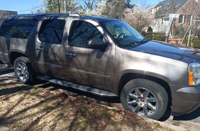

Finally said good bye to the 2008 Tahoe with 5.3L. It stubbornly would not quit, after 267K miles, just kept ticking. Without major repairs. Maybe because I disabled the AFM 100K miles ago.
Anyway. Just got this and what a beast. 2013 Denali XL. Specifically wanted these specs. One-owner, fully garaged all of its life. 175K on the clock, only 40K on the 6.2L engine. The original probably failed due to lifters/camshaft failure. I need to disable the 4-cylinder AFM basically yesterday. Do I need a tuner or is there a shortcut. Does driving it in the "M" mode not engage the 4-cylinder mode and do I need to do something special when putting it in "M" drive mode?
Trying to figure out things, the display device in the center console confuses me. I need a glove box manual for it.
* How to access the settings to permanently turn off dome lights (and headlights from cutting on) when unlocking/opening the door, and then beep when setting the alarm. I pushed the button in (next to the headlight switch), it did not do anything.
* Where can I buy a Factory Service Manual? Paper or a digital one?
* How do I remove the rear seats, the 3rd row and how much might they cost? I will be listing them in the classifieds.
* Is there an extended (oversized) filter for the 6.2L and what grade synthetic oil do I use?

Ebay for the owner's manual, there should be plenty of info on the rear seat removal, do a quick Google search. I would go by the owner's manual for the oil weight as you will probably get several different recommendations which can be confusing. Nice looking rig, enjoy the new ride.

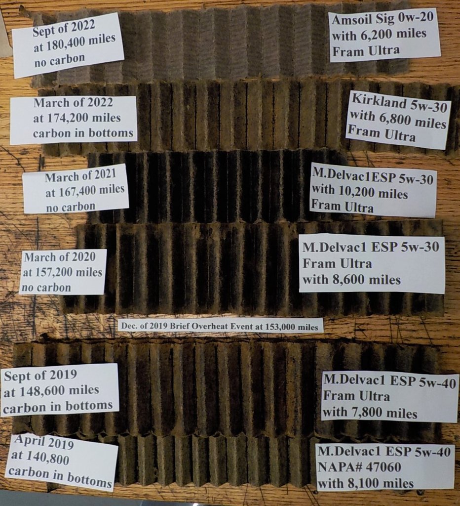

Fram Ultra XG10575 or Fram Titanium FS10575 for our Denali.

It looks as though you went to a diesel oil? (5w-40) I wonder if the different additives did more of a cleaning process.
I like how serious you are on oil changes BTW. Thanks for rhe insight. I go by miles, then oil color on the stick, them color when dropped. After that it's all new and no cares. Some ATF every few changes to wash stuff out in the last 500 to 1k miles before dumping.
Good stuff!

I like experimenting with our 186k mile Denali. It was road hard and hung-up wet before we bought it 4+ yrs and 56k ago. Gen4 LS engines are a dime a dozen around here. If I ruin the 6.2 I would love to put a 4.8 L20 in it. I have no need for all the 6.2 horsepower.
Mobil Delvac 1 ESP is both spark and compression rated, API SM & SN for spark. I bought a lot of it a few yrs ago for <$10/gal.
I don't see any rhyme nor reason for the carbon? I ran M.Delvac1 ESP 4 times. Carbon showed up only 2 times? Carbon also showed up when running the Kirkland 5w30? I don't get it?
ATF DOESN'T have detergent in it.
