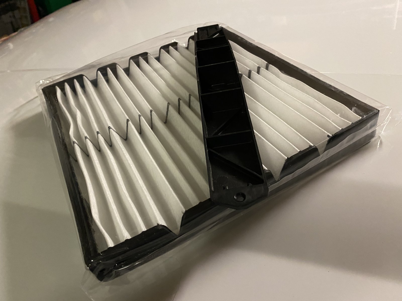

None of the GMT-900 trucks came with a cabin filter from the factory but there is a GM accessory door to add one which Dorman copied. You can get it in RockAuto.

There’s some relatively recent discussion on this forum about adding the filter. Within a couple of months or less IIRC, so search should find it for you. I found it helpful when I added mine. I got the Dorman part from Amazon.
You have to remove the kick plate or plastic cover below the evaporator before you can even view the area to see if it’s installed, or to change the filter. Great Job GM! (NOT)

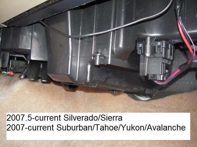

Ron, remove the black flexible plastic cover in the passenger's footwell. There are 3 or 4 screws and you can remove the 2-3 right most screws and leave the one near the console (pain to get out), I think they are 5.5 millimeters, don't remember exactly.
Once that is done, you can look under and see if someone added the filter or not. If they did it will be in the center of this picture, just to the left of the connector for the resistor. Grabbed this photo off of the internet real quick.

Ok, cool. but the VIN or so (or equipment list) doesn't say it does? I doubt someone did it themselves, since it is an SSV
