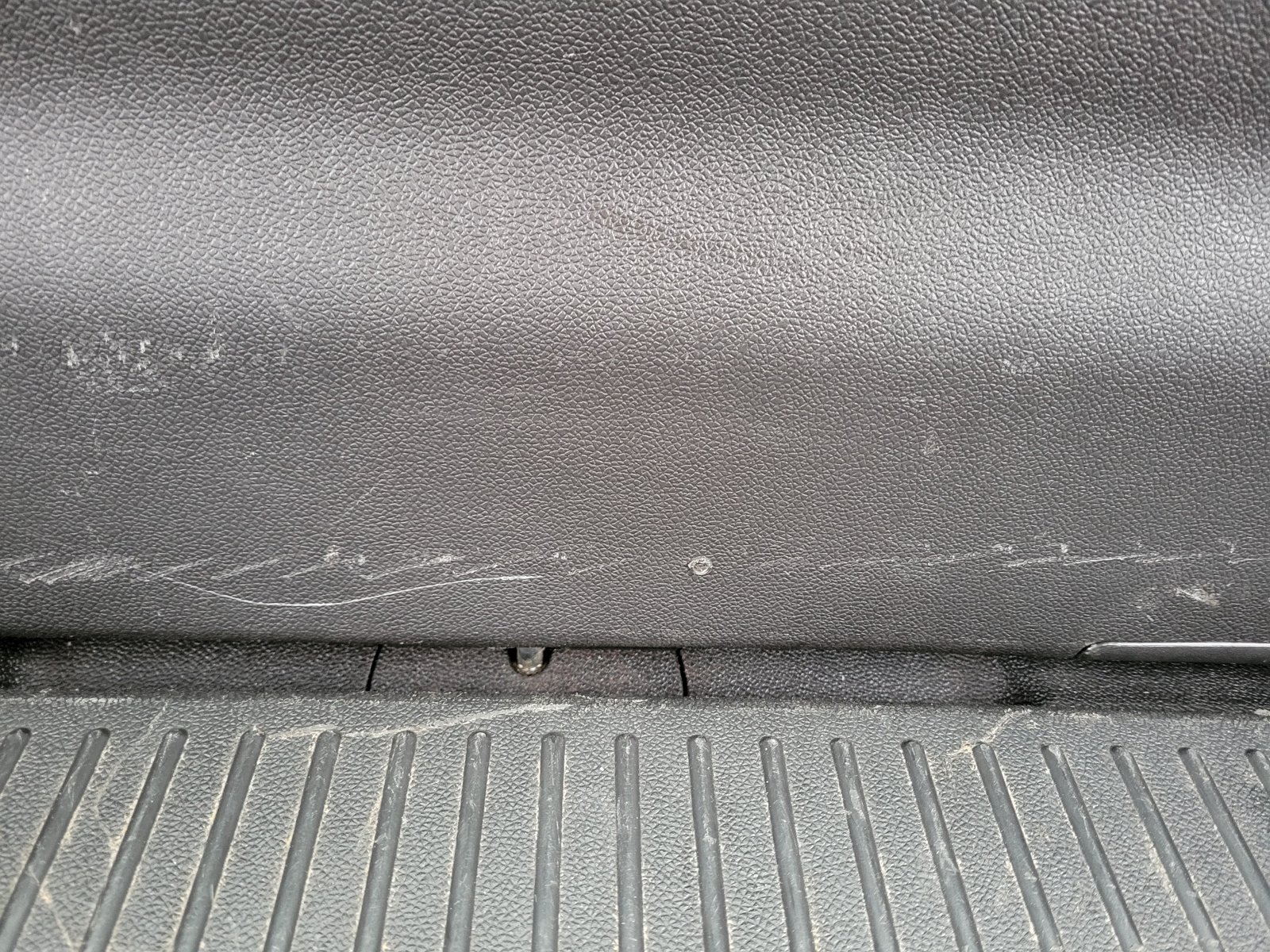

After Googling it, watching some videos and searching here I thought I'd post my experience with a photo.
The videos are mostly non ppv and the dimple in the interior panel is lined up directly over the latch. They show a button you push with a screwdriver after drilling a small hole in the panel.
This forum suggests drilling a large 1 and 1/8 inch hole offset to the right of the latch at the little circle on the panel and poke around until you trip the latch.
I started with an 1/8 inch hole poked around trying to find that button they showed in the video, couldn't hit it. I next drilled a 1/4 inch hole and poked around with a longer screwdriver, even trying to poke directly over the latch but still no dice on this magic button.

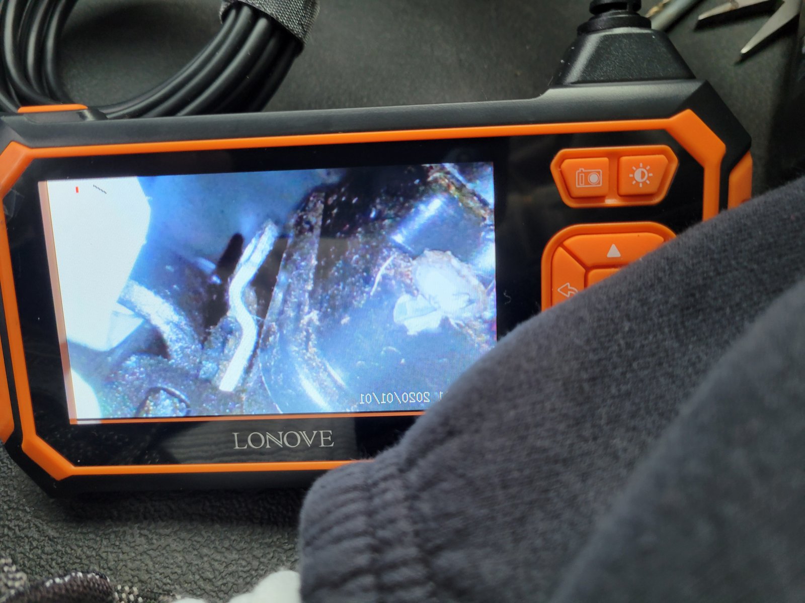

I then drilled a big one inch hole thinking surely this'll give me more room to find it, shining a light in there didn't help see it either. Next step was my inspection camera and I still didn't see this magic button but I did see a silver lever on the side of the latch.
I pushed the lever and it popped the latch, so if anyone else goes through this, you're looking for the SILVER LEVER to push.

I believe I could've gotten away with a 1/4 inch hole if I knew what I was looking for with that silver lever.
