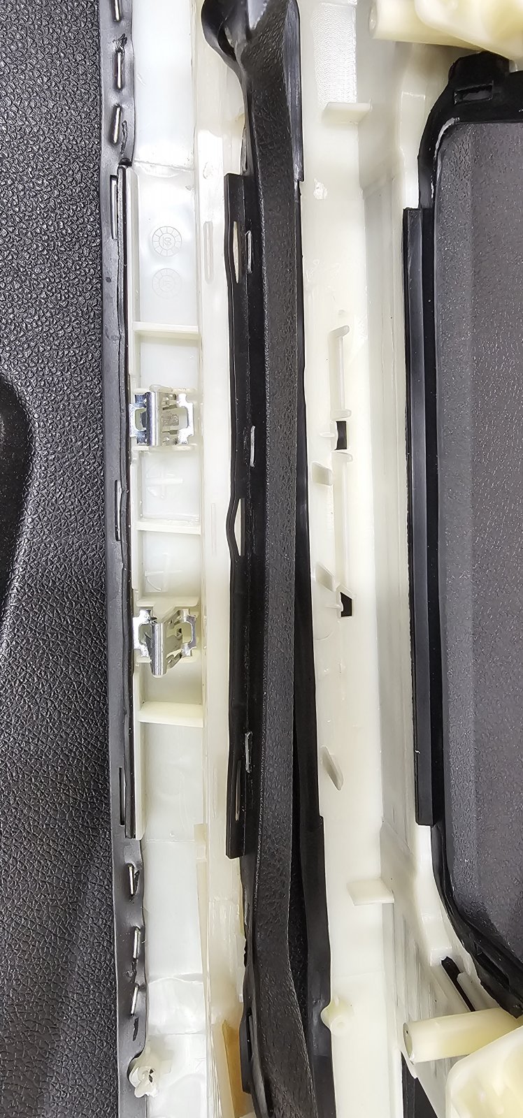

Here are the ones I ordered.
They definitely are better than the broken stock pieces. Apparently there are some with studs in the handle that go through the holes you drill out in the door panel. And some, like the ones I purchased that have screws that screw through the back of the door panel hole into the armrest. The only issue with that is that there's not much room in the arm rest and it's possible you could screw all the way through from the back side.
Also, even though mine physically fit the door panel, there were different versions. My door panel had a metal frame. I believe the ones I purchased were made for the plastic frame door panels. The clips around the pull in the factory one were not there. Here's a pic of the factory one on the left and the replacement I purchased on the right.
I basically had to break off all the tabs so it would fit. I also had to do some dremel work around the window/lock switch for it to fit in.
Overall, I'm glad I got it fixed but I'm not confident that these will last. I've heard the Dorman one was good but they only make it for the driver side.
