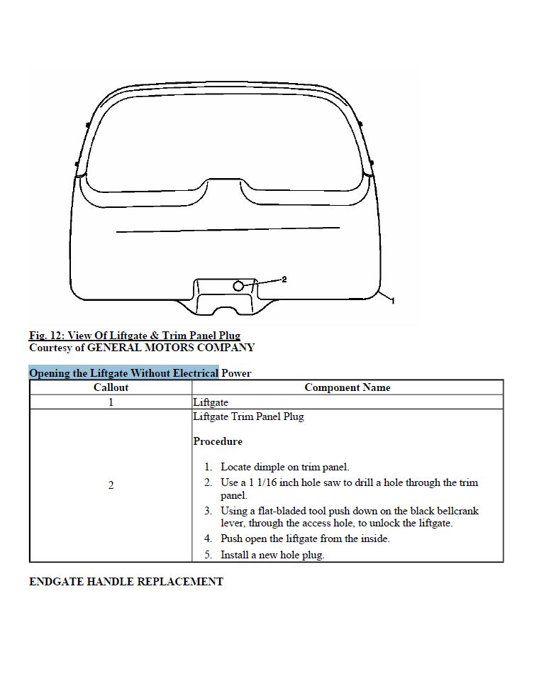

James, could you provide info on the factory plug and where and what size hole to drill for those of us unfamiliar with the instructions from GM. Was this a TSB?
21,315
30,312
20986933 - For Ebony/Black Plug. They also made a tan one.
The mod was technically called the Inoperative Liftgate Modification.

Thanks for posting this. I’ve tried through step 3, but for whatever reason the latch just will not release. I’ve tried pressing up, down, left, right, and nothing works. I’ll keep fooling around with it to see if it’ll finally give.
