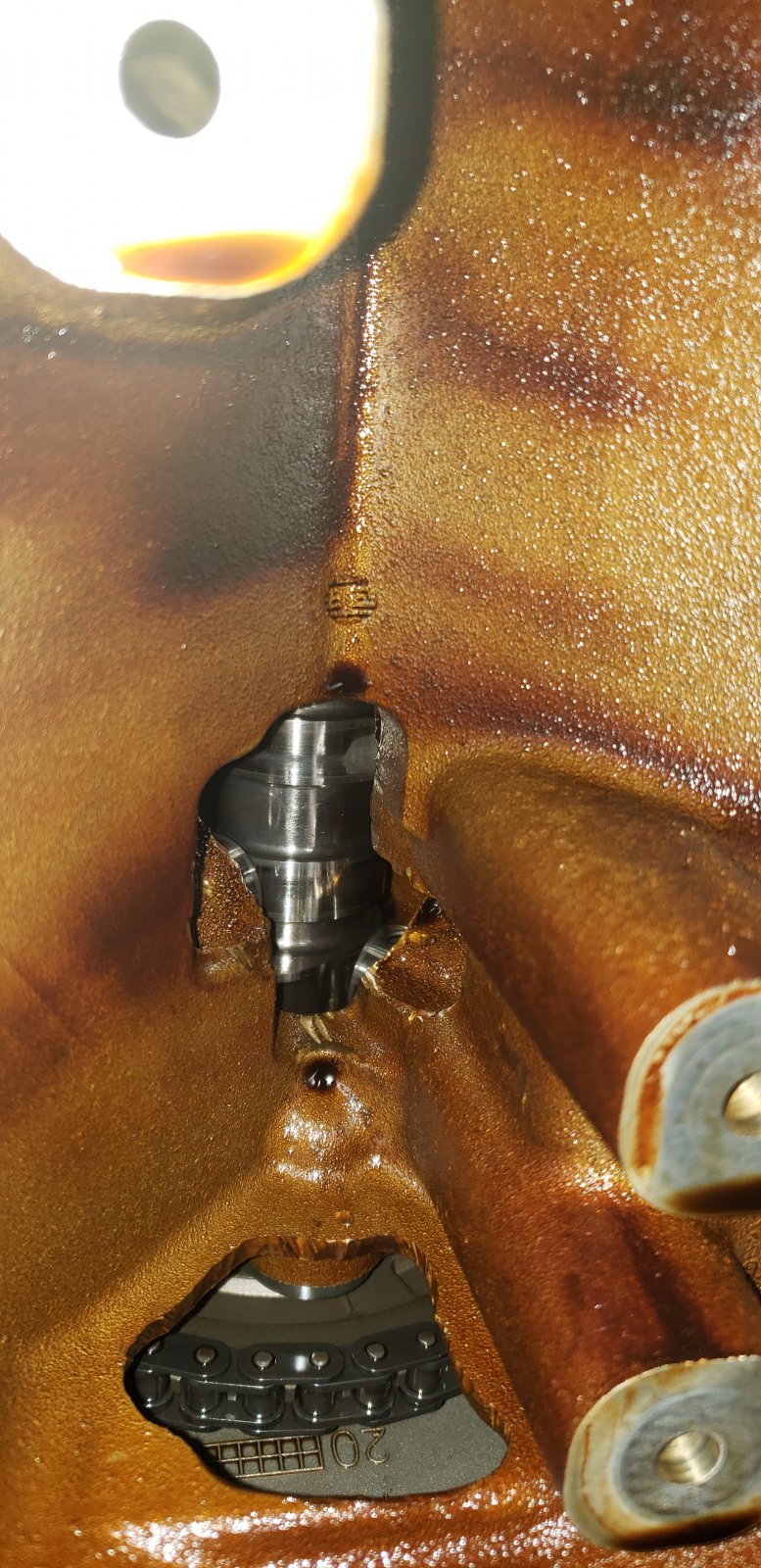

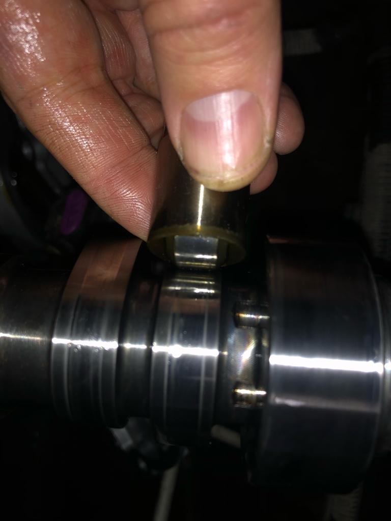

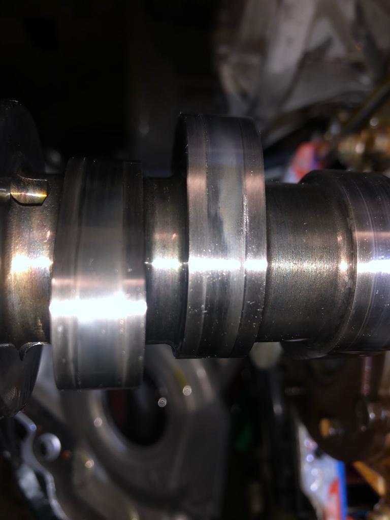

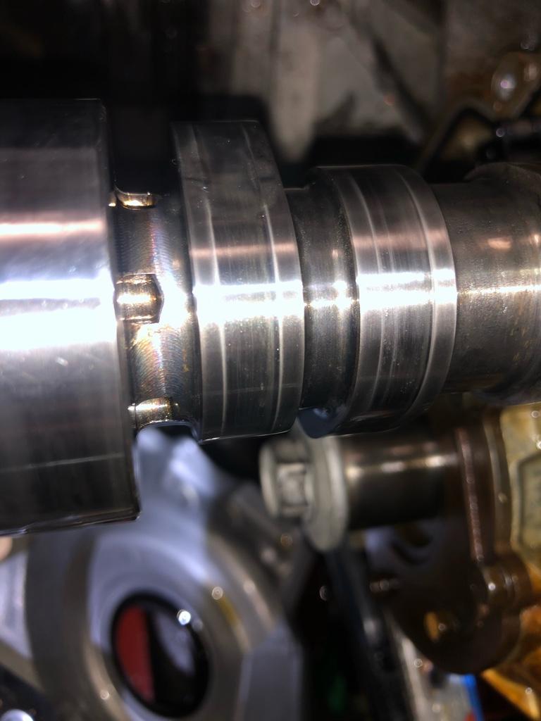

I got the camshaft out today but left the heads on for now. Posting a couple of pictures. All of the lobes have noticeable discoloration tracks on them, but the second lobe from the front, which I believe is the exhaust valve on the #2 cylinder, shows scoring. And the first and second lobe have enough of a track to catch a fingernail. Oddly, the track is actually higher than the area outside of where the lifter travels.
One thing I noticed (before I installed them) is that the rollers on the lifters that came with the camshaft are narrower than the rollers on the factory lifters. Less surface area doesn’t seem like a good thing for this type of application but I’ll hold judgement on that because I don’t know.
