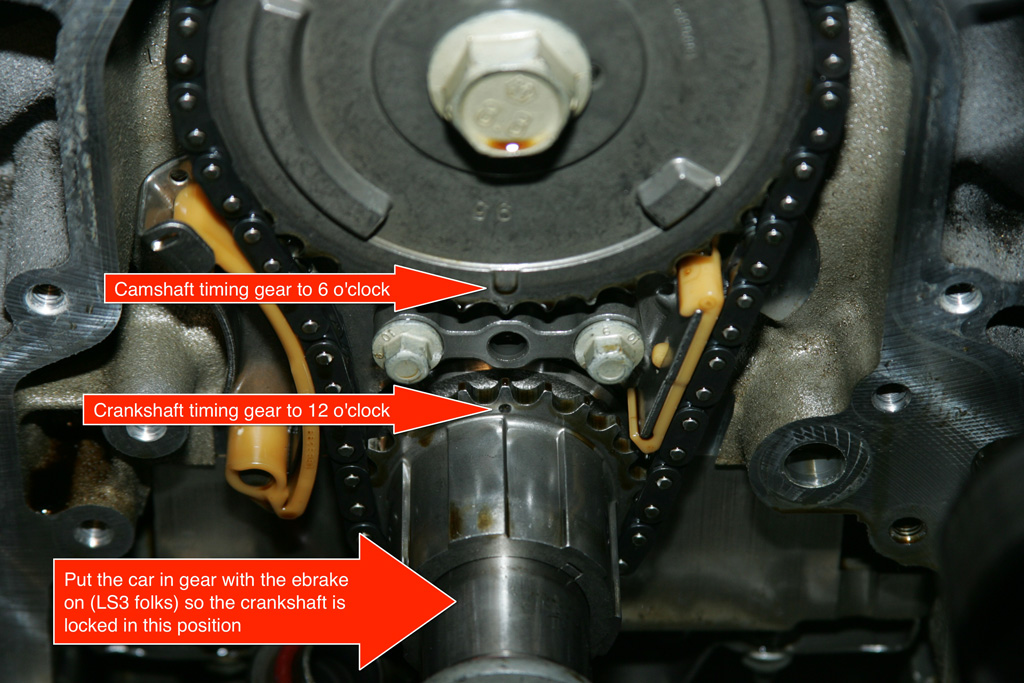

Some of my concerns based on the information that has been provided up to this point
1) cam timing - I think your mechanical timing is off based on the way you explained setting it; there are countless videos on YT that show you how to properly set cam timing on a LS motor. The cam sprocket is indexed via the dowel pin on the cam.

This is how the proper cam timing should appear with #1 at TDC
If I read your post correctly, you said you had both timing marks at the 12 o clock position....if so, your cam is off by 180*

Thanks again, Jeremy. To clarify the cam timing point, when I installed the camshaft sprockets they were aligned precisely as you describe (cam at 6 and crank at 12), and the dowel was firmly in the hole as well. I was very careful about this. The 12 o’clock and 12 o’clock mention were specific to adjusting the rocker arms with the number one cylinder at top dead center. If the camshaft were 180° out, I wouldn’t expect the engine to run at all, and would expect to have some valve interference issues.

Yeah car wouldn't run if it were out 180 anyway and you'd have catastrophic damage on first crank.
Edit, actually 180 out might not cause damage at all it just wouldn't run. The valves would still follow the piston in the same fashion, but the fuel/spark wouldn't fire at the right time.
I wish i could find the video, this dude on YT had it off by 180* and it ran......he went to tune it and of course it didn't pick up power. His tuner told him to check the cam timing and no shit it was off by 180* (or at least thats what he claimed)

Yeah it may just barely run, it's just the valves are opening/close on the wrong strokes. Having it like 20-30 degrees off would be a lot worse and would lead to piston smacking.
