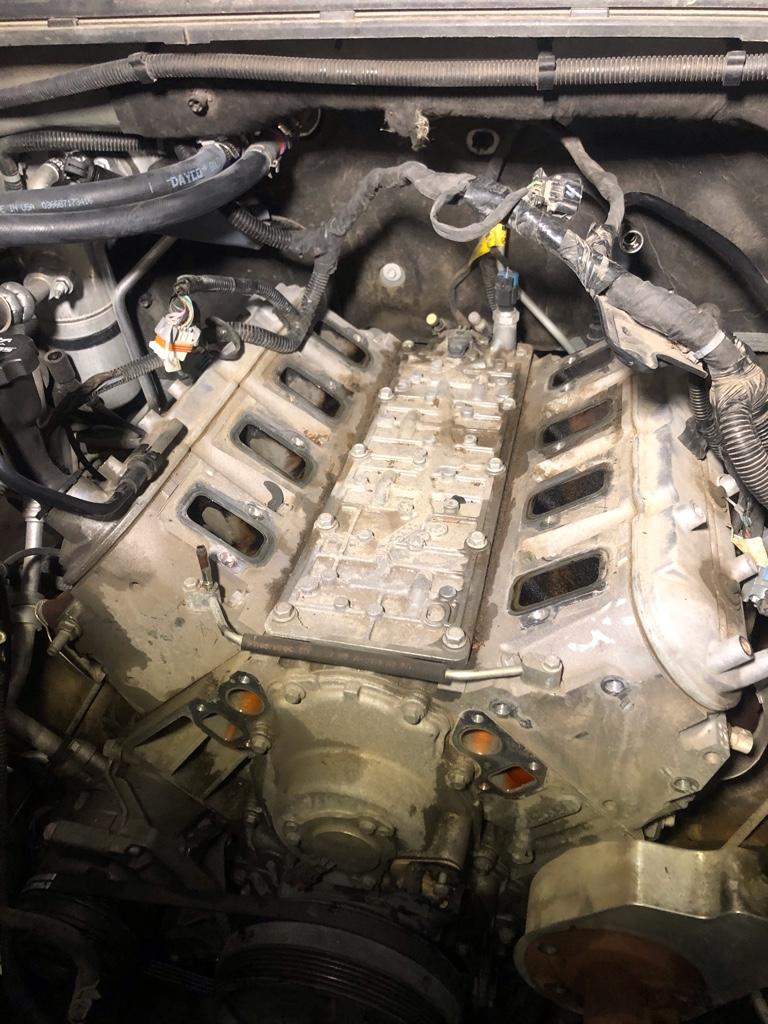

Made some progress today. Only had a few hours to work on it but got the front fascia off, coolant drained and the intake manifold off. Hope to get the heads off this week and over to the machine shop.
As an insurance policy I also ran a logging session with the Autocal v3 and also pulled the stock tune files off the ECM before starting the work. I realized that it would enable Black Bear to prepare a tune to get it up and running while it’s out of service, and then I can work with Steve Frost for a final in-person tune.

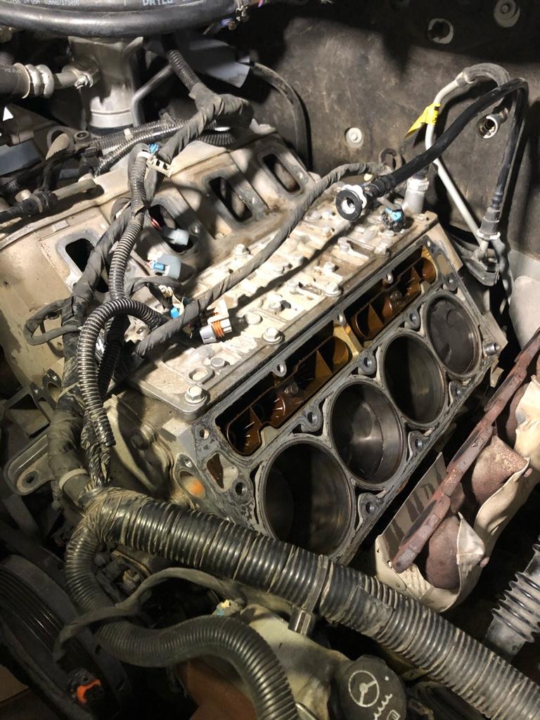

Had about an hour this evening to get the driver’s side cylinder head off. Seems strange to be taking apart a perfectly good engine, but also helpful to know that when it goes back together it will be better than new in many ways.
All of the parts look like new, all of the rollers on the lifters roll smooth as silk, so it’s good to know that it was well cared for. I got lucky on this side, and had no problems with the exhaust manifold bolts. Fingers crossed for the passenger’s side.

Both heads are off and headed to the machine shop this afternoon. Some lessons learned:
  • Take both front wheels off and the wheel well liners out. You'll thank yourself.
  • Chemical gasket remover foam works incredibly well. I was able to get all of the head gasket residue off the block without any abrasives. The stuff goes on with the tiny plastic bristle brush built onto the top of the can, sits for 30 minutes, and wipes off with a shop rag and very little elbow grease.
  • The oil pan has to come off (dropped a few cm, anyway) to get the oil pump off. I'd hoped to be able to do it without dropping the pan, but can't get a wrench on the pickup tube bolt no matter what I try.
  • The exhaust manifold bolts take time, patience and penetrating oil to remove without snapping one off. I was patient, and got very lucky.
  • The manual says the exhaust manifold to flange bolts need to come out. I didn't need to do that. I used the plastic handle of a dead-blow hammer to wedge in between the manifold and the head to get the bottom row of head bolts out on both sides. Plenty of room.
  • Take the head bolts out in the reverse order of installation, loosening them 1/4 turn each in sequence. Takes about 15 minutes per head to do it this way, but reduces the chances of aluminum head warpage and cracking.

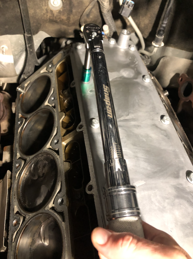

Here's a shot of the new flat valley pan going on. Happy wrenching!
