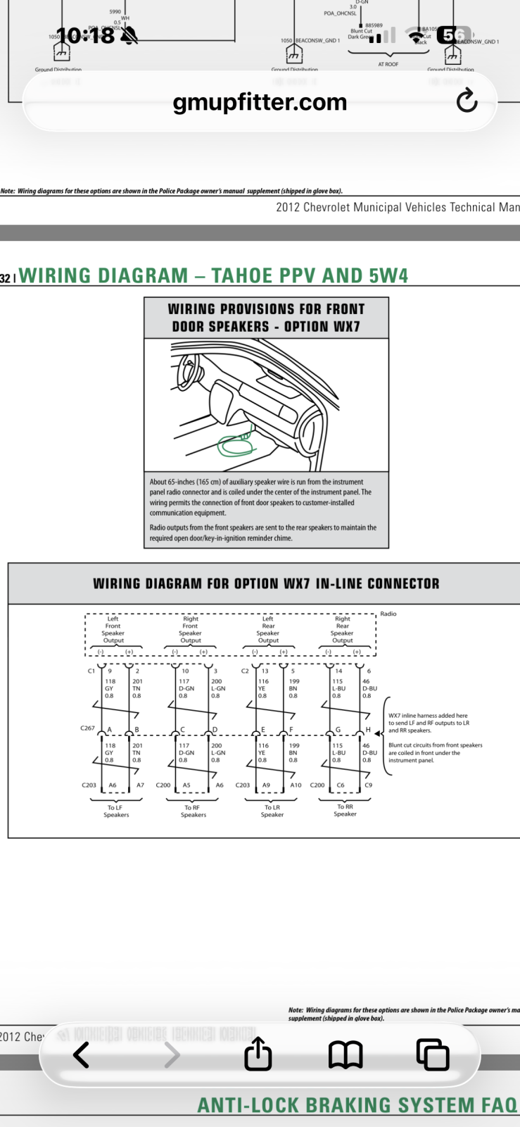

Gmupfitter.com has some diagrams for the wiring specific to these trucks
I have the same links ans they are not longer that way in the tahoe if i change the fade and balance on radio it all goes to front an no sound at the rear side so i think it may have been changed up too

What's going on?
Are your right side D-Pillar speaker wires Dark Blue and Light Blue? Are the left side Brown and Yellow?
If so, they tie into the rear door speakers which in turn go to the amplifier.

the uppfitters typically cut the rear speaker wires inside behind the front/rear door pillar, pull that plastic cover off and have look inside there
also if the 2nd row center console hvac/rse control is not connected that will disconnect the rear speakers, there is a way to jumper it to make the rear speakers work

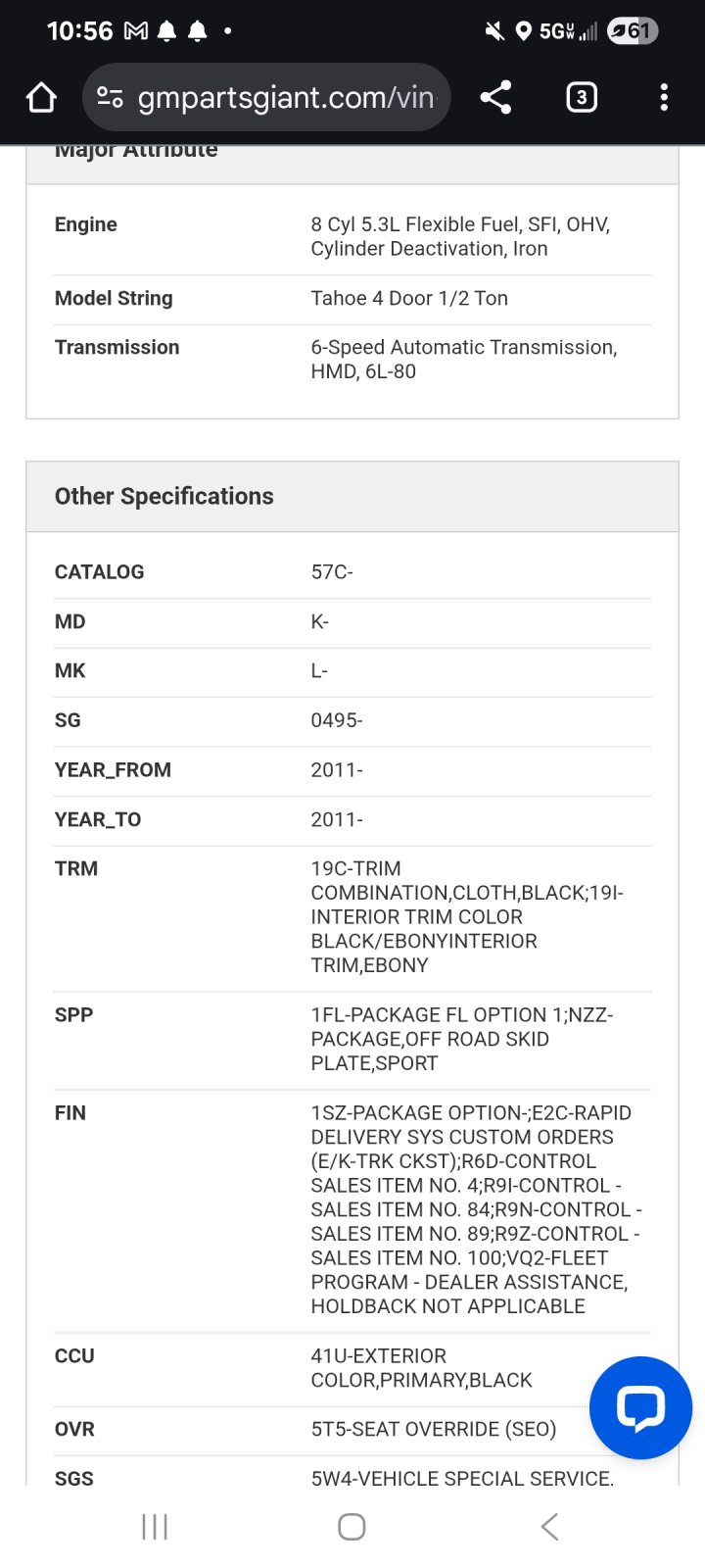

This is the vin breakdown for my ssv if it helps

I pulled the radio today an i bypassed the harness for speakers and went right to the harness in the b pillar by the door plug on both rear still no sound fronts work fine. Next i am gonna try another radio

*** If the 2nd row center console hvac/rse control is not connected that will also disconnect the rear speakers, it can be jumpered, I think @89Suburban did his that way

I went right from the radio wires on back of the head unit to the b pillar to the speaker wires bypassing all harness and still nothing i check the speakers with another radio source not from the tahoe they work the factory radio isnt putting signal to them is what it seems like
