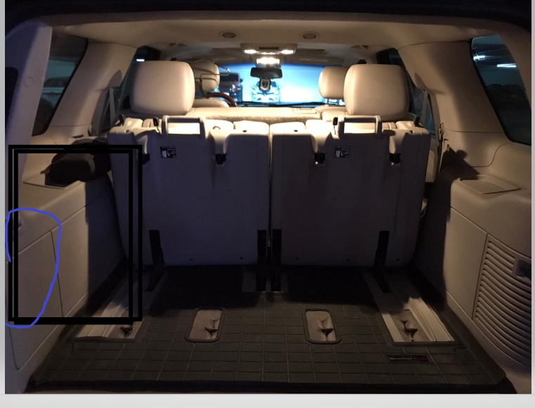

Here?
21,320
30,313
A little higher up behind the D-Pillar and under the speaker. It's called the Remote Control Door Lock Receiver (RCDLR) and controls both the remotes and the tire pressure monitoring system. A new one has to be programmed to the vehicle. You ought to get a proper scan tool on it and verify that that is the problem, see what the internal BCM codes are before throwing money at it.
