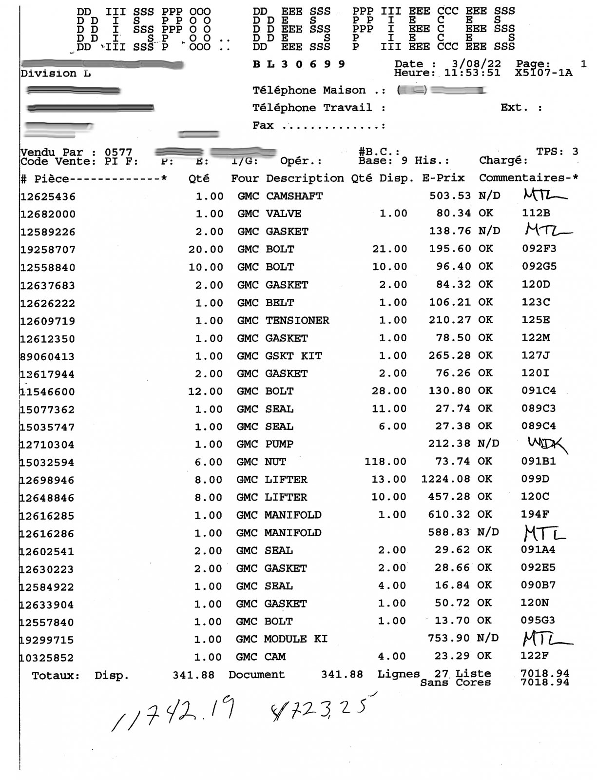

odd tried posting the parts list and a reply... did not get through... will try again...91rs...how long i have the vehicule...?...read the first line.. here to complain.....yes because this is not normal... yes the diagnostic is not part of an inspection, but they do have eyes and if they REALLY took the time to look, would have seen things in the 10 years i have been going ....and if you think it is normal and nobody ever complains, be prepared to hear more and more "its normal" from business and companies because they know we are accepting to be "consumers" and no longer "customers"... reminds me of when my saturn vue had a tranny noise and the dealer said it was normal and would not be fixed, and that there was another customer with the same problem.. so I asked him if they would be recalling the million or so that do not have the noise, and play with the tranny so they do make the noise....they kept it and fixed it....... here is the parts they want to change...

the 7018 is just the parts.... the 11742 is the total.. assuming they do not suddenly "see" better and find more things

some of those parts sure have a high mark up.
crate engine 6.0l when i was doing mine was something like 7 or 8k usd last year.
and with a rebate.
And that shop, run away.
200 for a tensioner?!
whole timing chain set is less than $80 usd.
Now if you have VVT, then hell if i know.
