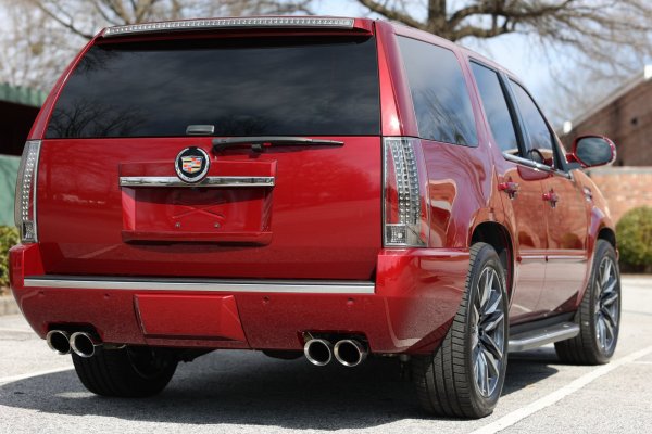

I have been planning on doing this for a long time with the Corsa exhaust on my 2008. I was planning on using all the factory hangers but based on this thread: https://www.cadillacforums.com/thre...with-platinum-dual-exhaust-components.265376/ my 2008 will not have the places for them to attach to the frame. My exhaust is still being held hostage by FedEx because it is signature required and they won't let me release it like UPS will so I cannot test fit yet. That guy's solution in that thread doesn't look terribly hard to do but I was wondering if anyone had come up with another way that didn't involve an exhaust shop? If I have to custom make hangers I may just see if I can hang the exhaust below my stock bumper. It won't look quite as good but it'll sure be a lot cheaper.

Done.

That turned out sooo nice. There are so few 11-14 Platinum and Premium Escalades that have the dual exhaust set up here in SoCal that I never knew it was a standard factory option, let alone an option not to have it too.
GM really lost out not offering the dual exhaust option on their other models. I’m pretty sure with the Explorer rollover scenarios occurring with Firestone, every manufacturer wanted a full size SUV mantra that said lots of hp to keep you safe when needed mindset.

Yes, it turned out great. I’m very pleased with it. I’ll be doing the Platinum/Premium front fascia next.
