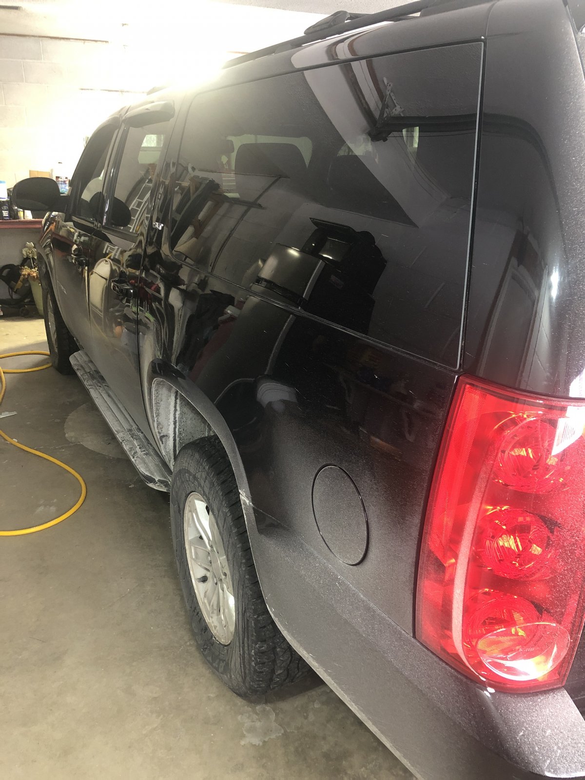

Hi y’all! I have a 2012 Gmc Yukon xl … does anyone! Know where the remote key entry antenna is located?
I have looked all over the net and no answer

if memory serves me correctly it should be on the drivers rear pillar behind the cover, to get to it you have to take the rear hatch trim pieces off first, look for youtube videos on how to fix the rear hvac your going to get to it the same way except on the drivers side.
most of the videos are going to show 00-06 but these are basically the same, there is a hidden screw (on the pillar cover) on ours you will see a little egged shaped cover, pop that off and you will have access to the screw.

Hi .. yeah I look there and nothing .. it shows for Yukon but not Yukon xl… that’s where I’m running into the problem with this antenna..I have tore the whole dash out .. the whole front headliner out the middle console out .. just lost .. Ty

It’s weird .. remote door locks and remote start will not work . The the tire monitor light is also on.. I did see somewhere it’s all tight together. I have had the the key fobs checked and both are good ! Lost

Ok I did pull all that out and did not see anything like that there but I will tear it apart again and look again .. but I thank you !

Thanks to y’all !! Found it and opened it up and circuit board was fried!! So going to get a new one then might be back here to see how to mate my key fob to it lol .. thank you all!! Michael
it's going to need to be programmed to the vin and learned to the fob's, if you have more than 1 fob they need to all be done at the same time
