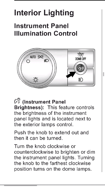

Have you made sure your dash dimmer knob isn’t turned down?
Apr 11, 2018
7,124
14,376
St. Louis
As said above, check the dash lighting dimmer knob, it controls the DIC brightness also
Sent from my SM-G930V using Tapatalk
John H Daniel
John H Daniel
Dec 7, 2020
56
56
Yep, the dimmer knob works- in night time mode. Does nothing in daylight mode except turn on dome light at full clockwise.
Should it be working on daylight mode?
Apr 11, 2018
7,124
14,376
St. Louis
It should. I know a while back I as well as others posted/complained about when it was adjusted bright enough in the daytime it made it too bright at night.
