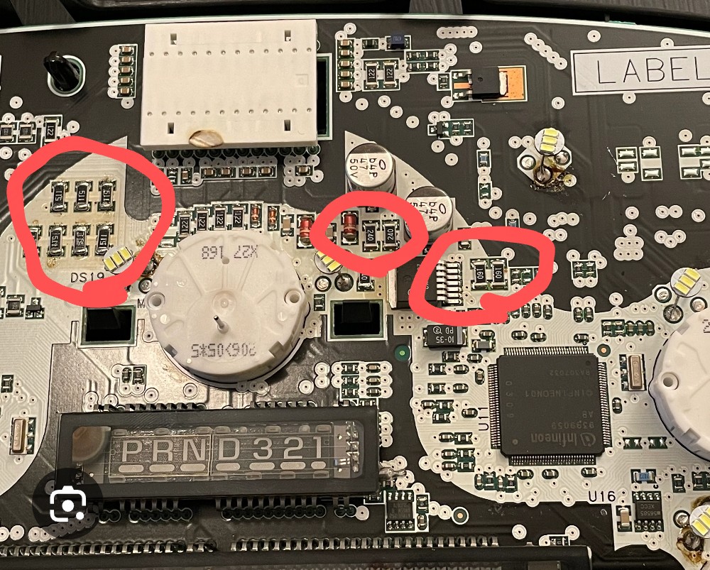

Here's a picture of the cluster board, with the resistors circled that I mentioned. Usually just reflowing and adding a small amount of mire solder to these joints will fix the problem. But there's also been instances where the resistors have completely fallen off of the board because of the bad solder joints.
Thank you for your help! This image is very helpful to know what to look for.
