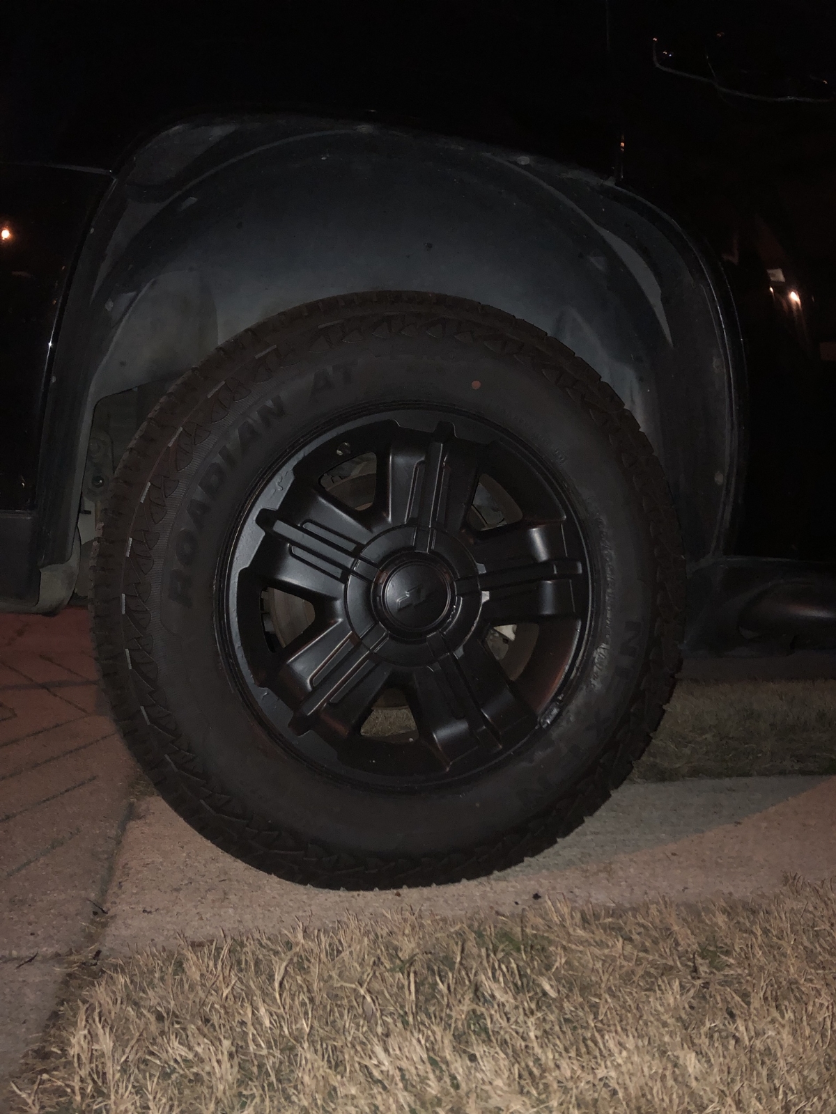

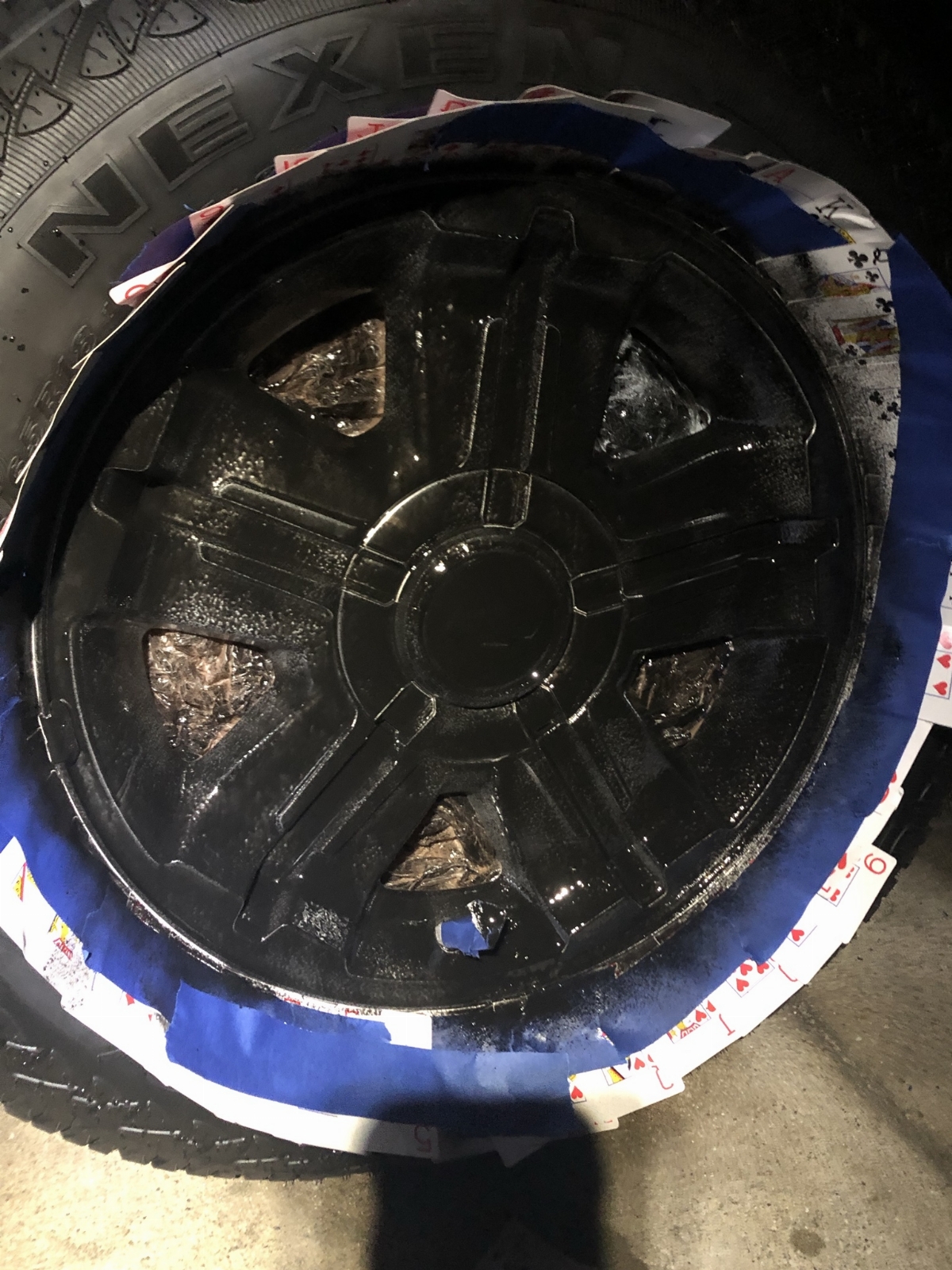

As I said in the OP I plasti dipped the rims black. Here's the way I did it--it was my first time plasti dipping and ultimately I learned a lot and would do it differently next time. I was able to do all four rims with two cans. These pics aren't all of the same wheel but you get the idea:
Wash the rims, then stuff some grocery bags in the rim to protect the rotor/caliper/brakes. Make sure the rims are COMPLETELY dry. I'd recommend washing them, drying them, and then moving the Tahoe so you rotate the wheels a little bit before you put the plastic bags in there. It seemed like random droplets of water would just appear the entire time I was doing this. Water WILL mess up the plasti dipping.
I lined the edge of the rims with a deck of cards like the how-to's online say--I would not do this again. It was a ***** to get the cards to actually stick between the tire and rim (hence the painters tape) and when you pull the cards out they pull the plasti dip off the edge of the rim. Lining the rims with cards took like 80% of the total time I spent on this. It's easier to just let the plasti dip get on the tire and peel it off later. Use a razor to cut it away from the rim.
First coat. You ultimately want the plasti dip to be on there thick, however each individual coat should be very light. Don't be afraid to do 5+ coats. The trick is to make sure the plasti dip doesn't drip. Keep it light and put a ton of coats on.
Another coat
A few coats later
A day later. I ended up doing the final coat without the cards since they had pulled the plasti dip off the edges. There's still a little on the tire in this pic but it will come off.
I didn't use the glossifier because I read it doesn't do much. If i did it again I would probably try using it though.
I may pull the dip off and redo it at some point since there are spots where you can see it kind of dripped and ran if you look closely but for now it's not bad. If I leave the rims black I'm also going to paint the calipers red at some point.

I watched a YouTube vid where the guy coats the tire surface with Vaseline instead of cards. Works great.
Shit, that’s a great idea. I’m probably going to peel the plasti dip off and redo it this summer when I paint the calipers. I’ll definitely try the Vaseline trick. I’d imagine having the wheels off the truck would also cut down on the plasti dip running as well

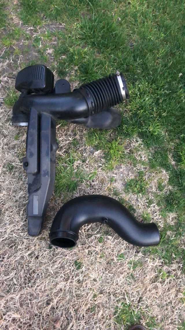

Airaid intake tube vs stock
It’s easy to tell one is built for efficiency and one is built to stay quiet.

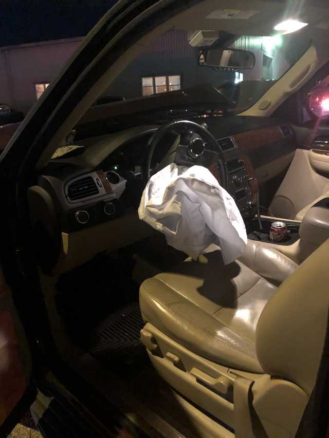

With that brush guard... did airbags deploy?
Frame damage or why total?
Glad wife is OK.
mattjones
mattjones
Aug 26, 2012
321
179
VA
Glad wife is OK.
Air bags did deploy.
They didn’t tell me if there was frame damage, basically just “it’s totaled.” The brush guard and front end were destroyed, hoses were broken and liquids were leaking, the passenger door couldn’t open. They gave me $5k over kbb value so even though I loved that truck I’m not too upset in hindsight. It definitely reduces anxiety having a Tahoe with half the mileage now—I’m not constantly waiting for something to break.

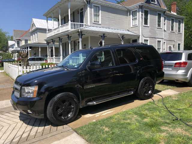

Gave the Hoe a fresh wash today.
I picked up a set of Mother’s clay bars and some turtle wax scratch remover. The clay bars work wonders, especially behind the rear wheels where lots of dirt and grime gets kicked up onto the panel. Unfortunately though those damn scratches on the doors are still there. They seem to be getting better though so I think it’s just a matter of putting in more elbow grease. I’m planning on picking up one of those microfiber disks that I can attach to my drill or an angle grinder to see if I can buff those scratches out for good.

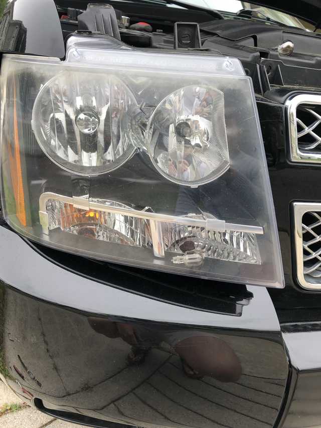

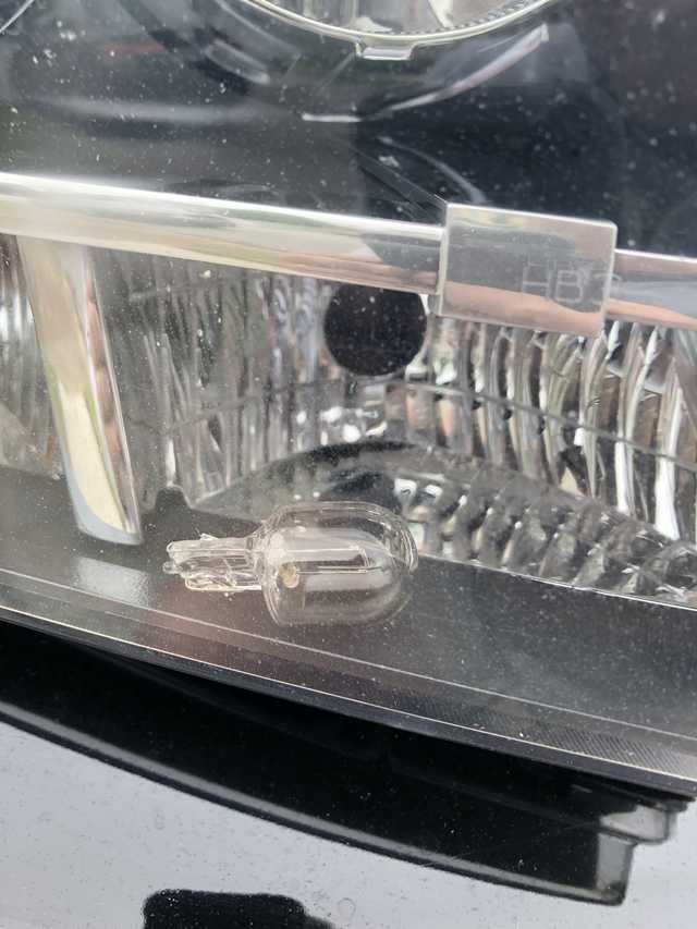

I also decided to replace a burnt out daytime running light and it turned into kind of a pain in the ass. I had some leftover 3157 bulbs from my reverse lights after installing LEDs a few weeks ago so I decided to use one of them. Big mistake—it didn’t have that plastic clip on the bottom so it didn’t sit tightly in the socket and this happened:
It took me forever to get that bulb out. I ended up using chopsticks and packing tape to get it.
I eventually got it out and swung by Walmart for a new bulb. I didn’t go crazy with LEDs or anything because I didn’t want the DRLs to be too bright. The LEDs I’ve got in my reverse lights would definitely be too much.

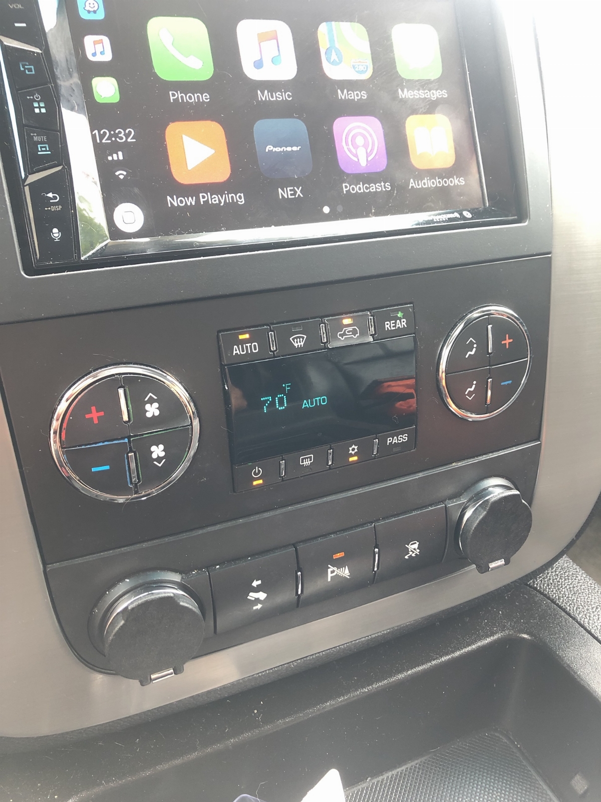

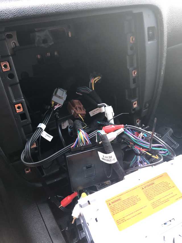

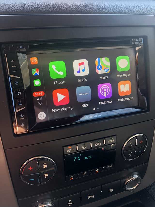

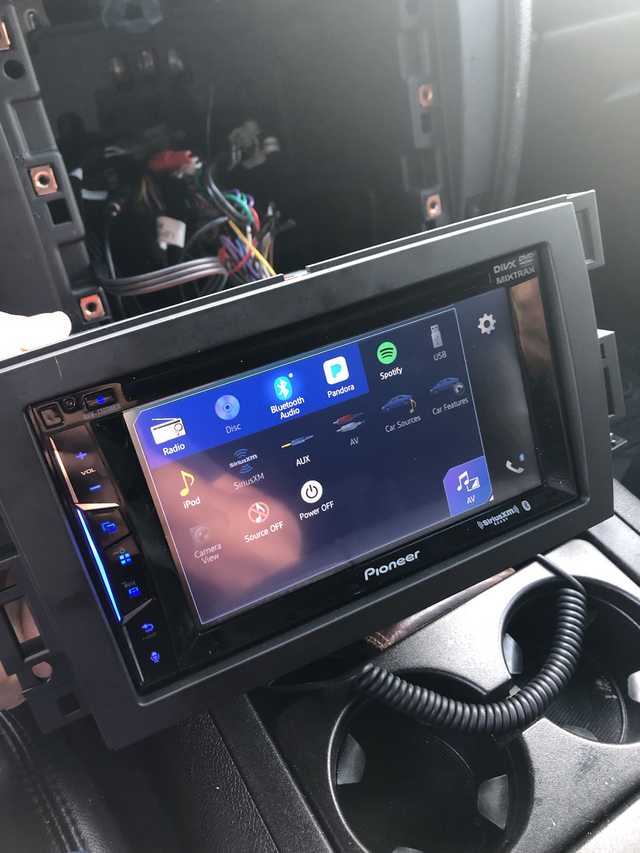

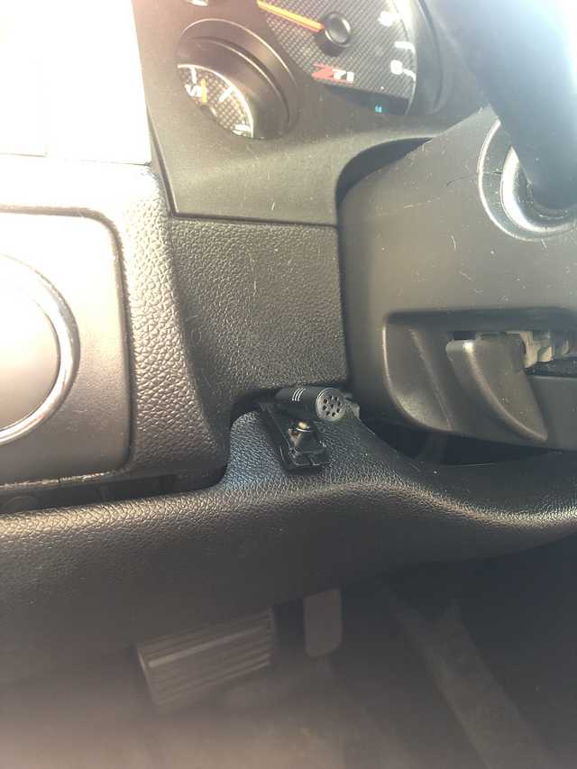

Newest update:
It gave me some headaches but I finally got the Pioneer head unit installed. The first wiring harness I tried was defective so I couldn’t adjust the door chime volume to anything less than absolutely ear splitting, but I sent it back and got a working one.
The toughest part was making it all fit in the dash.
Turns out there’s actually empty room behind the climate control and cigarette lighter units so it works best to stuff most of the wiring underneath the head unit rather than behind it.
Tested and adjusted before closing everything up.
I ran the mic wire through the dash underneath the steering wheel so that it would come out here
I picked up a USB to micro USB adapter so I could hook the existing USB port in the center console to the new head unit. I originally didn’t realize Apple CarPlay wasn’t wireless but with this cable here I just plug my phone in and throw it into the center console. There’s really no need to have the phone out since CarPlay takes care of music, google maps, and any calls/texts. If I’m in a hurry I can just keep my phone in my pocket and it will still connect to the Bluetooth and play music, I just won’t have the level of control that CarPlay gives me.
All set up and working
I need to replace the cigarette lighters since the existing ones had the covers broken off at some point. If I want I can replace them with USB plugs and even connect one to the head unit and plug my phone in right there for CarPlay to make things easier and more accessible, but it’s nice to have a clean center console with no wires

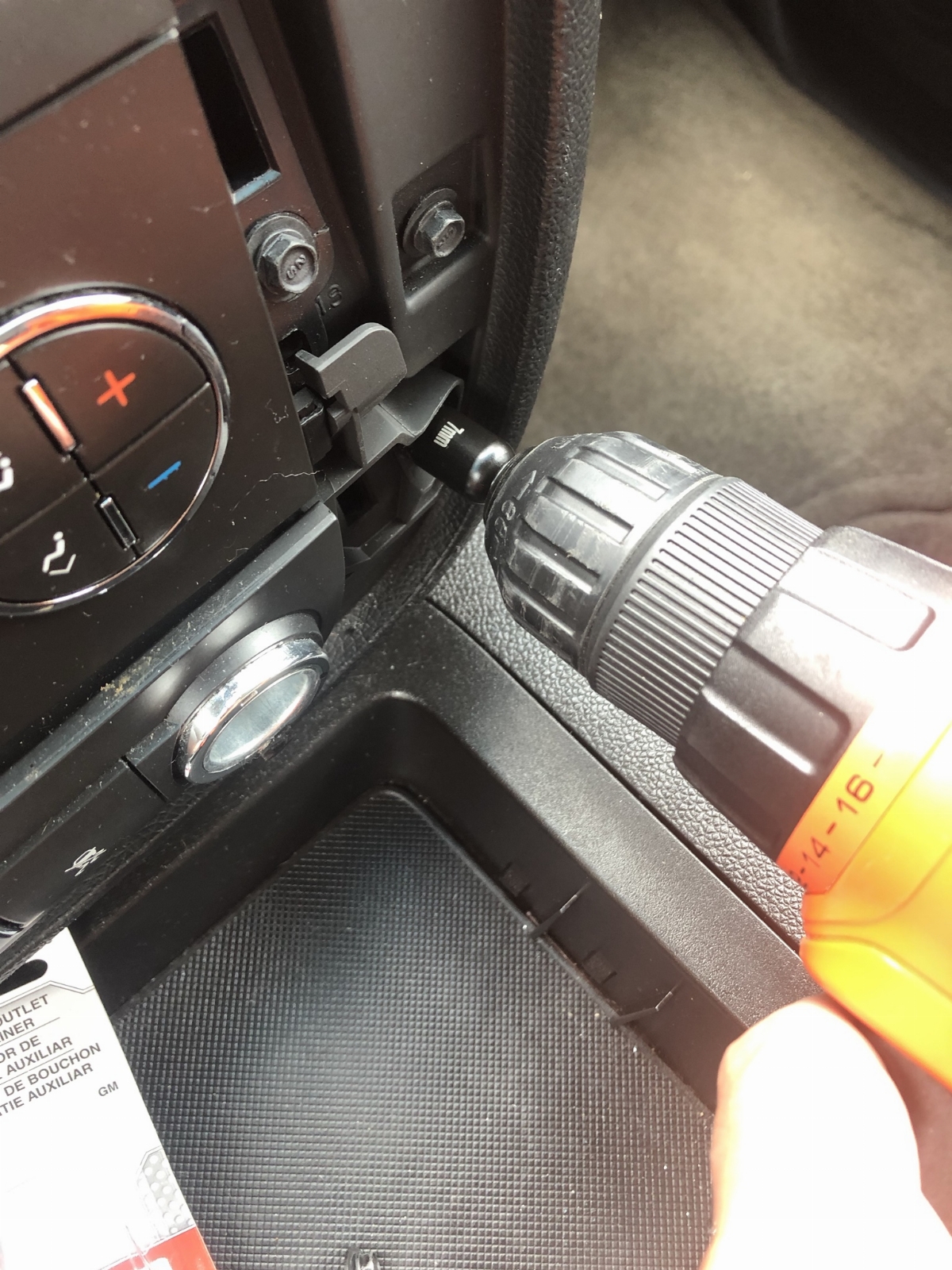

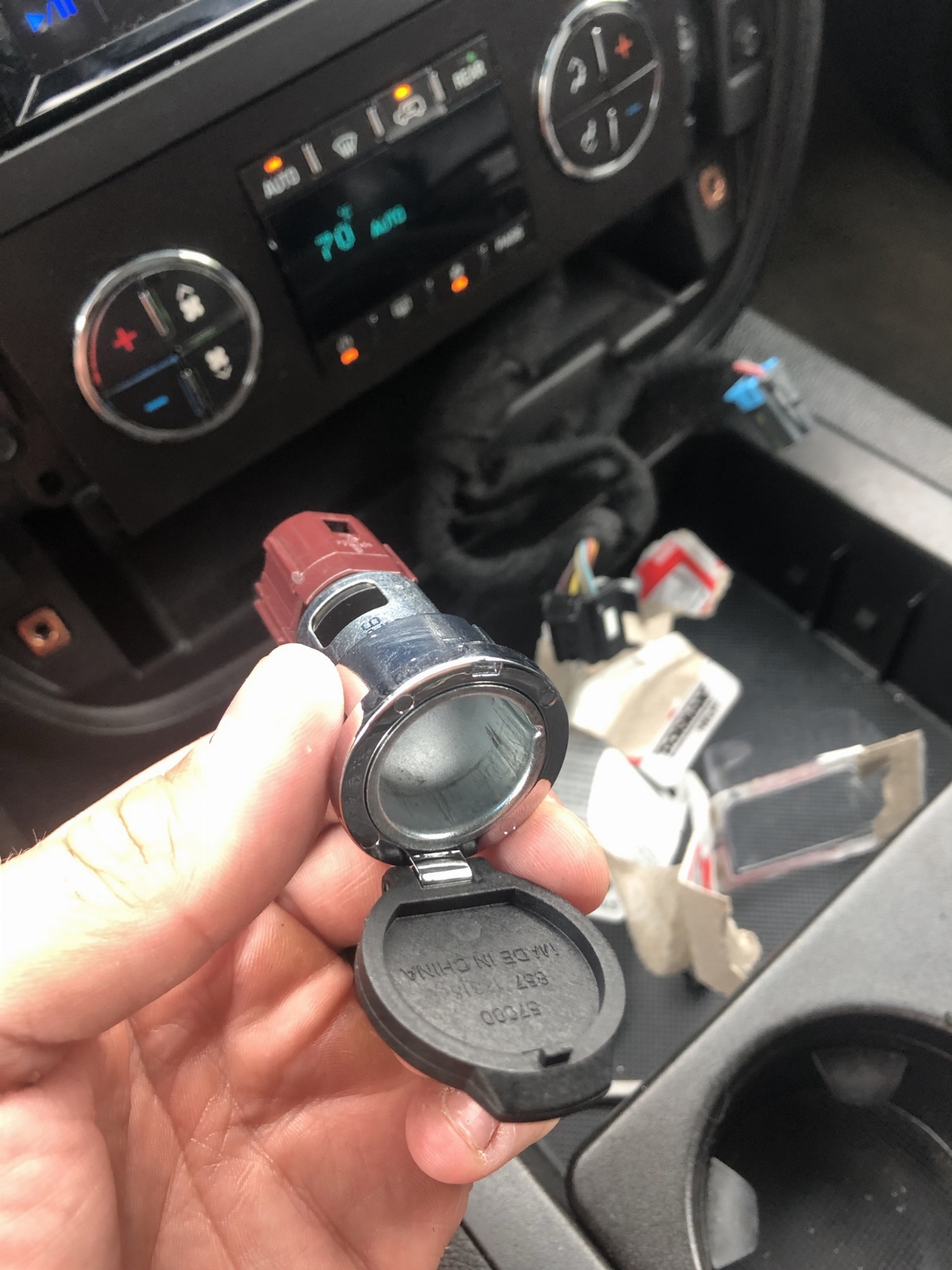

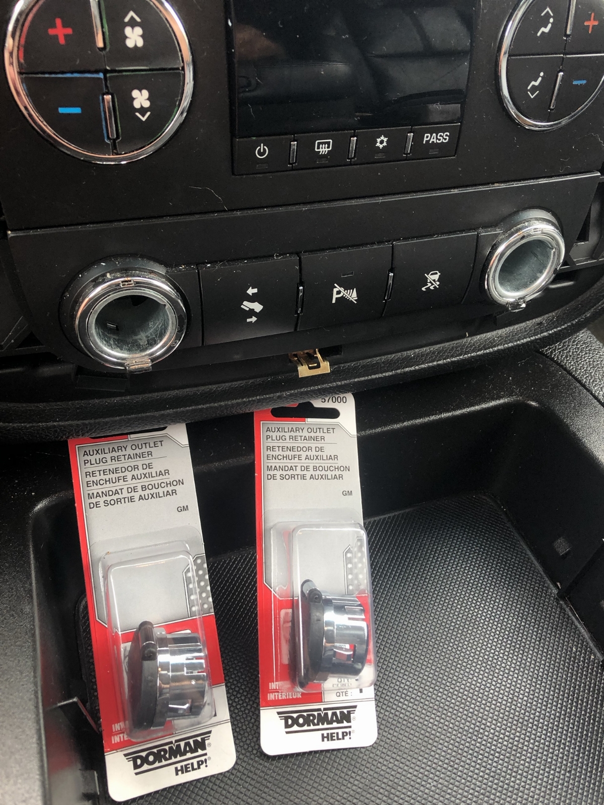

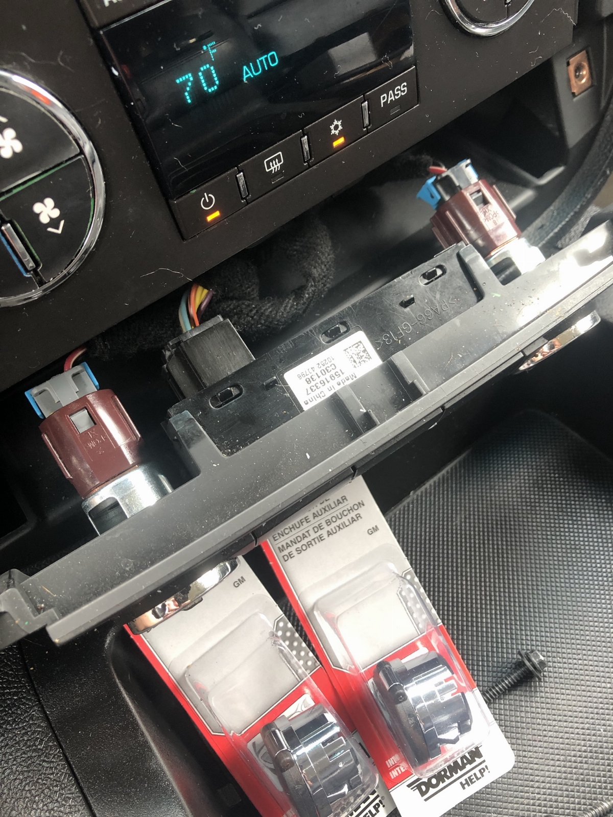

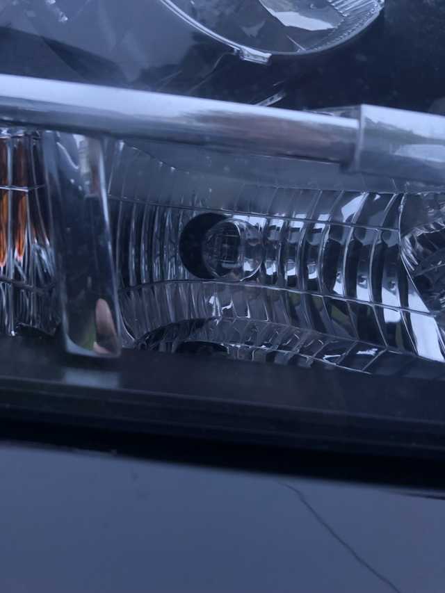

Well my other daytime running light went out about two weeks ago so I finally got around to replacing that one today. Went a lot smoother than last time since I knew how to do it and didn't accidentally drop a loose bulb in the housing this time.

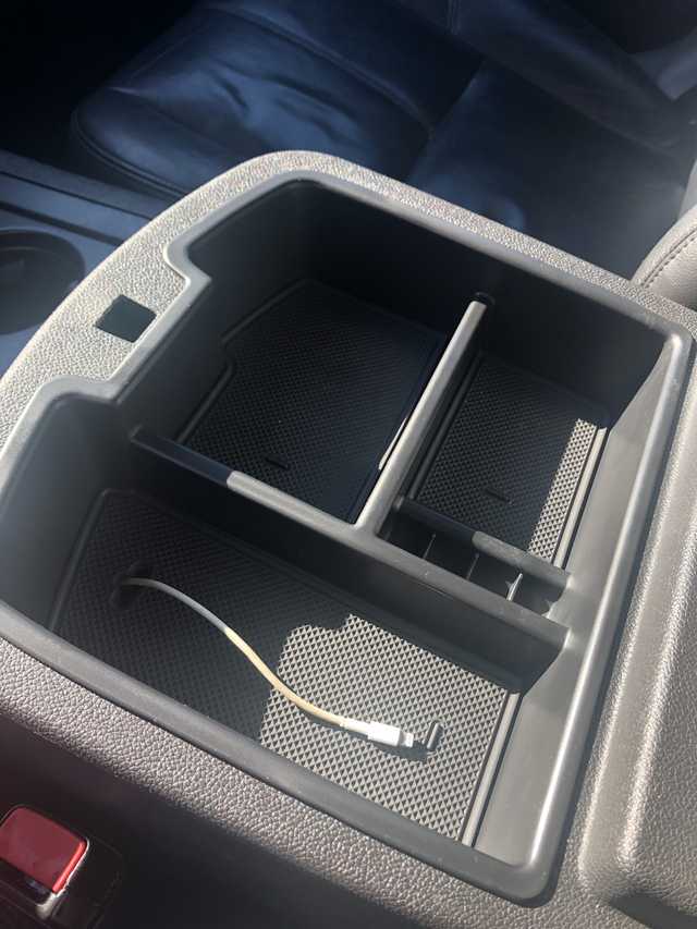

I also decided to replace these outlets that have been missing their covers since I've owned the truck
(These pics make me realize I need to get in there with a swiffer duster)
I pretty much just followed NathanJax's guide to replace these: https://www.tahoeyukonforum.com/threads/adding-usb-to-dash.41972/
I've probably taken these 7mm bolts out a dozen times recently in the process of installing that new radio
You just unclip these wires in the back and slide the whole outlet forward through the front of the unit
Then push the outlet through the front of the old broken cover and then slide the new one on from the back
The new covers are $3.62 from Amazon: https://smile.amazon.com/gp/product/B00NF18V8E/ref=ppx_yo_dt_b_asin_title_o05_s00?ie=UTF8&psc=1
And then put it all back together
