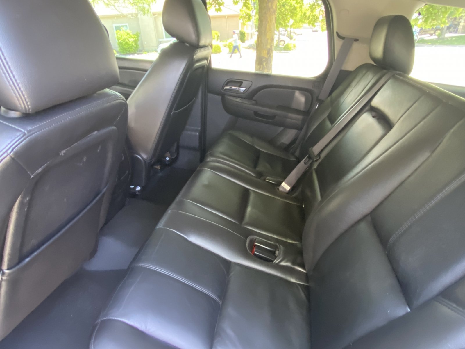

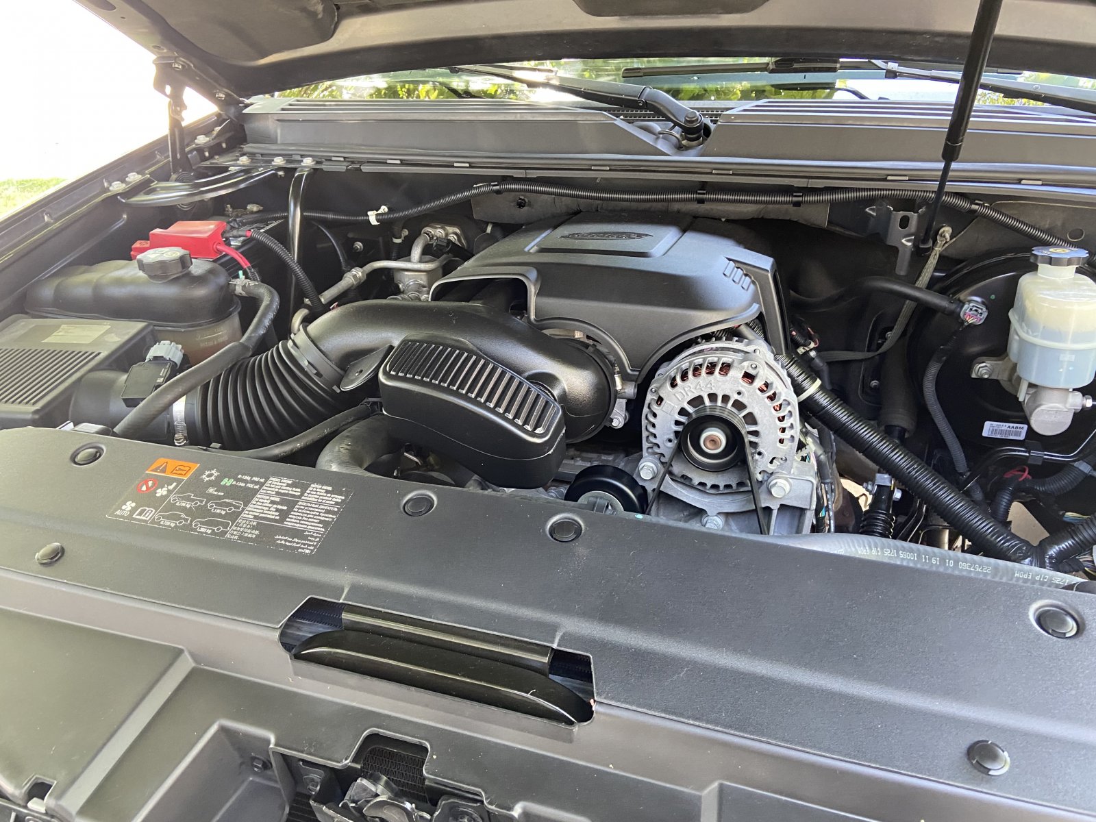

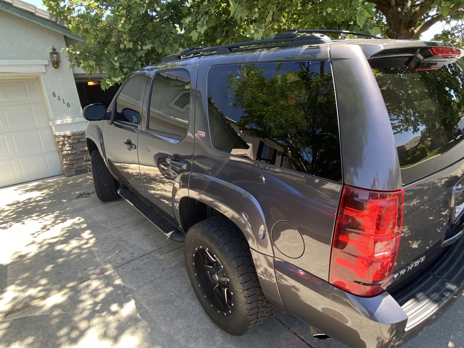

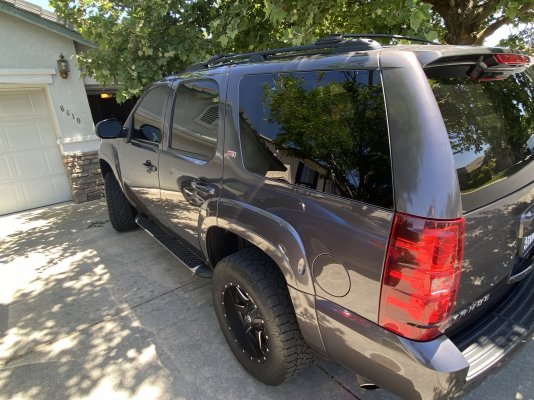

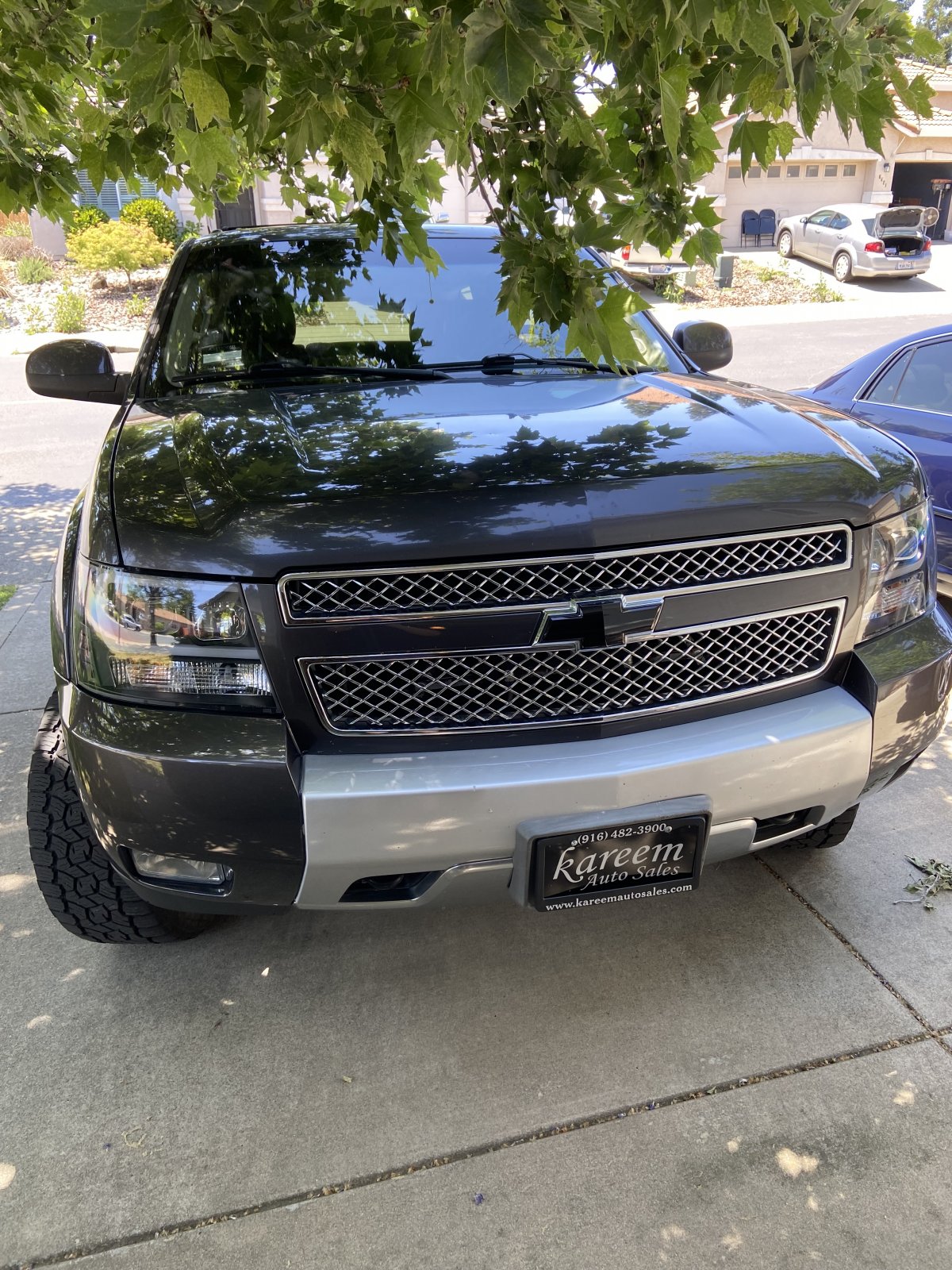

Pcitures!
As
Requested.

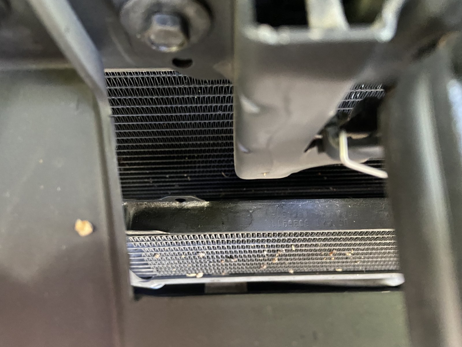

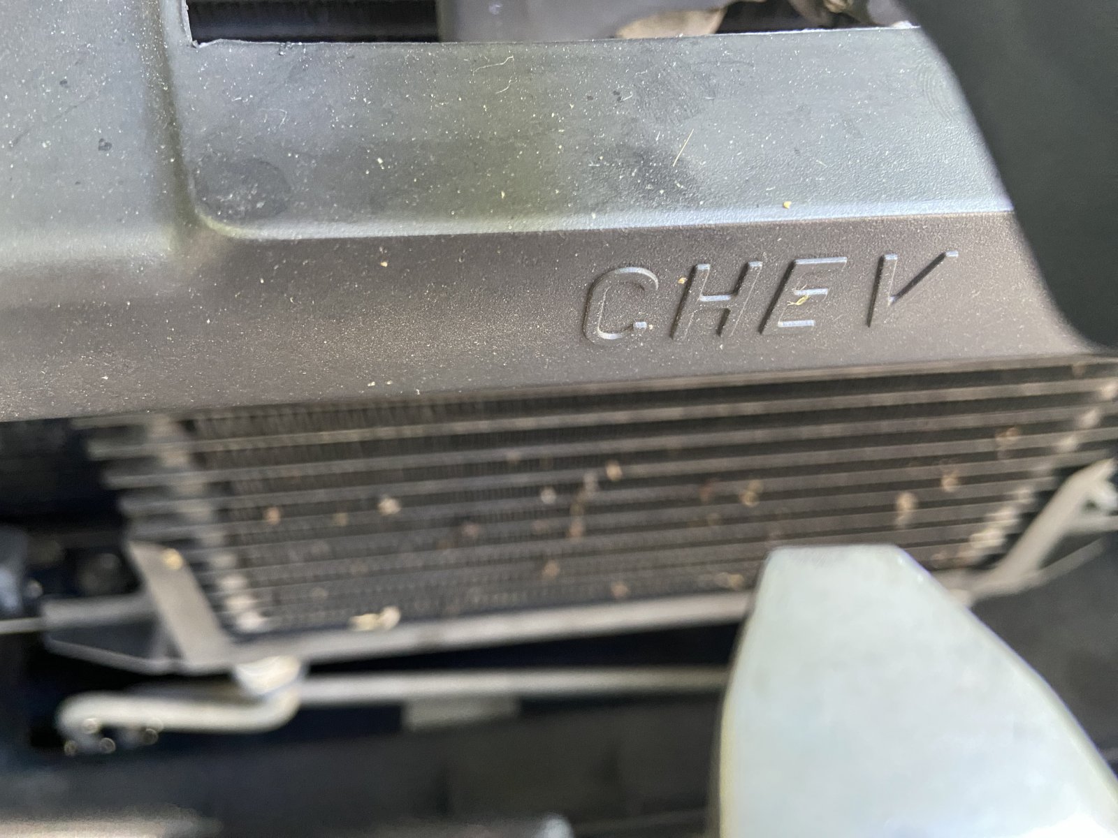

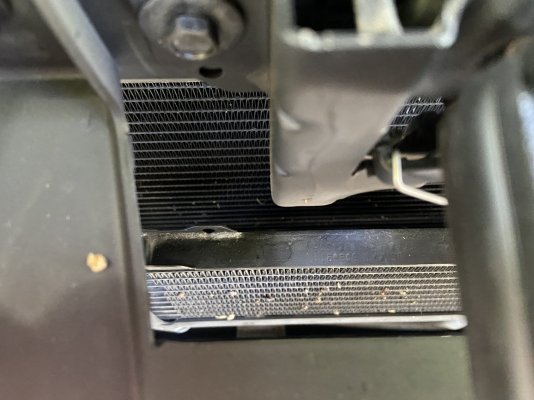

So I monitored the temperature of the transmission. At night is was 86 degrees to start and maxed out at 136 degrees on a 45 minute ride with 55 degrees outside. At daytime. It maxed out at 186-192. With stop and go. On the road with a 45 minute trip it level offed at 186 degrees. With outside temperatures of 85 degrees. Theses daytime temperatures are consistent. Without seeing and inspecting the transmission. In your opinion Is the transmission old and worn out? What is a normal transmission temp for a 2011 Tahoe?
What do you recommend? What does my 2011 have? Thermostat replacement need or do you recommend auxiliary cooler. What’s the difference between both? What’s the cost of replacement and or putting a new system in place like and auxiliary cooler?
Thank you.
Ken

temps are fine. Goes through the radiator so it will tend to get up to ~190.
NO thermostat until next body style according to Doubelieve. Only helpful for cold temps I believe.
Transmission cooler is good. (Looks like you have one? Or is that power steering?) I'm looking for a trans cooler myself.
I have a little over 200k and I think it shifts fine and well. But only had it about 6 months..

I did see that normal Transmission temps are 185-200. Well at least the internet thinks so. I have been reading a lot and not just expecting answers from you or anyone else.
Thanks again for your time. It’s not wasted.
No I don’t have one I looked it’s the radiator in the back and the part to the Ac that looks like an auxiliary cooler. So says the rookie. Could be wrong. But I don’t think I have a cooler.

Thank you. I did look on-line and saw other opinions on other forums including this one. Past knowledge tends to agree with your opinion on transmission temps.
