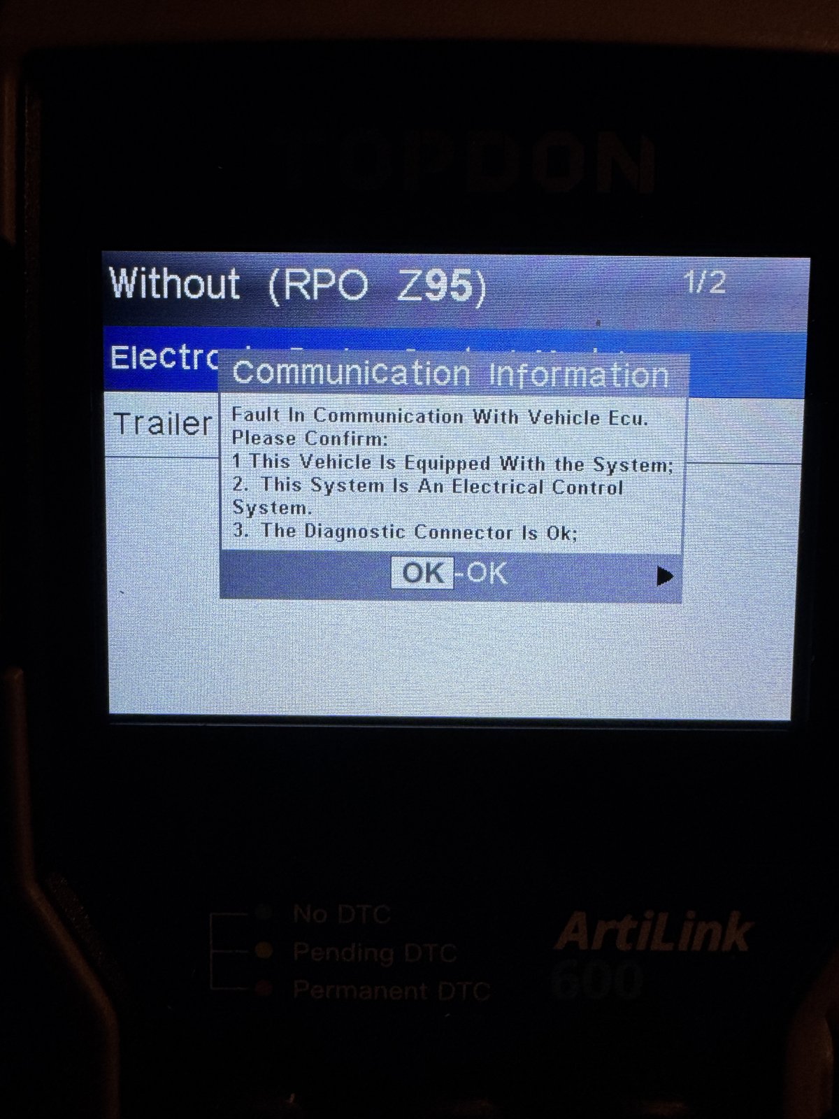

My 2009 Tahoe has Traction/ABS/Brake lights lit. Scanner won’t communicate with the ABS Controller so I can’t read codes. This made me think the controller is bad. I have checked fuses, cleaned and reseated the ground. Not sure what to check next. Brakes are new, just did front bearings with new ABS sensors. I was thinking of putting new sensors in the rear but since the scanner doesn’t communicate with the controller I’m not sure that will fix. Help please!!

And your scanner pic seems to say that the connector itself is OK...
