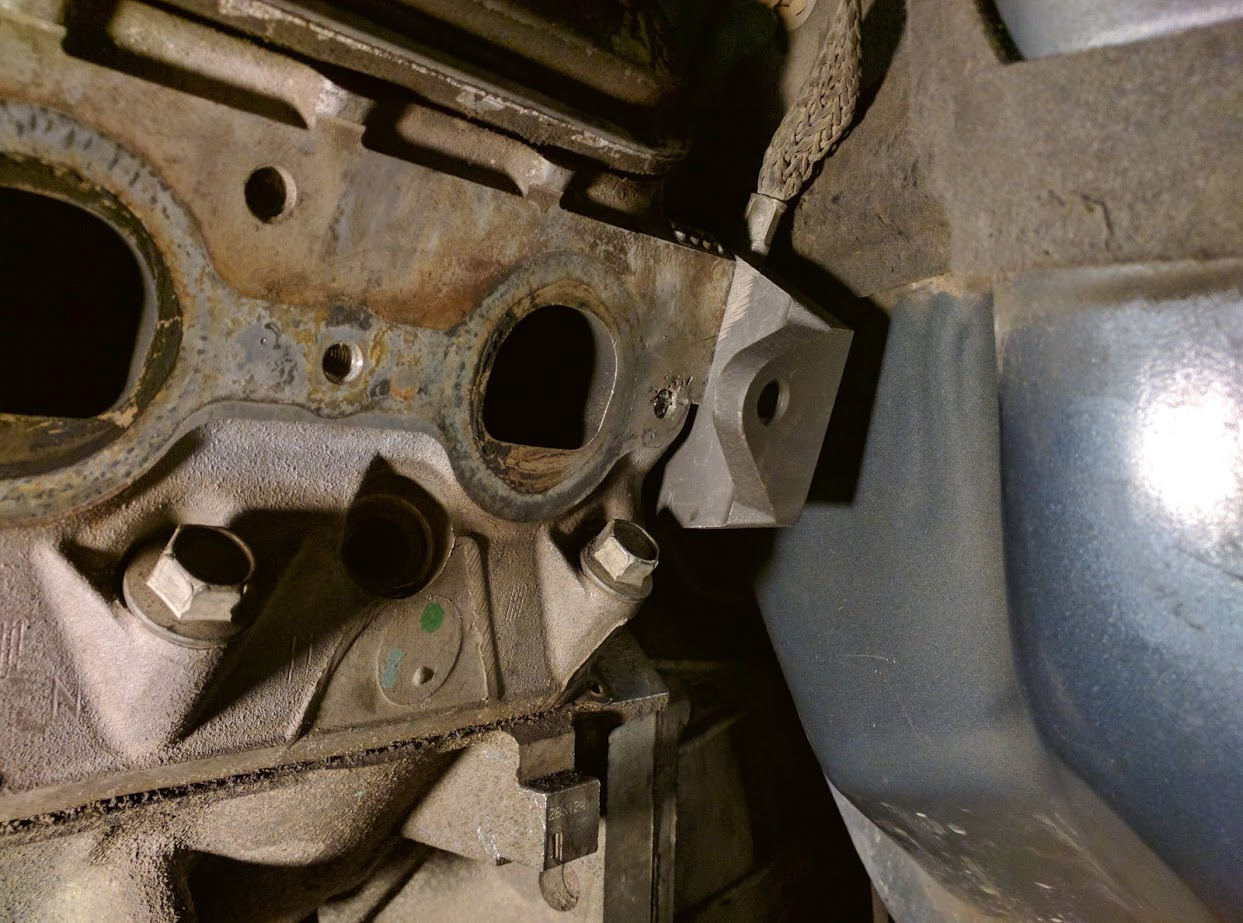

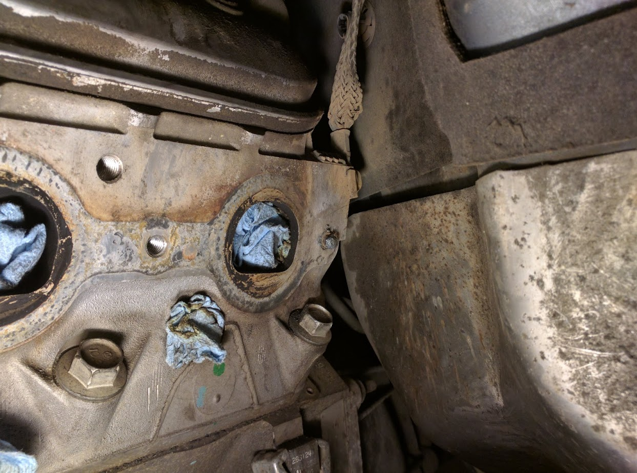

Defeat. I lost. I dont have the time or the skill to get this ****** out. I went through 5 welded bolts and stacked welds with channel locks. I can't get anything to fit to drill out. I'm not pulling the engine so am using the Dorman manifold braces (which are also a ***** to install).
I can't get it. I damage the head each time I try.
Here is the Dorman piece in place. I had to hammer the ground wire connector flat to fit.
More later. Bummed :(

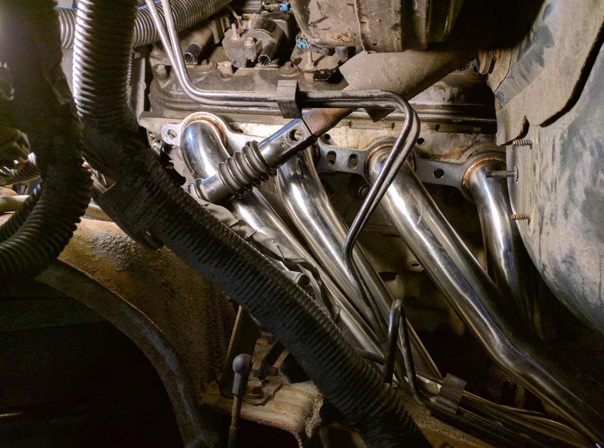

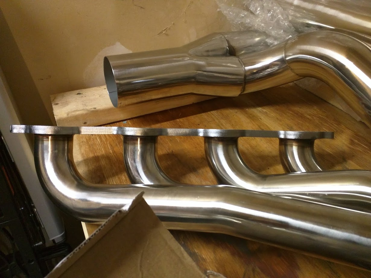

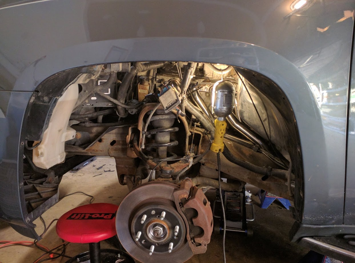

This experience sucks. I've done trans swaps and this is up there.
To get the DRIVERS header in..
- Remove wheel.
- Remove inner fender well cover.
- Remove spark plugs and wires.
- Remove stock manifold and ypipe. See my other posts. I had to cut all mine out.
- If AWD/4WD drop the front driveshaft.
- Remove heat shield on fender.
- Remove rear O2 sensor completely. Be prepared to tune or get a tune.

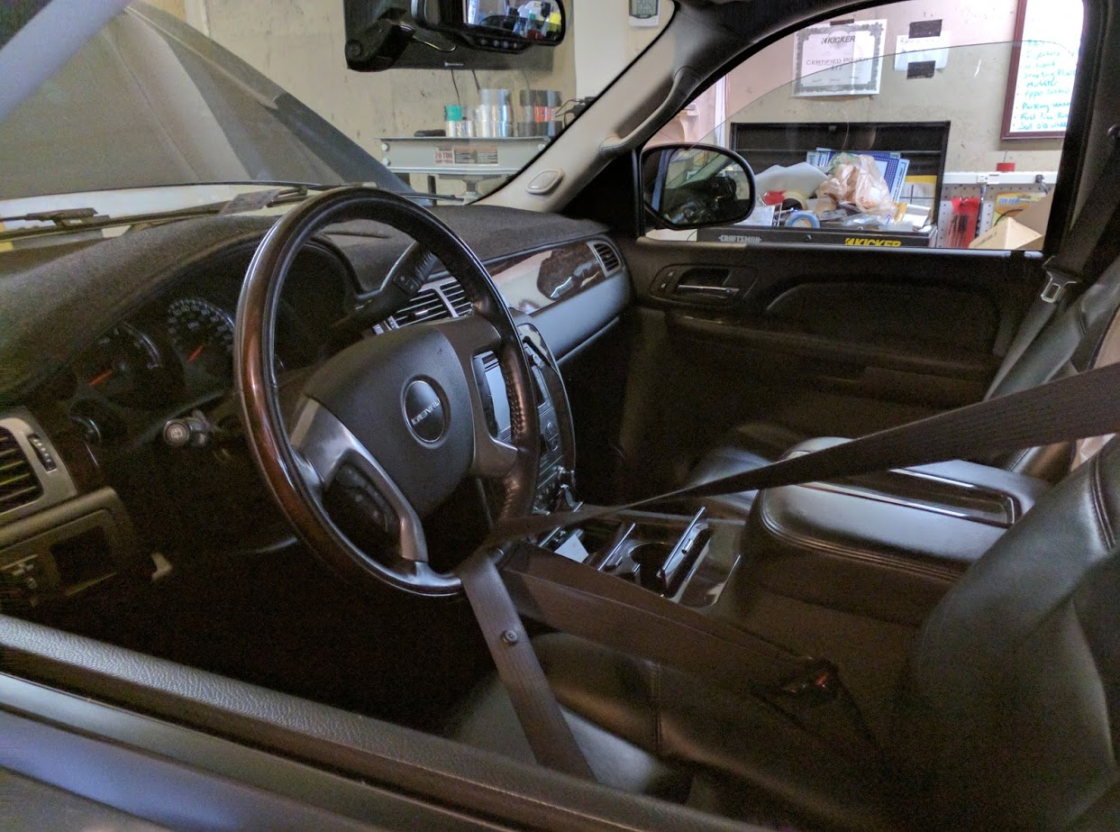

- Disconnect the steering shaft. Mine was rusted to all hell, removed the under body shield, used a screw driver to wedge the shaft off and hammered off. I couldn't remove it from closer to the firewall. Lock the steering wheel in place.
- Put the header in from the TOP. Shoe horn and wrangle that ***** in place.
- Not done but in place.

holy shit man...you gotta get that steering shaft out completely, 12mm on the bottom where it connects to the rack, after you get it out push the upper part of the shaft back in the cab as far as it'll go and driverside goes in from the top, may need to jack up truck a little iirc to allow the collector a little more room before swinging in place.
same headers, same truck -i dont remove any of that but the steering shaft, i can do it with leaving plugs in but ive gotten careless before and broke one.
Dude. I have SOOO much rust. I couldn't get the steering shaft out near the top. Seriously rusted in. :-/
You didnt need to loosen the front driveshaft?

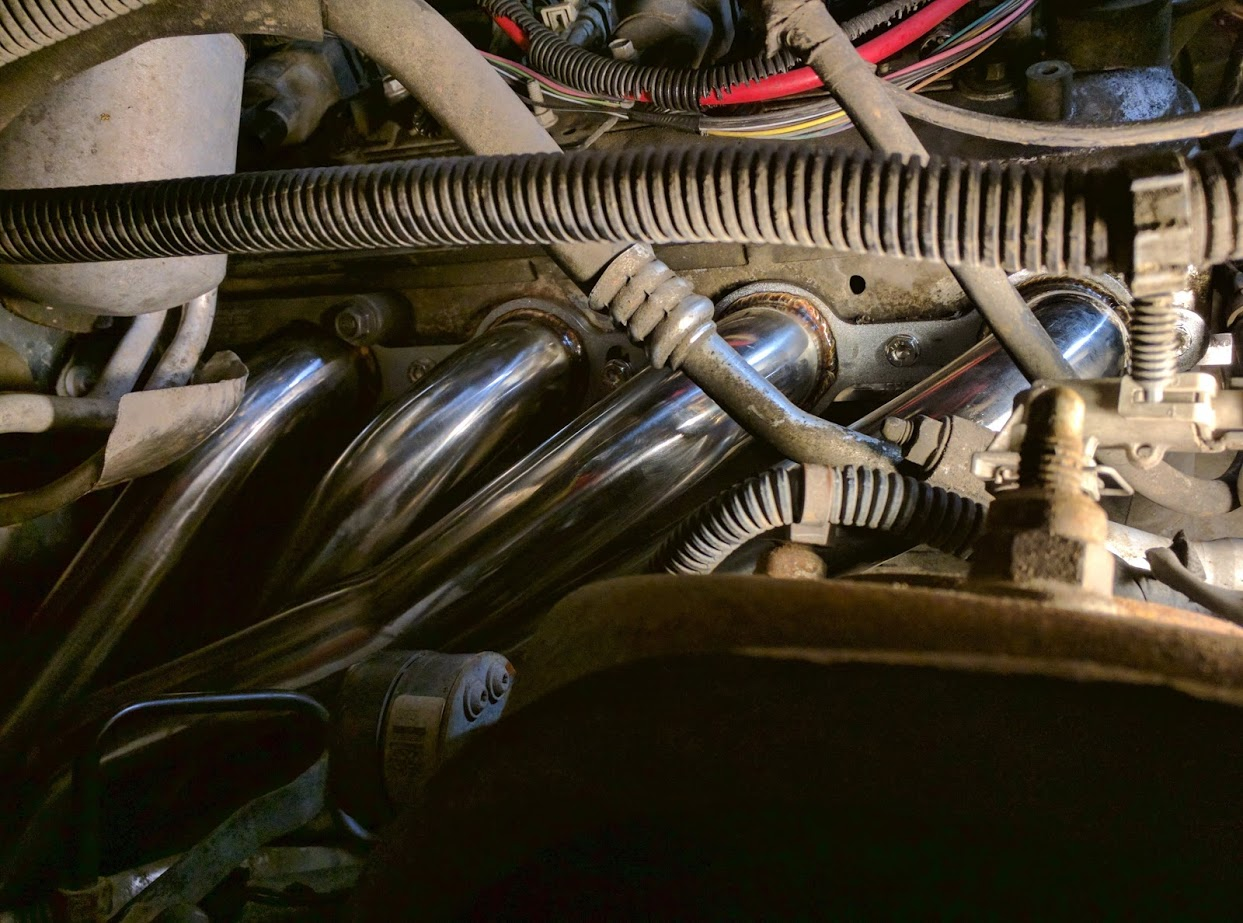

All bolts and dorman piece in place on the passenger side. Not torqued. C'mon, work only leaves so much time to play :-/ I'm liking the stage 8 bolts. Soon I'll put the tabs on that stop them from backing out.

Passenger side about done.

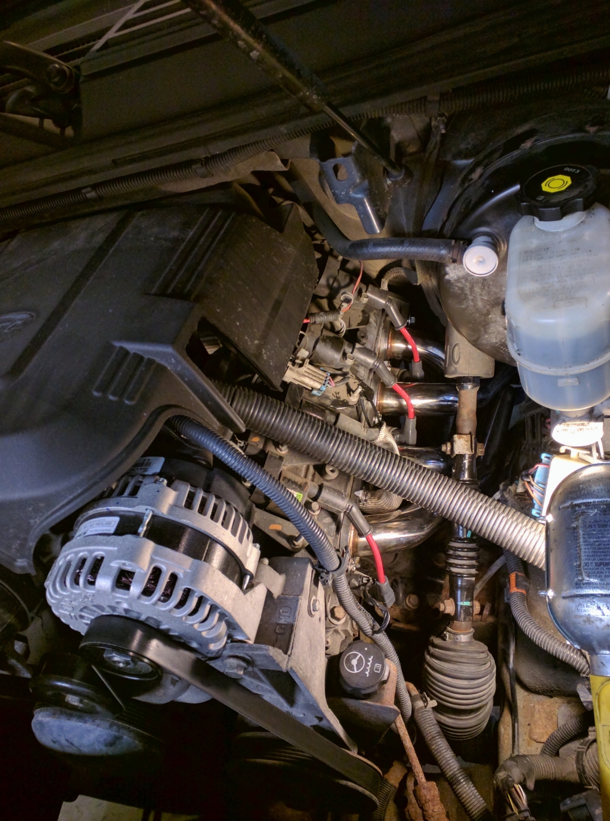

I had an hour. Passenger side done. Torqued to 18 ftlbs. Locking bits in place if you look closely.
Drivers side getting close.

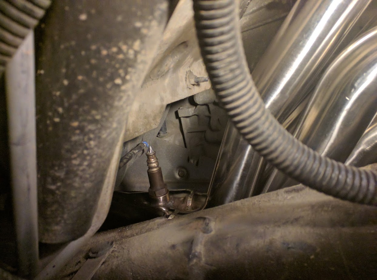

Drivers O2 fits well. I was concerned since I saw old posts where this was an issue.

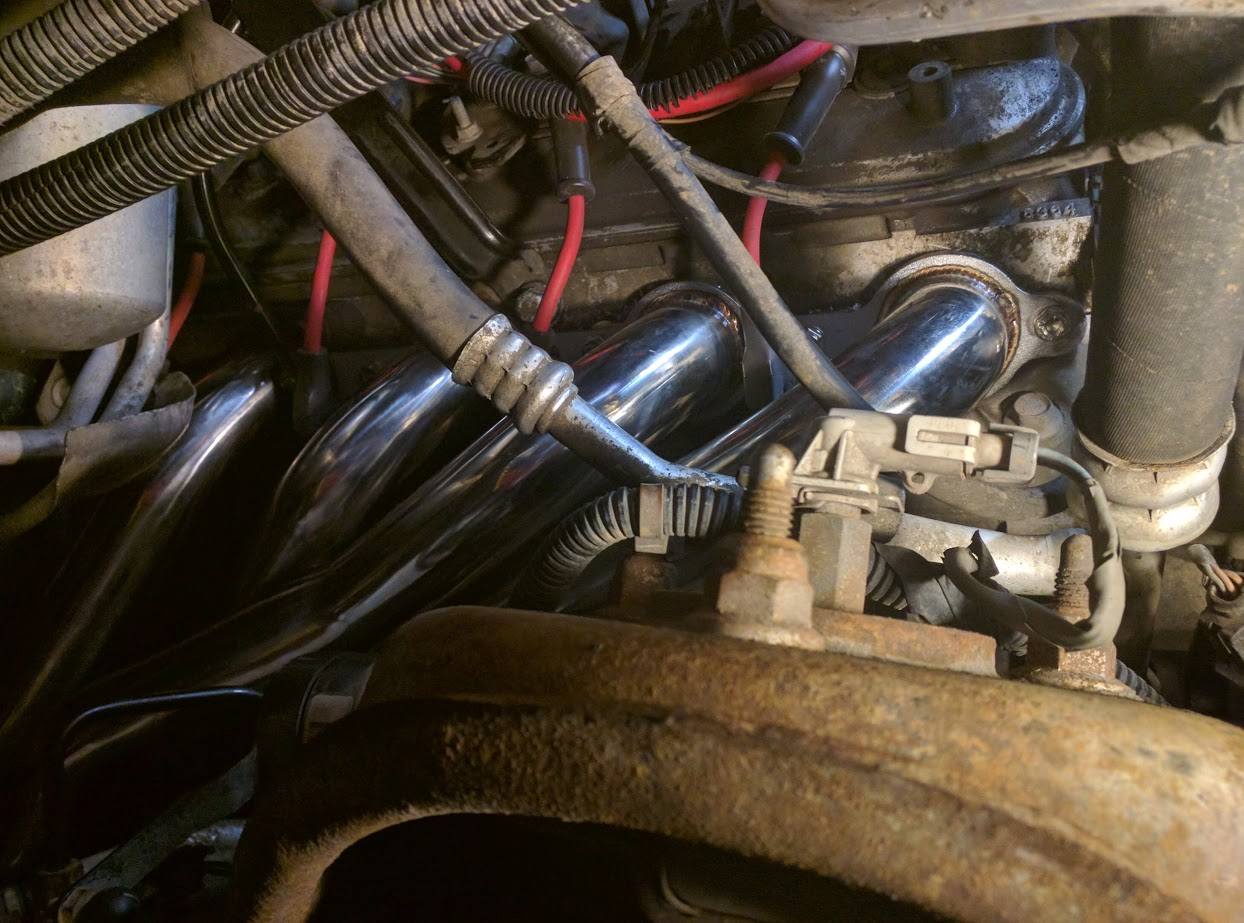

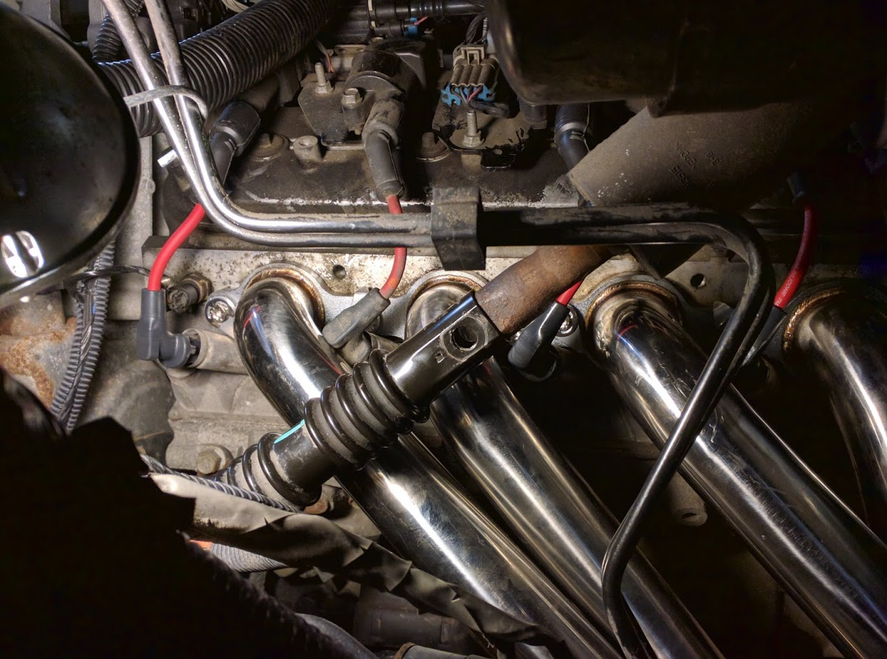

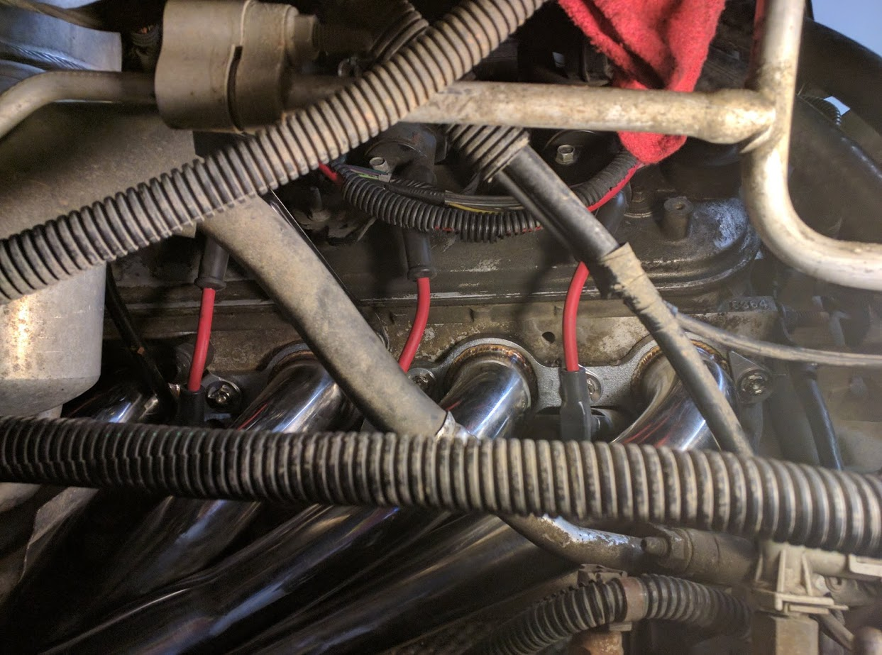

Question: I have 1 spark plug wire that touches the header no matter what I do. What do? Heat shielding? Custom short wire?
Spark plug is fully seated. I tested. 2nd from left.

I wrapped some aluminum foil around the touching spark plug wire.

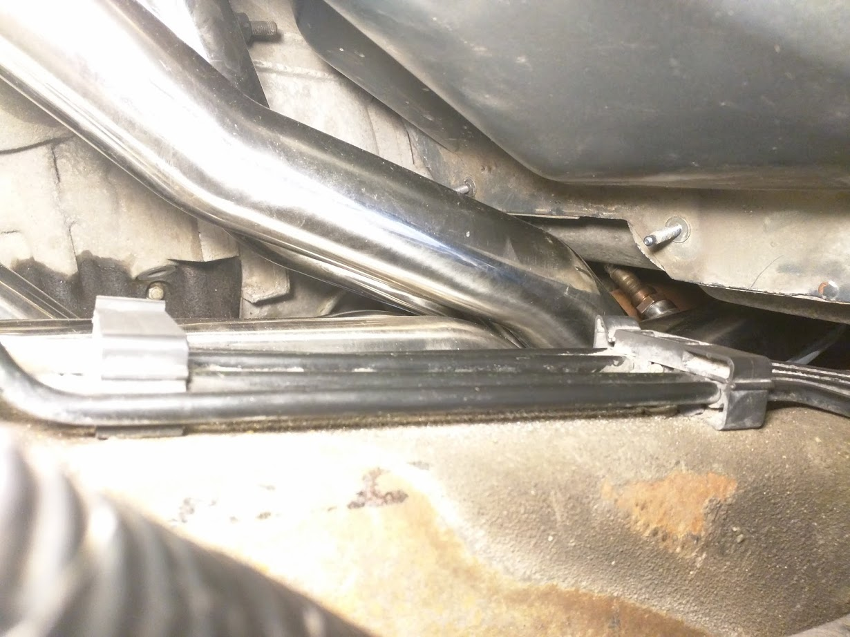

I need to adjust the passenger header as the O2 sensor is hitting the under body. THEN I can drop that ******* cross member.

prob going to have to get a different set of wires, i had the fiberglass sleeves on mine and even with those it burnt through the cable inside them, msd makes a set that the boot can be formed and keeps them away pretty good, i got the set "for trucks" and they're long as shit i actually have the 45 off the coil pointed up on some of them.
driverside o2 sensor - make sure you tyrap the cable going to it up and tight, mine fell and rubbed thru on the front driveshaft

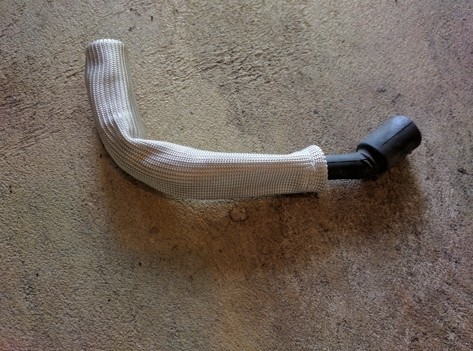

Got this from advance Auto. Hope it works!

Aligned the headers and now the O2 sensor doesn't hut the body. It's close though.
Trimmed the wire boot.
Slips on snug
Fits ok. Used a zip tie to keep it from touching the header.
