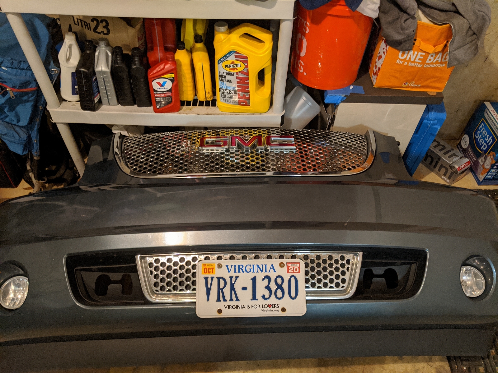

Congrats. I thought Va put their stickers in the bottom center of the windshield?

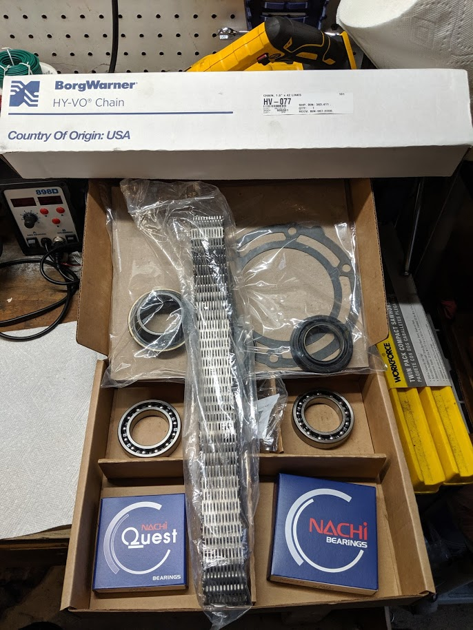

Got a rebuild kit for my BW4485 transfer case. Then I'll get a performance driveshaft.
Good bearings in this kit. NT and Nachi. Real BW chain too.

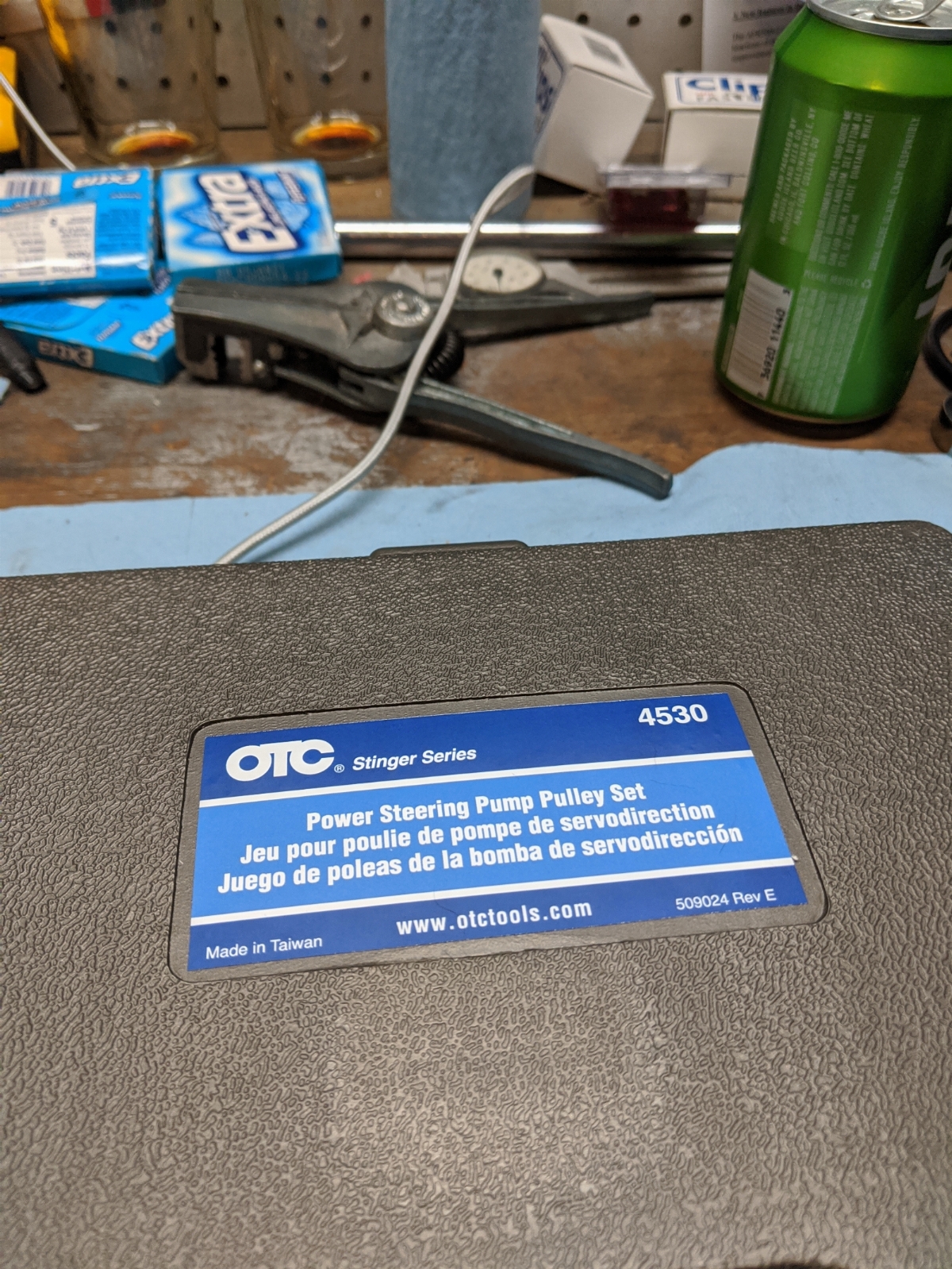

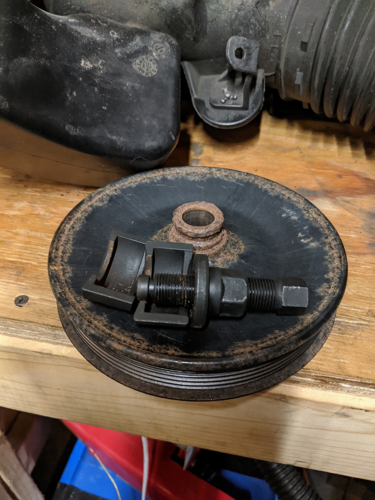

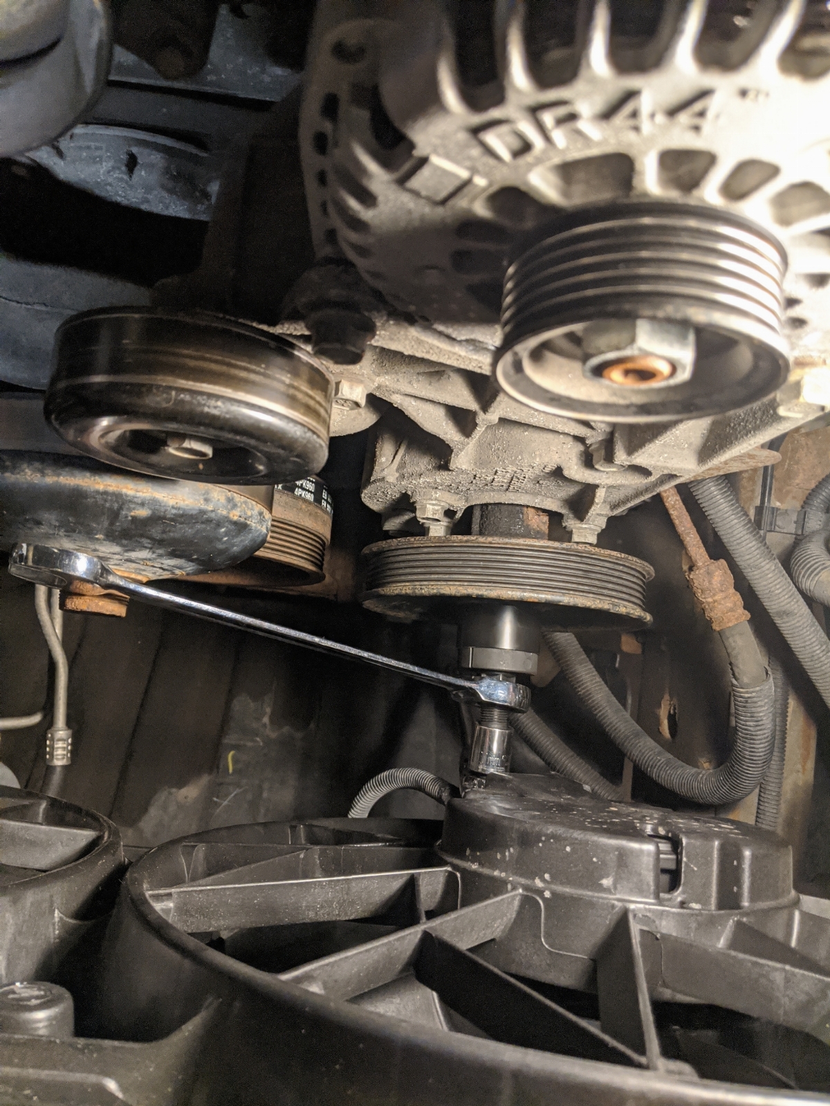

I am sure you probably already know this but when you reinstall that pulley, make sure you get it lined up perfectly with the other pulleys or you will end up with a belt that squeals and it's hard to diagnose... it only takes being off by a hair and it will drive you nuts.

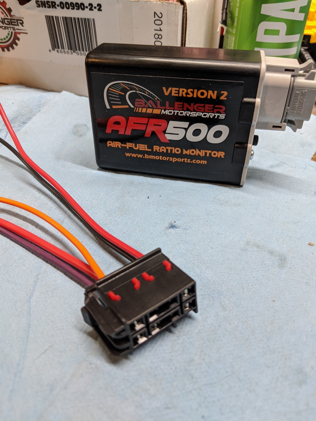

I know I'm jumping around a bit but I FINALLY, after a year, found how I want to wire in my wideband. The last piece is a MBEC (box by driver's feet) connector that more easily makes accessible, ground, ignition signal, and 30 amps of power.
I'll finish power steering this weekend but am excited to finally get fueling properly dialed in.
I'll make a how to.

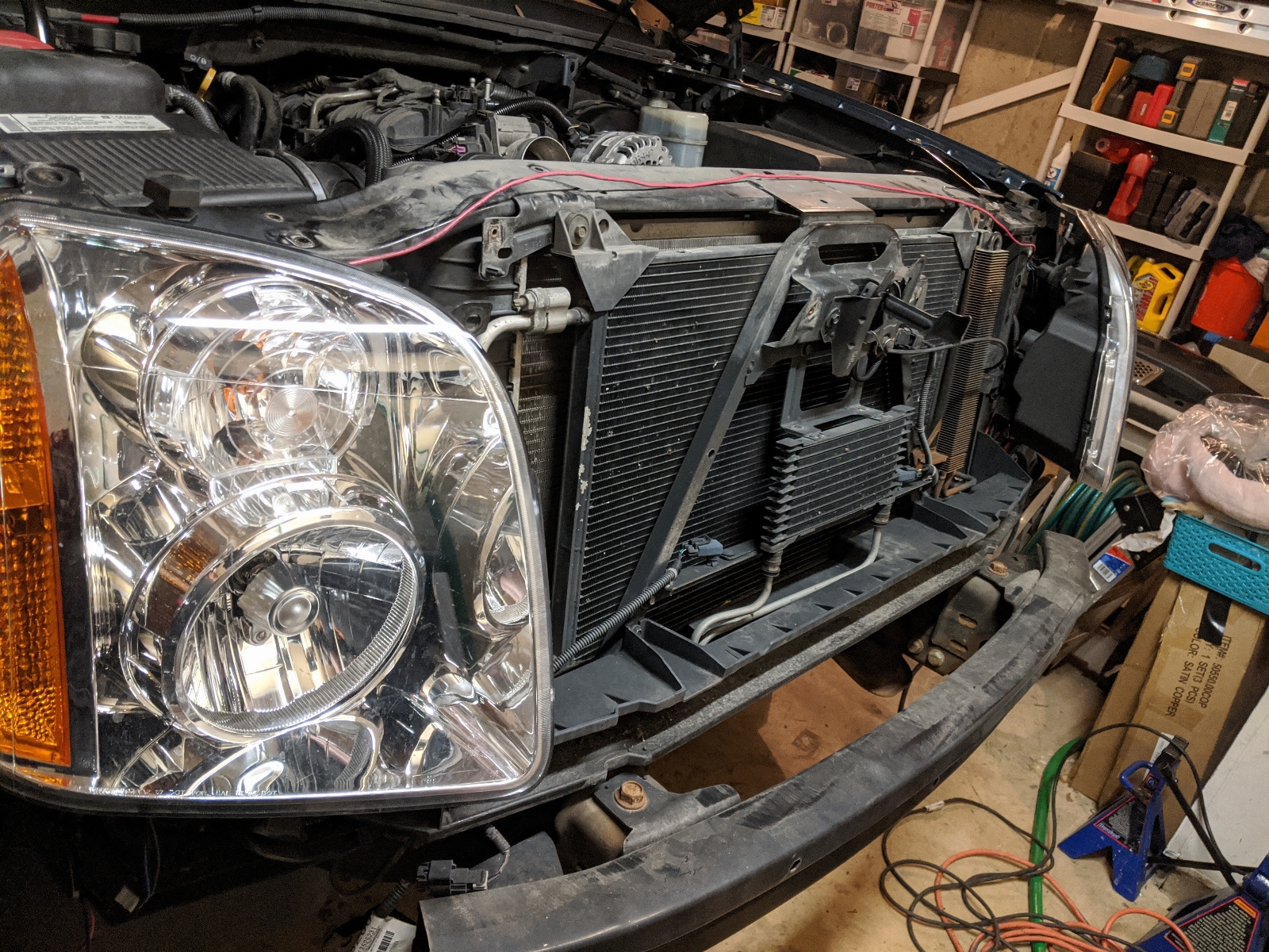

I need two other lines to the steering rack. Crap.
Also, do I just take care of the oil pan seal now? Drop diff, blah blah blah. Then pickup tube seal? Then camshaft. Then then then....

looks like a perfect place for them to fight....why should they do it somewhere ya know....convenient?!
i feel ya on the pan leak...and then this and that etc etc

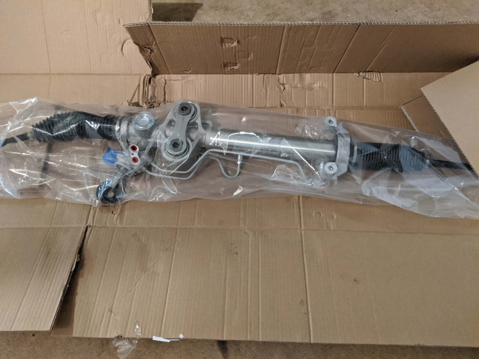

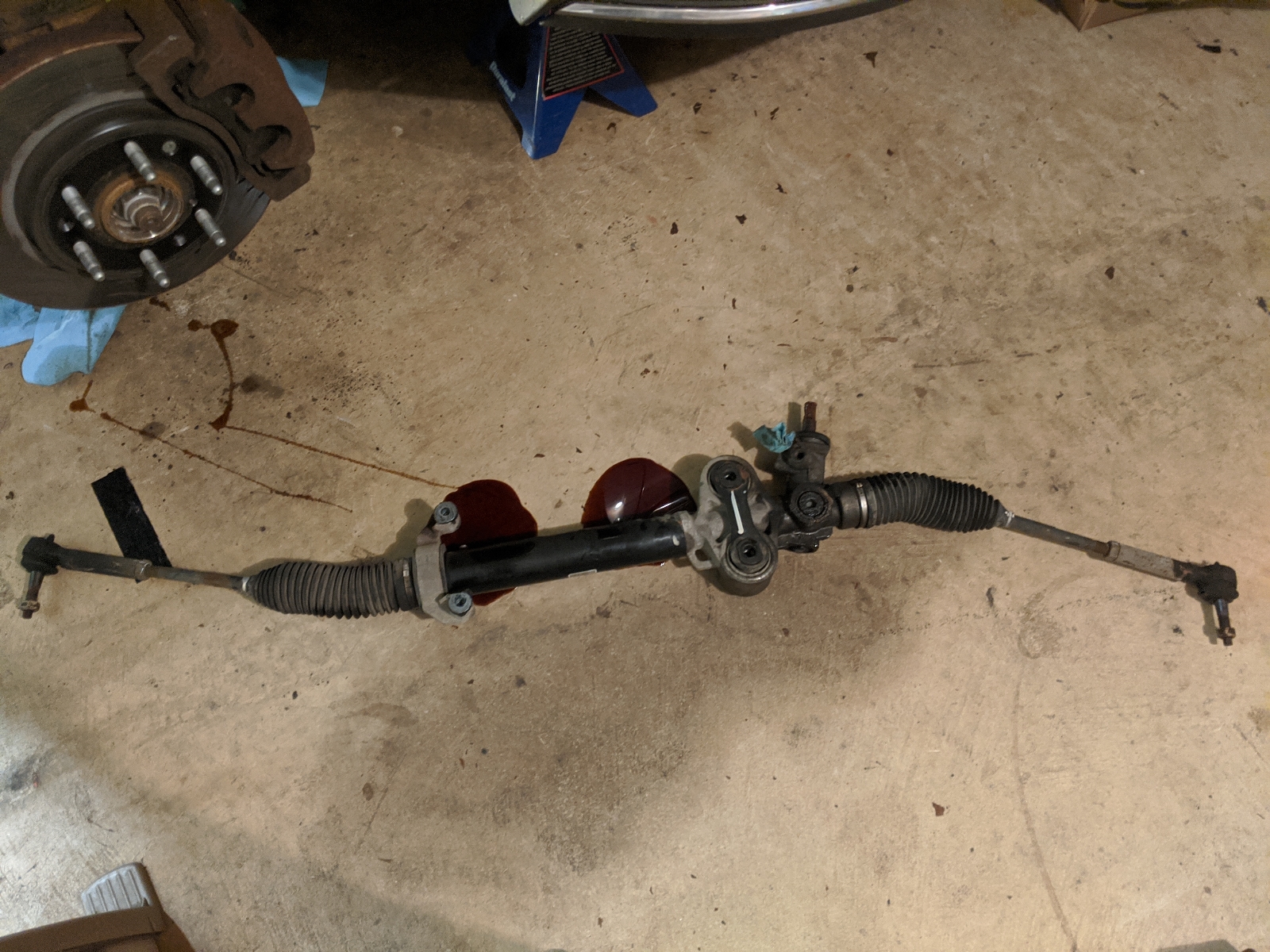

Damn. The steering rack is f*cked. One of the old lines snapped off inside. I can either spend time trying to drill it out chancing getting crap in the lines and killing the new pump.
Or I can replace the 170k mile rack.
$$, ouch, but I'll replace.
I'm soooo blessed to have another car to drive around. This will take a while.
EDIT: Ok if the rack is coming our then I'll drop the diff and see what I can do about the oil pan gasket. This small project just got big.

Wow, new one just arrived. I've used a number of 1aauto vids to learn stuff so I tried them for parts this time. Fast shipping. Looks nice. General part. Lifetime warranty. We will see.
