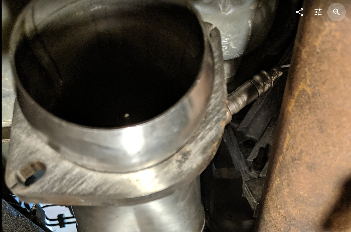

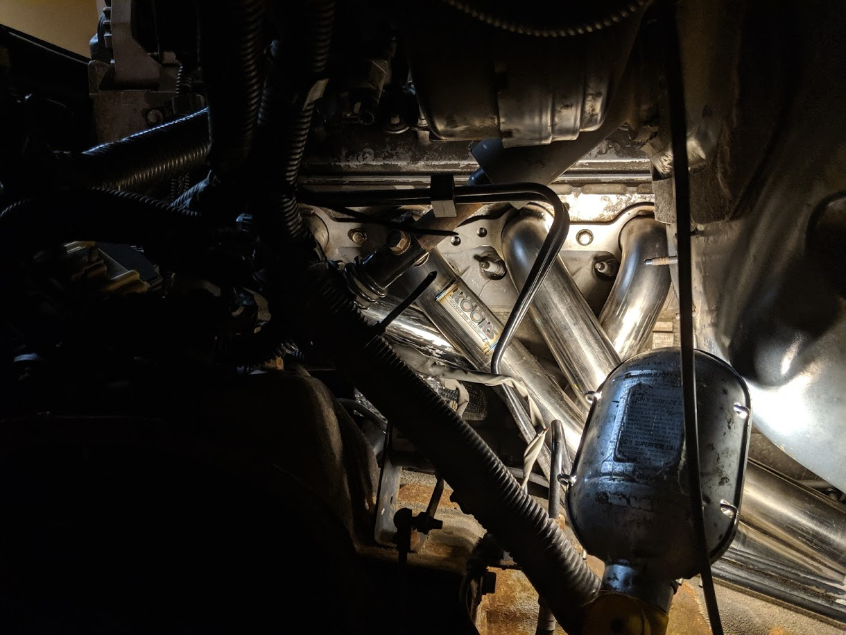

My guesstimate on where the wideband sensor needs to go was spot on. Tons of room above the driveshaft.
I also found a probable cause to my exhaust leak and pissed off O2 readings. I dropped and didn't install the metal donut gasket to the manifold on the driver's side. Oops.

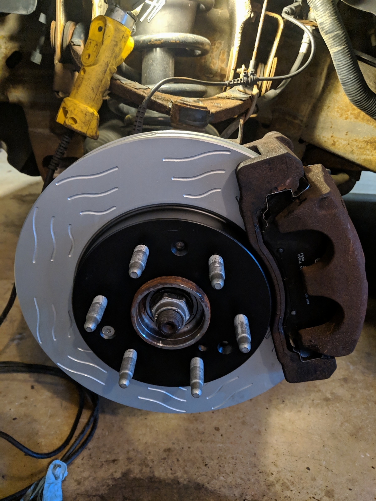

So I tried quality ac Delco rotors and pads. They made it a little over a year before getting warped.
This time im trying raybestos rotors and Bosch ceramic pads. I hope they last longer.
if you don't want them to get warped, don't drive threw water then when they are hot..

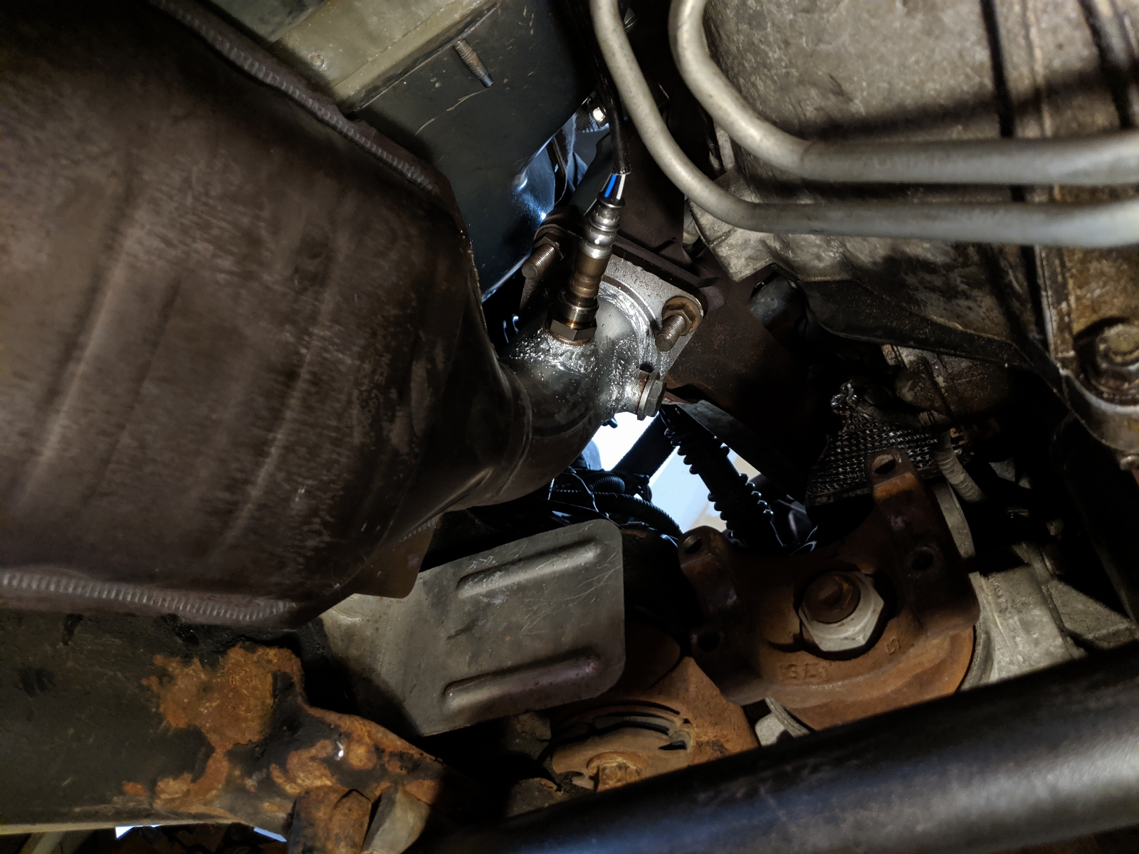

Turns out the upstream sensor I installed was from my old gmt800 Yukon. Not compatible. CEL thrown.
95F and %100 humidity today, but fixed. Ick, those welds!

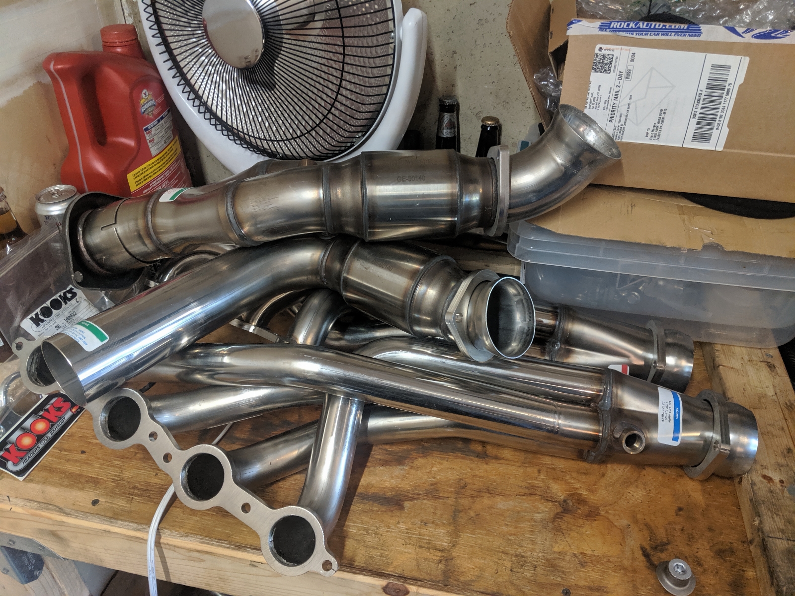

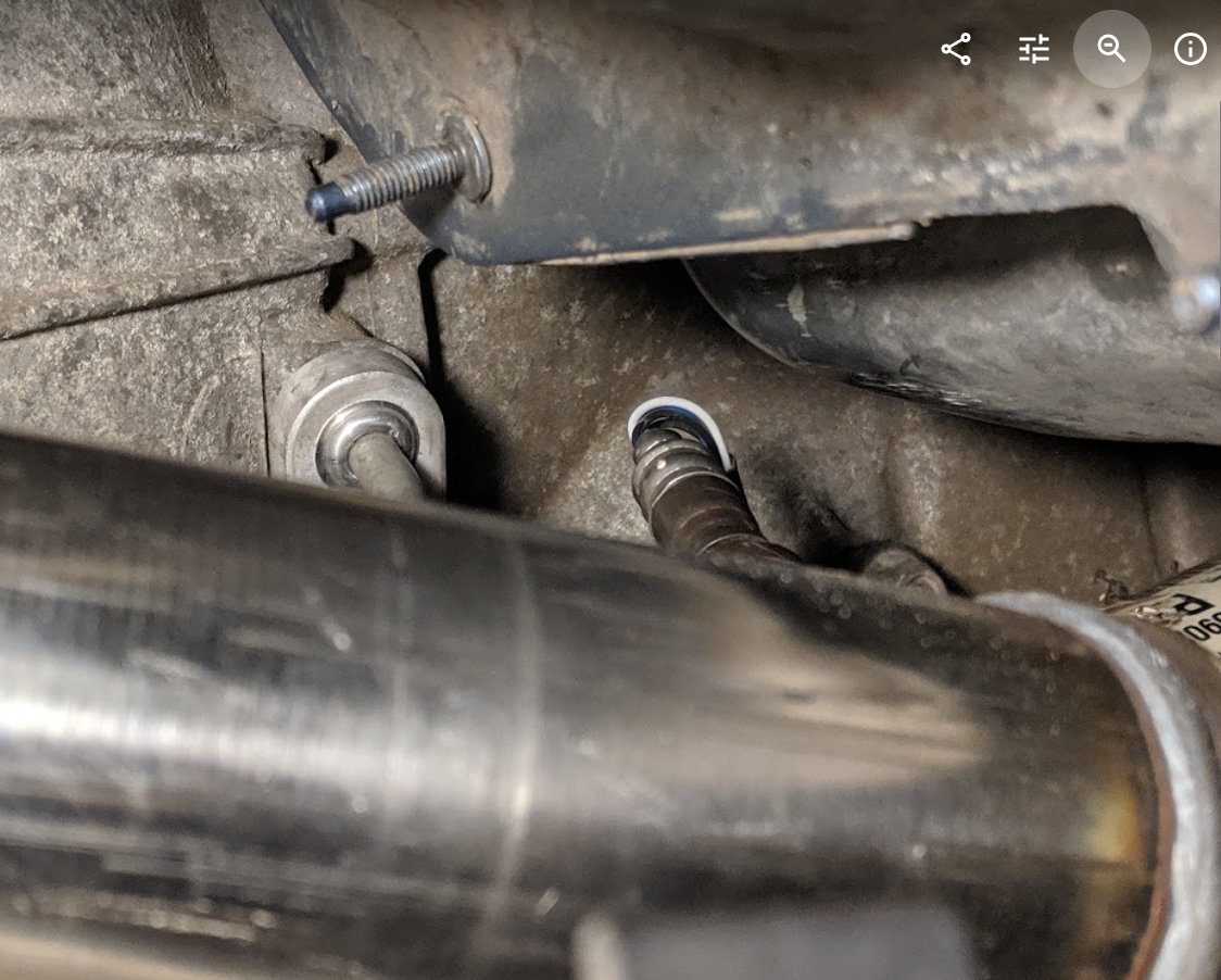

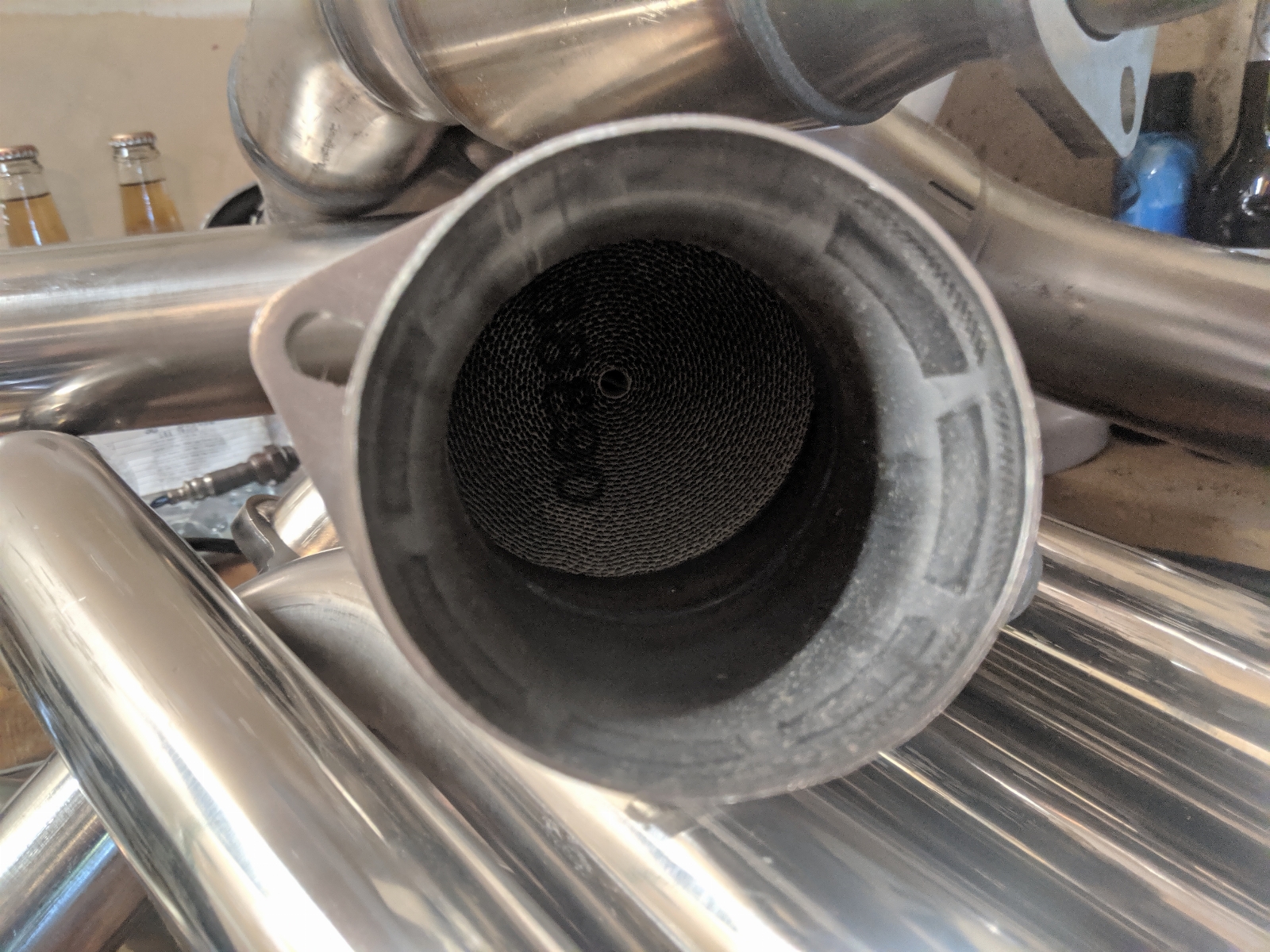

Testing fitting the headers. I finally got the old stock ones out. Another O2 sensor stripped out. Sigh.
I'm concerned about the O2 sensor hitting the body like the speed engineering headers.

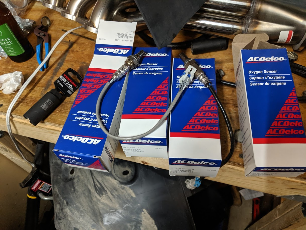

My full compliment of O2 sensors came in. I'm starting from scratch. All OEM. Maybe I'll be done in the next week?

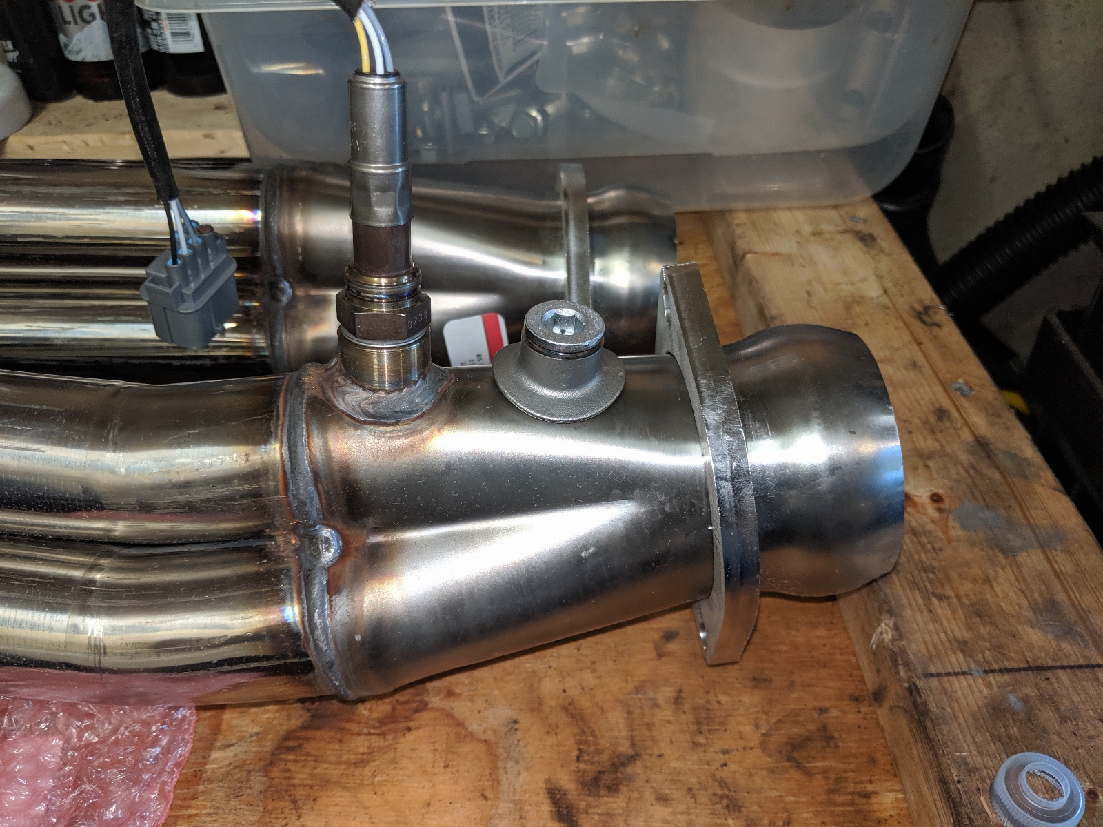

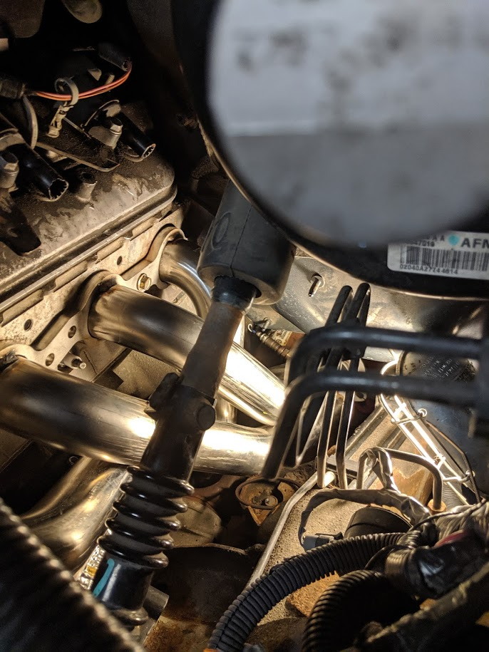

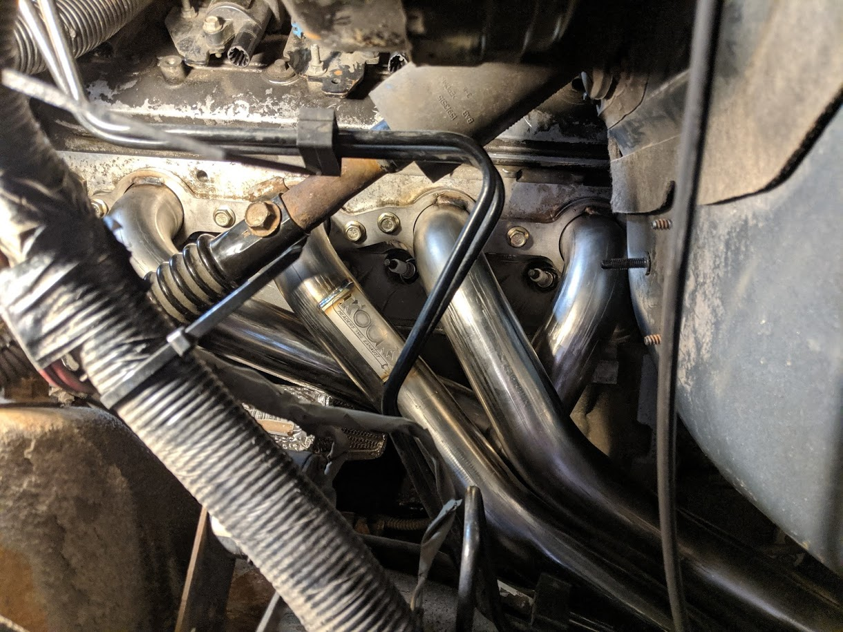

Drivers side header with new gasket and new o2 sensor in place. Not torqued...
I wish I had more than 30min every 3 days or so....
EDIT: To add. Unlike the speed engineering headers I did not have to remove the steering shaft with the kooks headers. :)

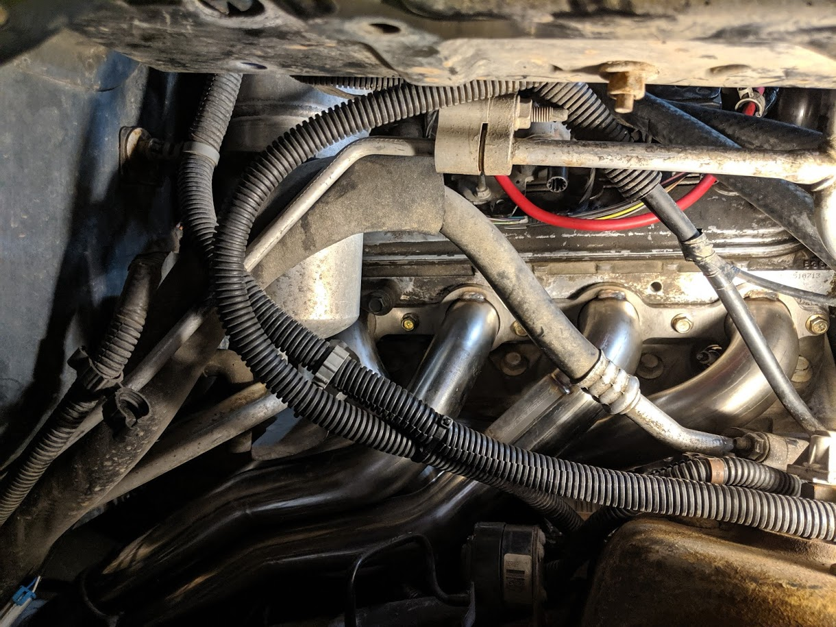

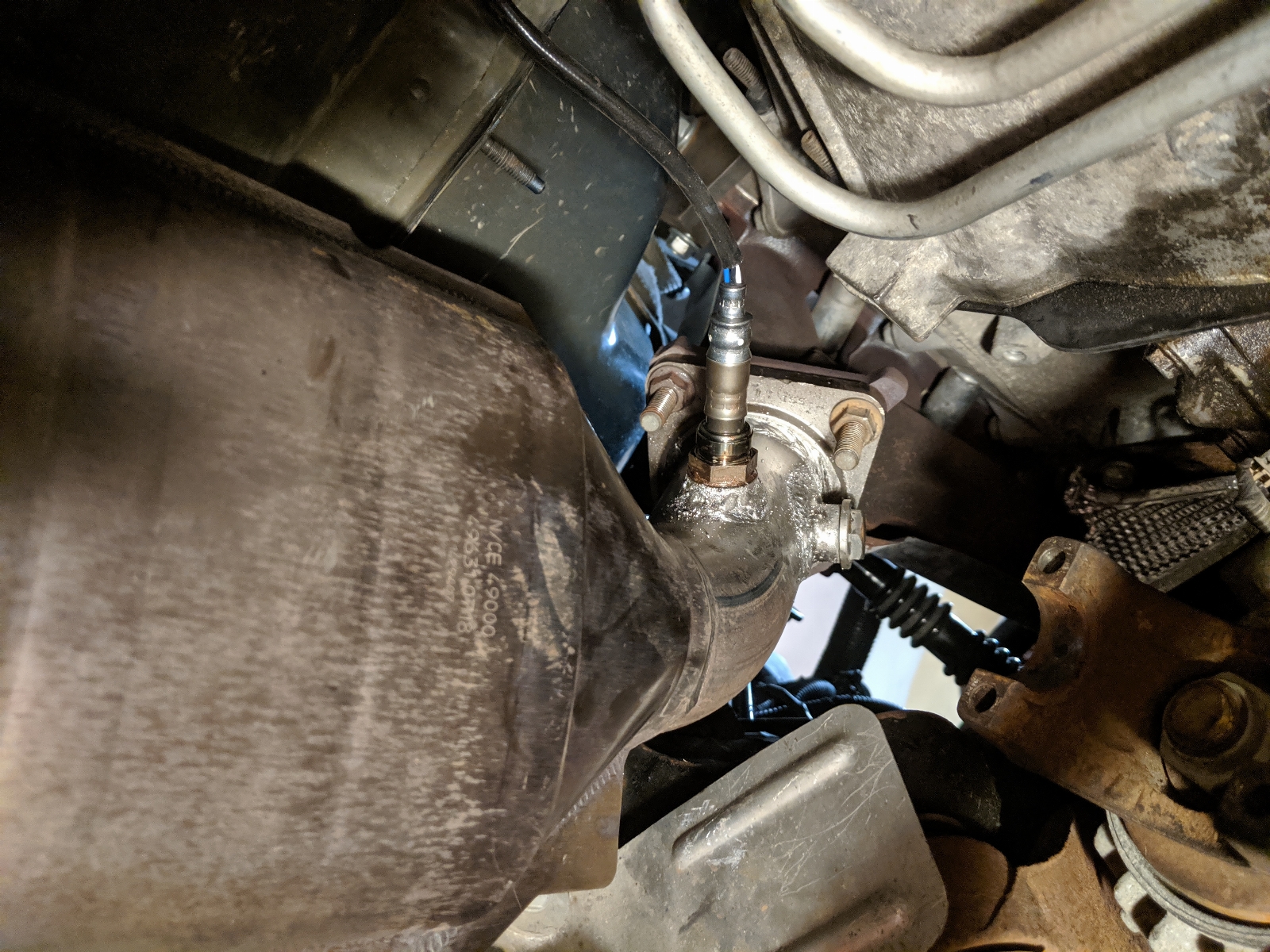

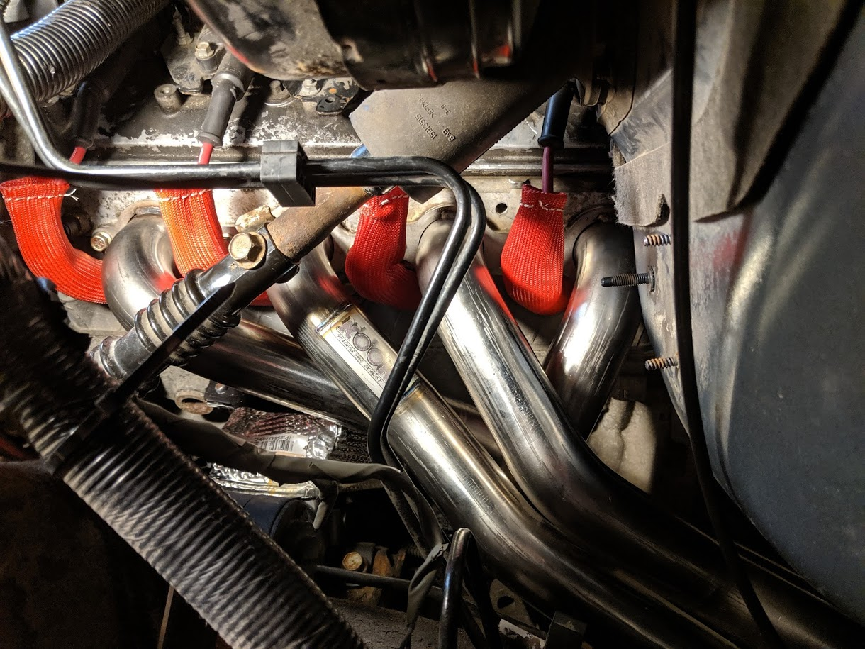

Got the passenger side in. Note that the starter cable needs to be moved and the upstream O2 sensor wire needs to be carefully placed over the header.
