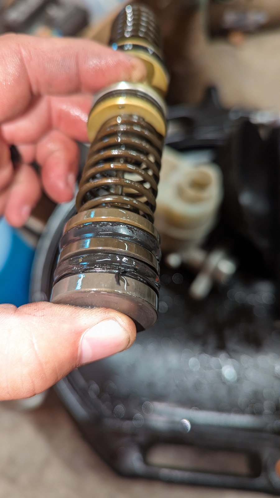

So it ended up being a bad master cylinder. I opened the old one up and the rear seal has a small tear.
