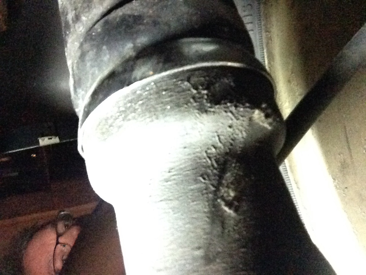

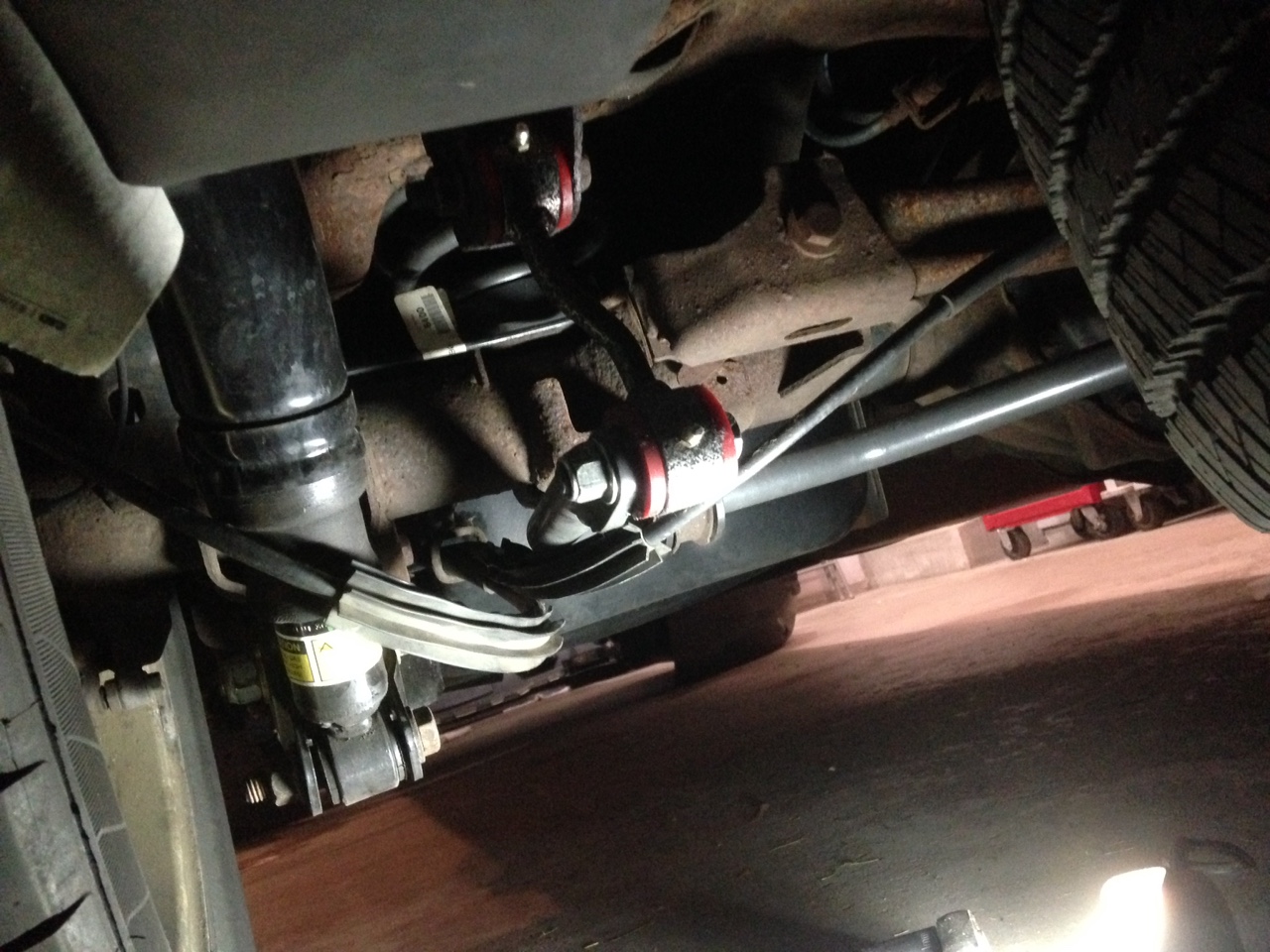

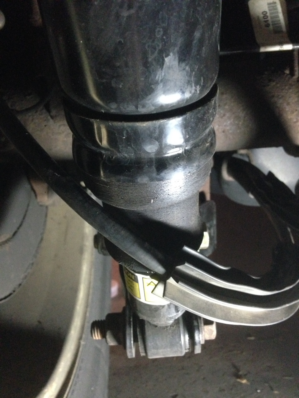

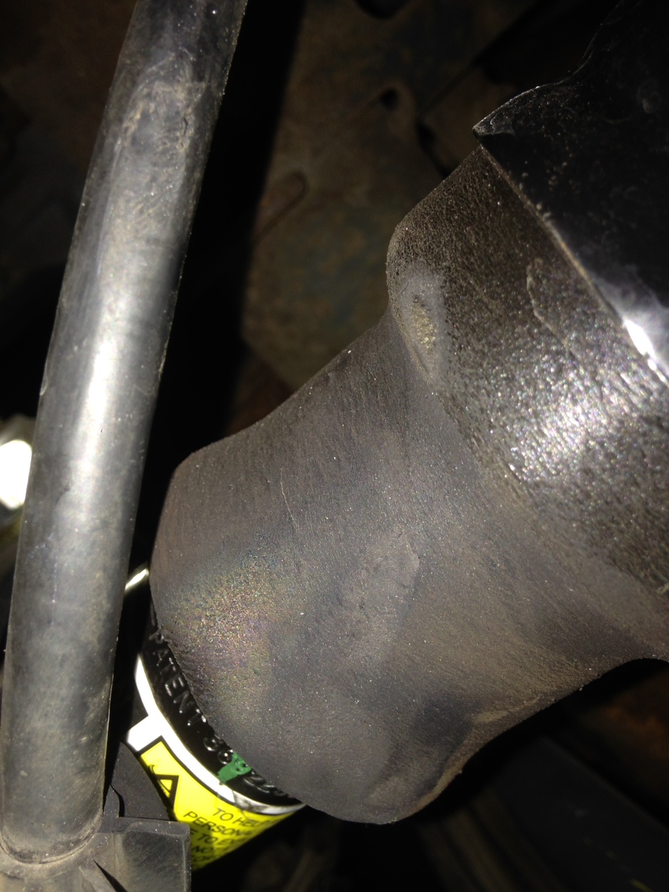

Installed the kit. Love it. I'm having a problem with the drivers side rear e brake line rubbing on my new Arnott air shocks. I've routed the line both in front of and in back of the shock and it rubs the air bag both sides. What have you done to correct this?

I tie strap mine to the bottom bolt on the relocated bracket. I think I took them out of the metal holder to get a inch more slack.

Heres where mine rubs:
