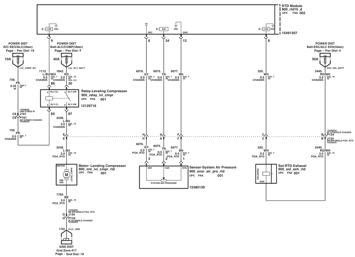

If the relay works and activates the pump, but does not work in the harness, then I would check for
power on 85.
ground trigger on 86.
Or perhaps the pressure sensor or module is bad?
For the leaking part, is that an exhaust solenoid to release pressure?
power on 85.
Hi, where did you get this wiring diagram from? I have been trying to find a good factory service manual but have been unable to find anything yet.
