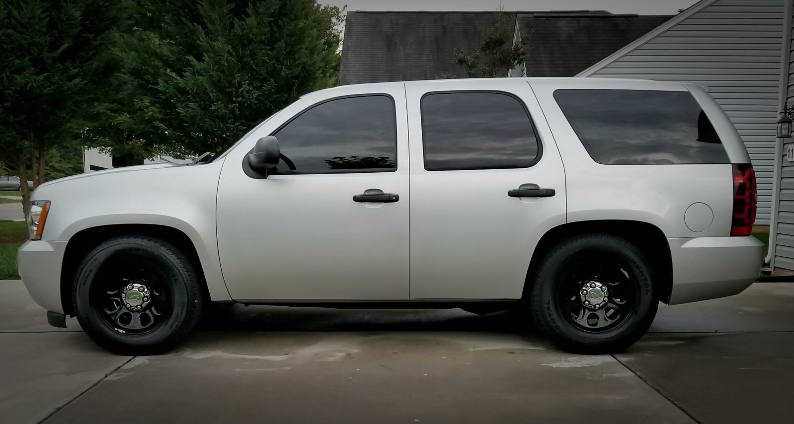

I have the Belltech 752SP kit from Tony, it sits about 1" lower up front and 1.5" lower out back than a stock PPV with the 265/60/17 tires. I'm not worried about the centering of my rear axle enough to buy the adjustable LCA's for the back, its not a goofy amount 'off'. Any lower and it would be more pronounced, IMO. If you are going with spindles, I assume you looking to smash some ants. In that case I wouldn't skimp out on upgrades, especially if it is going to effect the geometry. Any of his customers will vouch, @NORCAL SS will not lead you astray though, let him know what you want to achieve and he'll shoot you straight on what to put on the truck.
