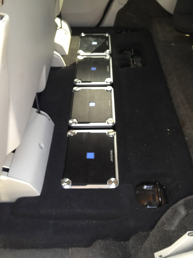

- Ipad 3g $850
- Audiocontrol 3.1 $260
- 1-Alpine PDX4.100 $600
- 1-Alpine PDX5 $600
- 2-Alpine PDX1.1000 $1200

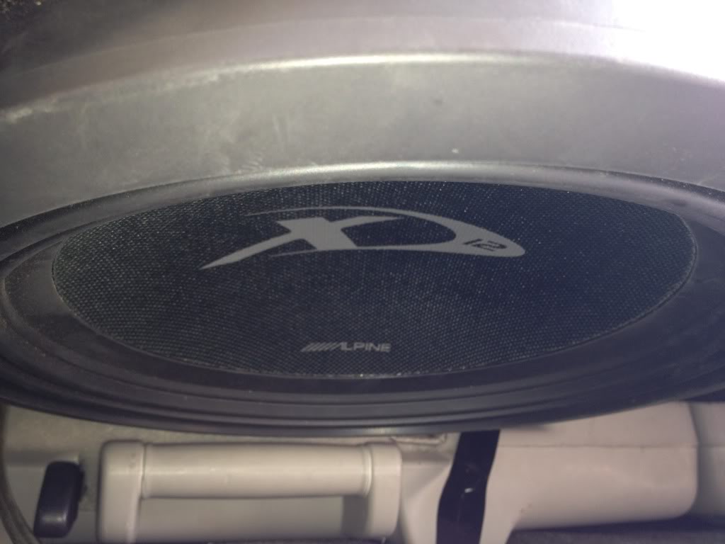

- 2-Alpine 12" Type-X subs w/ box $750

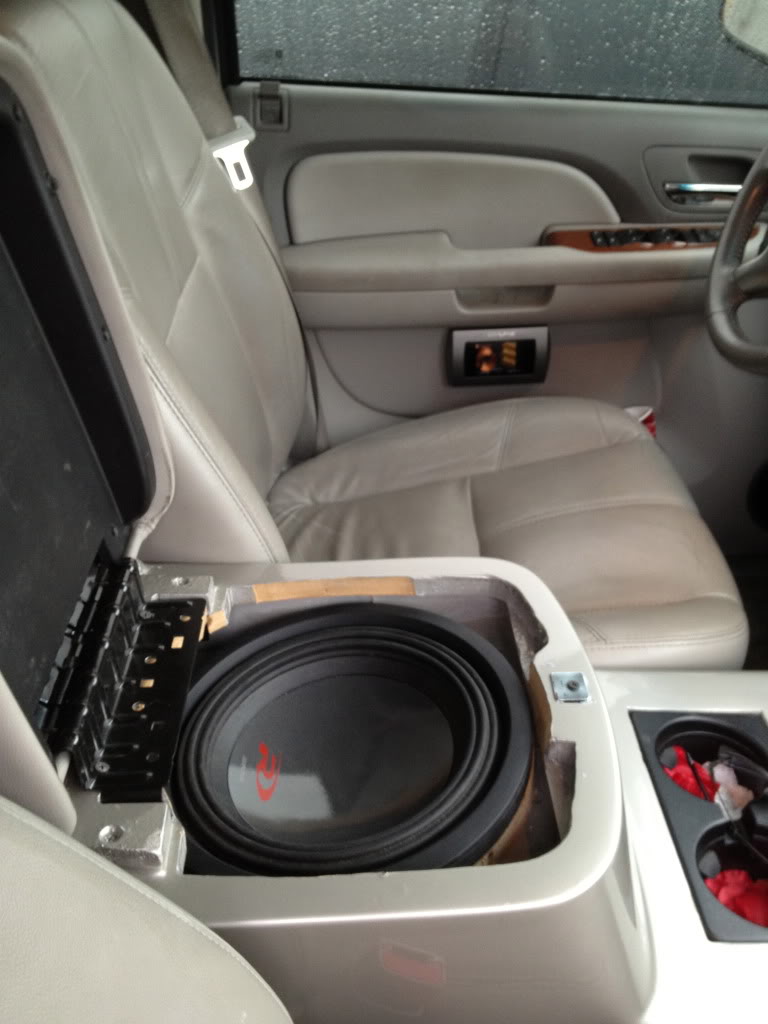

- 1-Alpine 10" Type-R sub in new center console $150

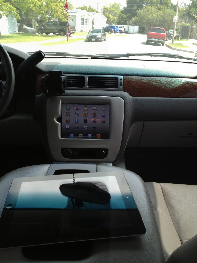

I snapped up a quick picture today

Is that painted to match your lower trim, or just bondo? Looks like it sticks out a good bit.
50,933
19,327
Nice!!! When you decide to get a new iPad is it easy to swap in a new one or would a bunch or "re-fab" have to be done to accommodate the newer iPad? :)

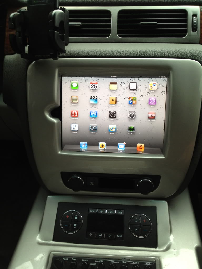

The bezel is painted to match the center console, which is the same as the truck exterior color. It sticks out very little, but I will try getting some side shots. Unfortunately I now need to redo the bezel to match the new iPad 3. It is thinner and does not make good contact with the connector. That will give me a chance to do things a bit cleaner next time.

Easy. I got the dock cable from apple store that has a set of audio/video RCA's along with a USB for charging. I hooked the audio-outs into the Audiocontrol 3.1, which splits to Front/Rear/Sub. I took the video out to a video splitter box, which splits signal out to the 2 headrest monitors. The power is picked up in a cigarette lighter in the console, using Belkin's Ipad charger.
The install will not work to my full desires until the jailbreak for OS4 is out. This will allow for better video and audio distribution options, and hopefully a bluetooth remote control.
