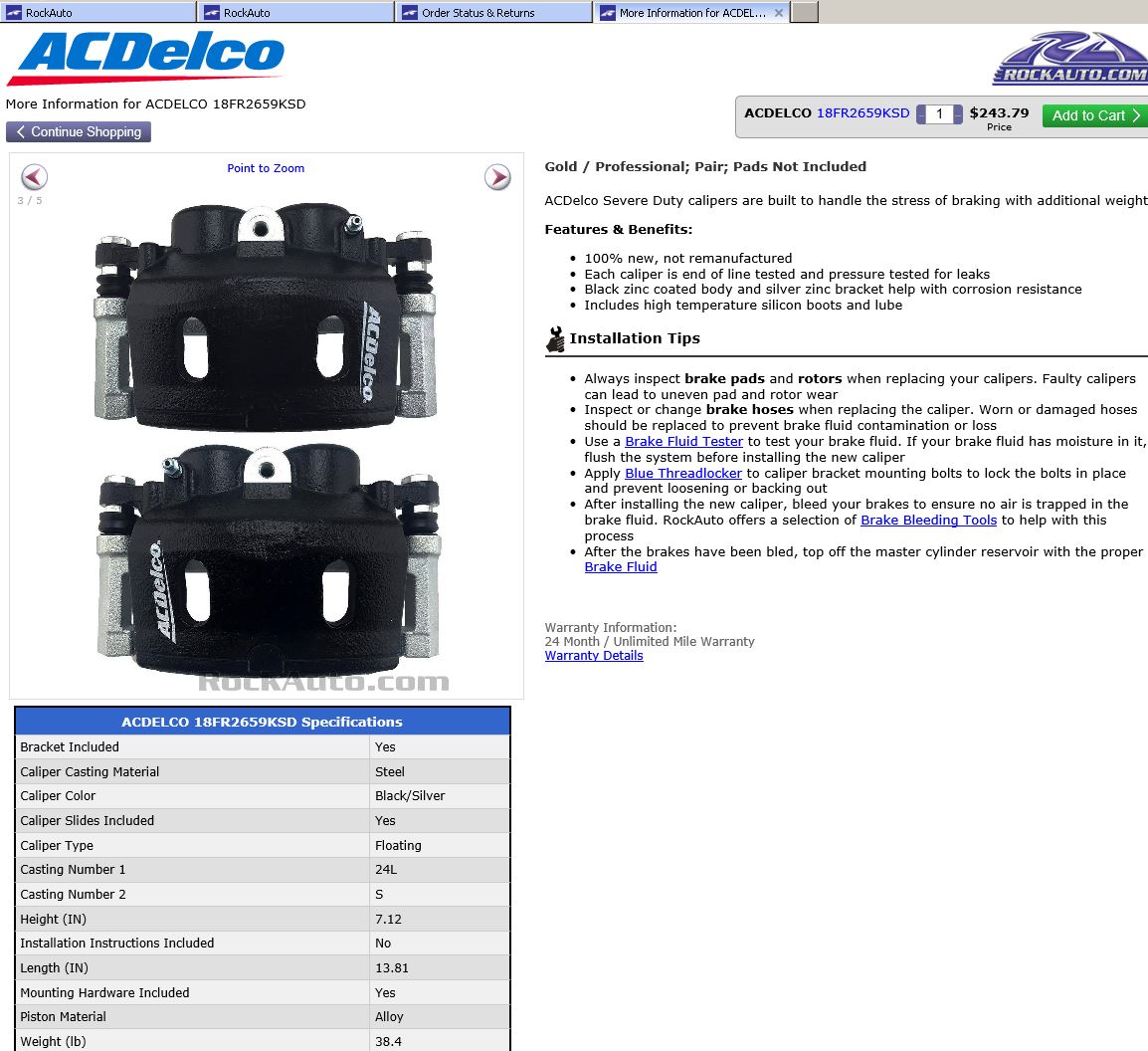

get a set of these, they have worked great for me
