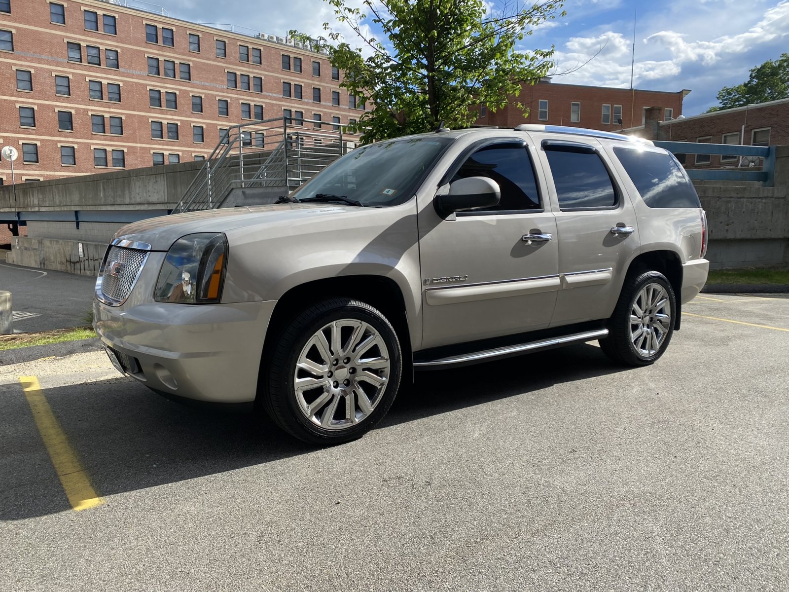

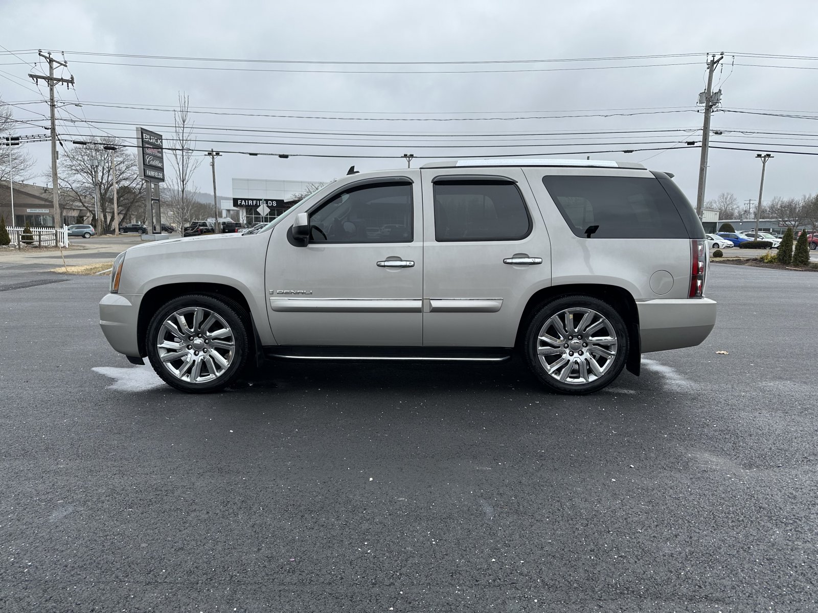

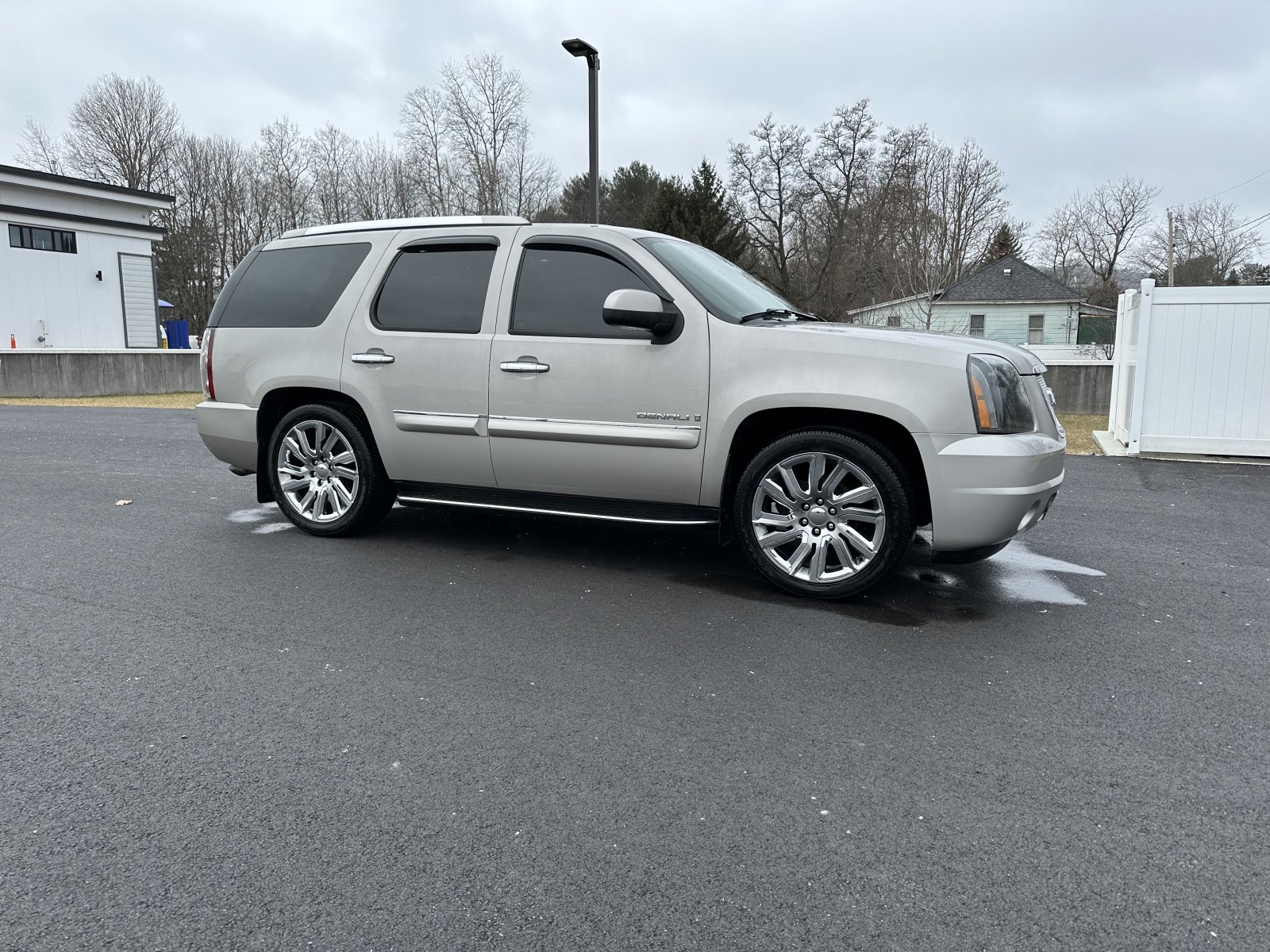

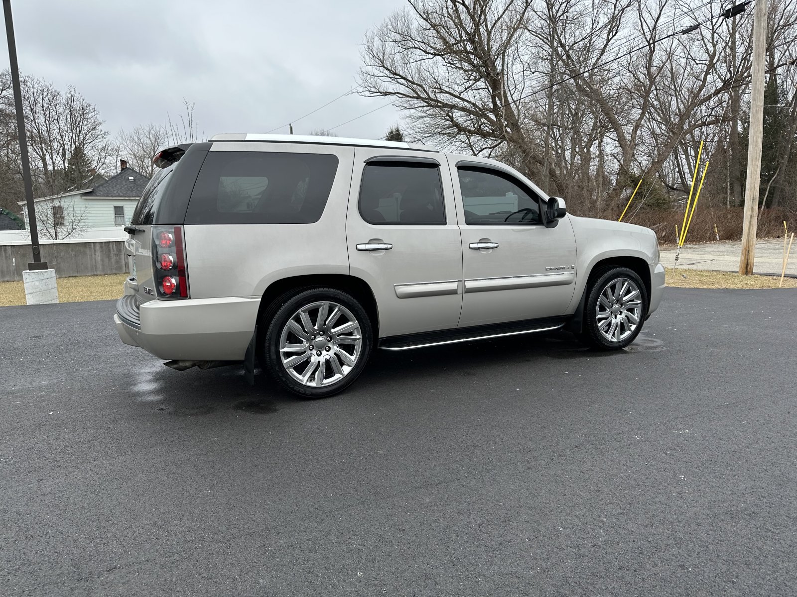

Hi everyone! I’m pretty new to the forum here. I recently installed the Belltech 753 2/3 lowering kit. I installed the coil spacers provided. This is supposed to make it 2/3 vs the 2/4 without any spacers. I think it’s squatting more in the rear (very slight) than what I’ve seen or would’ve expected. I was hoping with the spacers it would perfectly level it out or give it a very very slight rake. Can anyone shed some light on this? I’ve contacted Belltech and they weren’t a lot of help. I might be giving them another call. Any help would be appreciated!

I wish I would've measured all four corners before; the front doesn't seem to have dropped the full 2" either. I might be over analyzing, but I am admittedly a perfectionist LOL

Not measuring before is a bit of a peeve of mine. I found that the McGaughy spindles actually drop 1.75" and not 2". Also, I was doing a lot of experiments with mine, so I needed solid baselines.
I was about to say that yours looks kinda stockish in the front. Does yours have a functioning ALC ("air ride") in the rear? You could swap the Belltech spacer for a thicker one, like a 2". They're fairly cheap on eBay and Amazon.

Thanks for the input @iamdub . Here’s a shot before the drop. It’s noticeably dropped a good bit front and back. I think I may have an issue with the rear air system.. No suspension codes but the rear bags seem to not be holding air. I thought the air was only supposed to adjust height with load, not assist in its normal ride. I guess not. Time to test the system

After comparing that to your other pic, I can definitely tell it's lowered. I forget how high these things are when stock! I agree- it doesn't look quite like 2". Does yours have air in the front? I can't recall if that was an Escalade-only thing or an option on the Denali.
The rear ALC is for leveling (Automatic Level Control) when loaded down. It does keep a minimum pressure in the bags, around 5psi, so the bags maintain their shape and as a supplement to the base load capacity. The coil springs for the ALC-equipped models are slightly softer so that firmness added from that base 5psi in the bags equals a "normal" ride quality. This 5psi tends to raise the rear around 1/2". At startup after sitting, the compressor runs for a few seconds to pump up the bags and then the exhaust cycles as part of a systems check procedure. If the bags are leaking, the compressor will be cycling on and off as you're driving. In time, the leak(s) get worse and the compressor runs more, eventually burning up.
