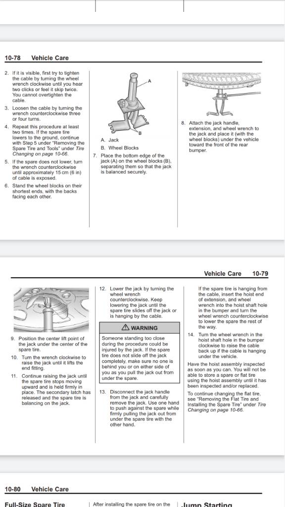

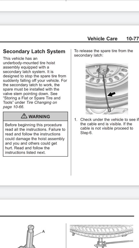

Have you tried this proceedure....

It took two of us 1 1/2 hours to get mine down. Finally after letting the air out of the tire, and striking the hanger in the right place it released. The problem was finding the right spot and getting to it. A long screw driver and hammer worked in the end. After it was down I cut the safety tab off with an angle grinder. Now it comes down with no problem. I can’t imagine trying to do that on the side of the road.
