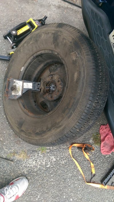

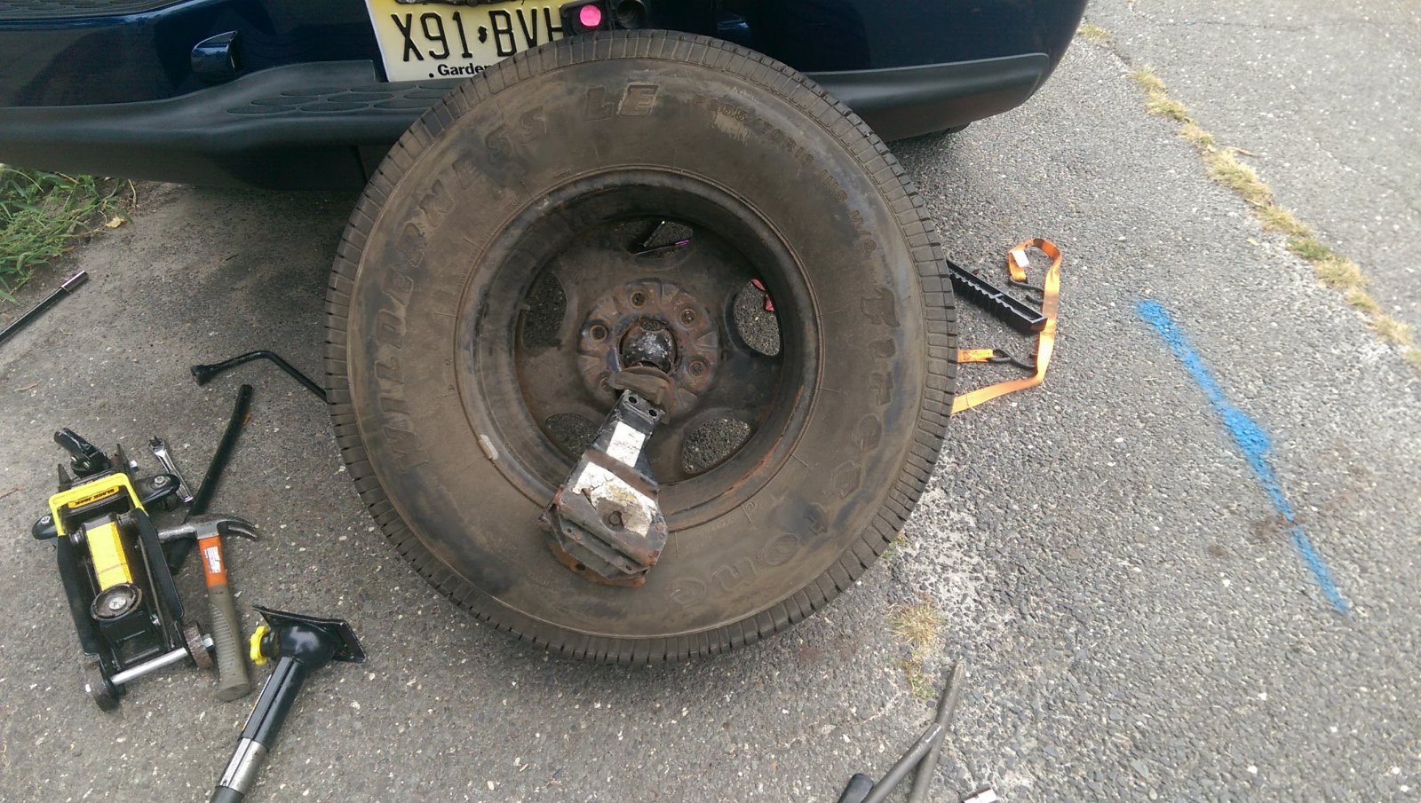

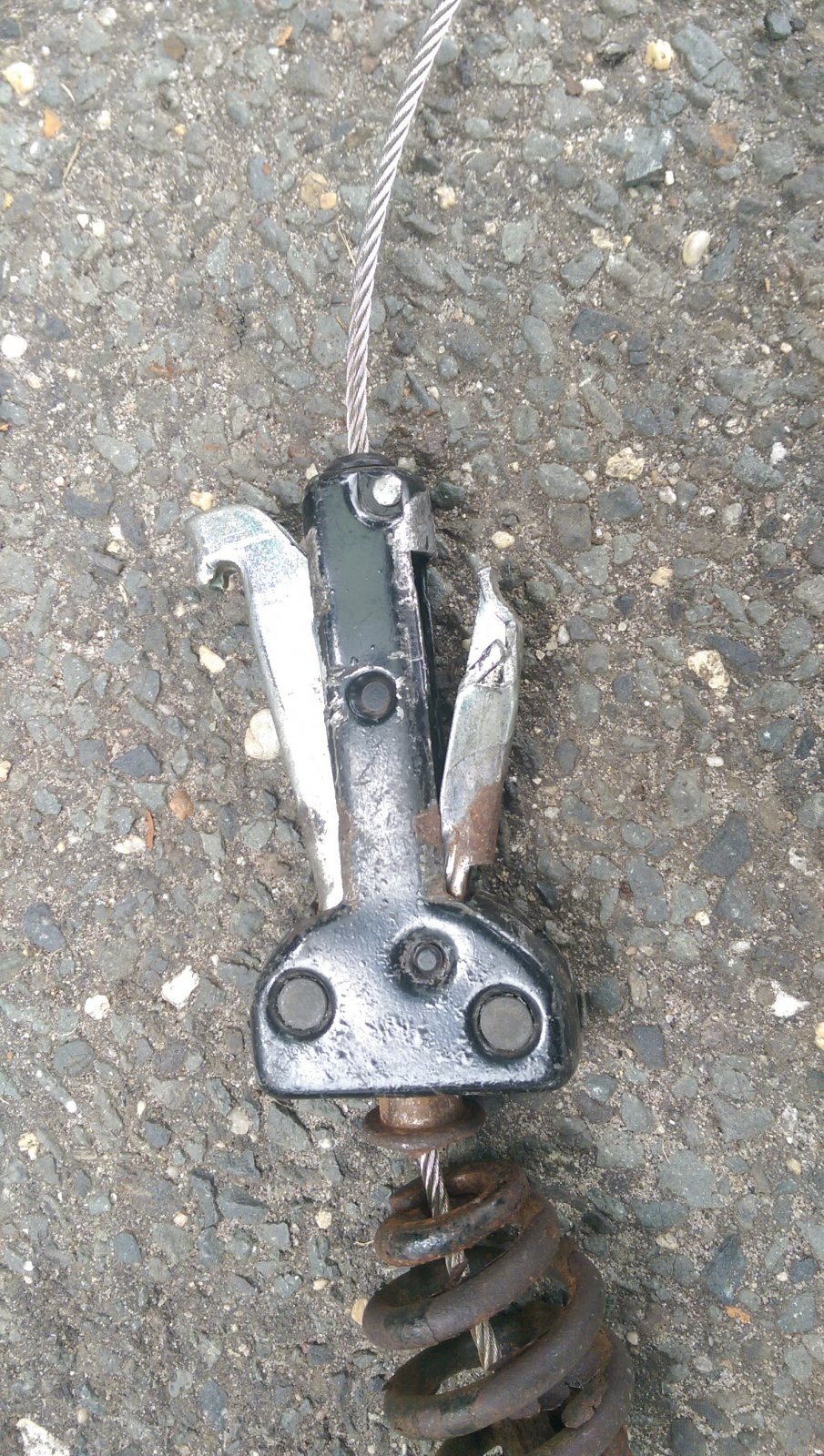

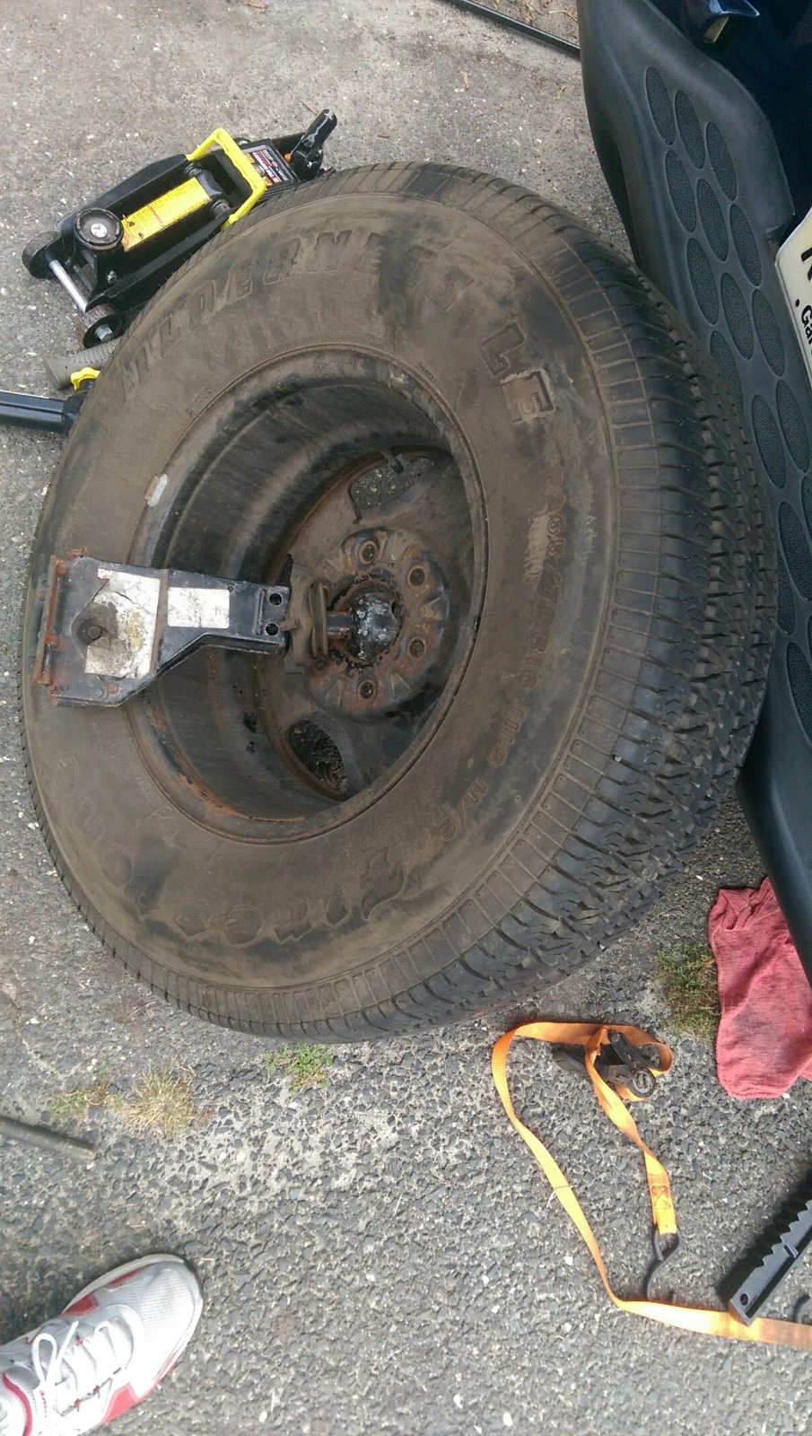

I had to bend the arm on the safety latch to get it to release.
