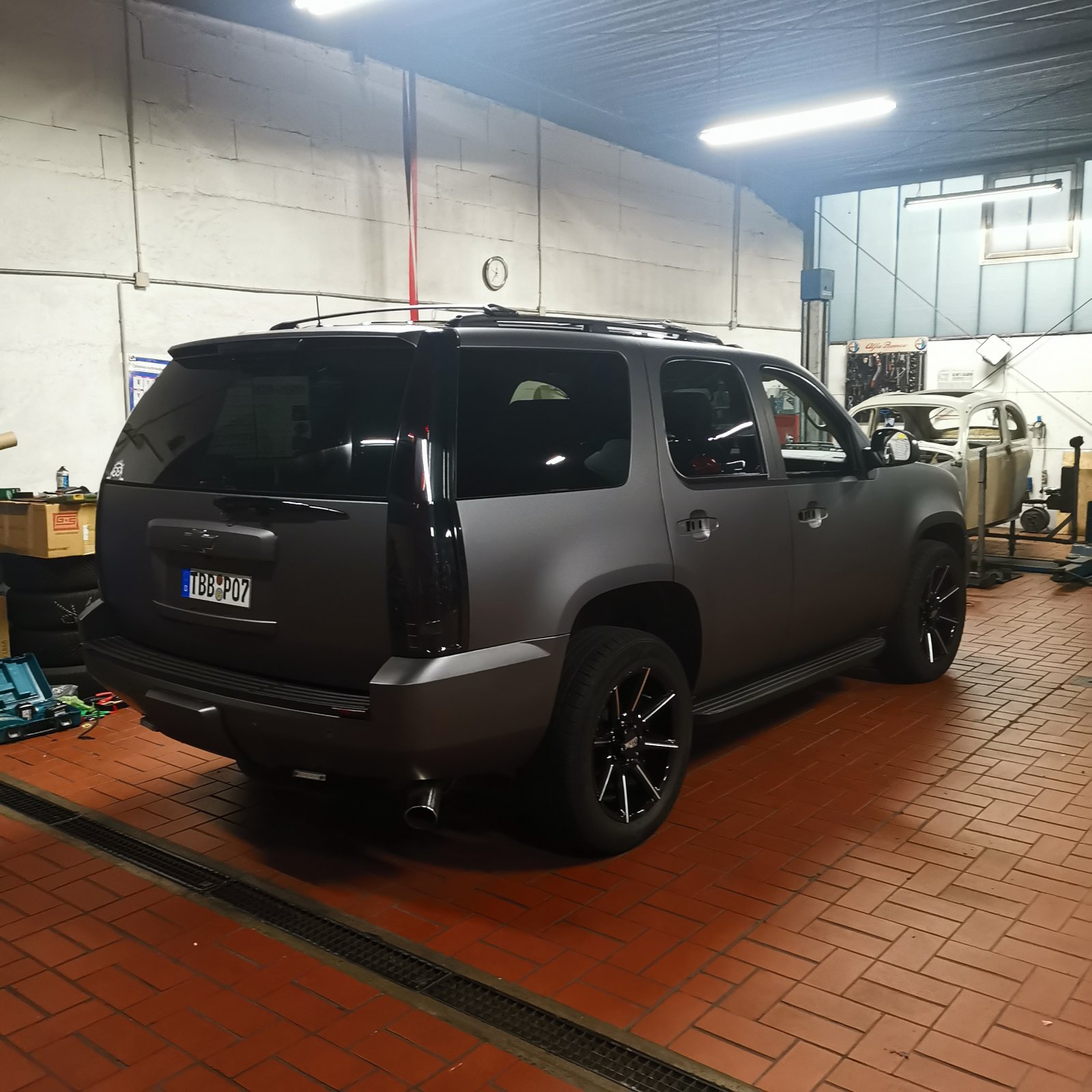

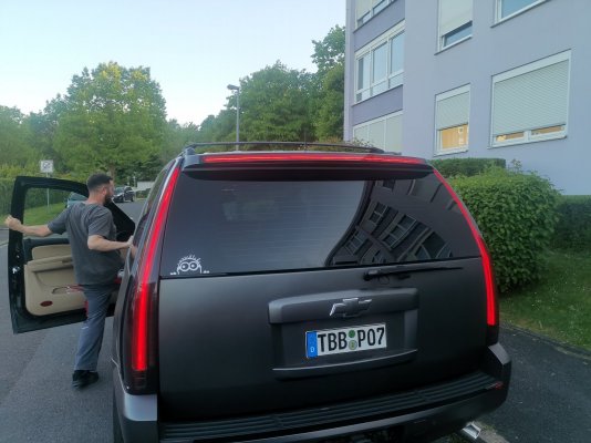

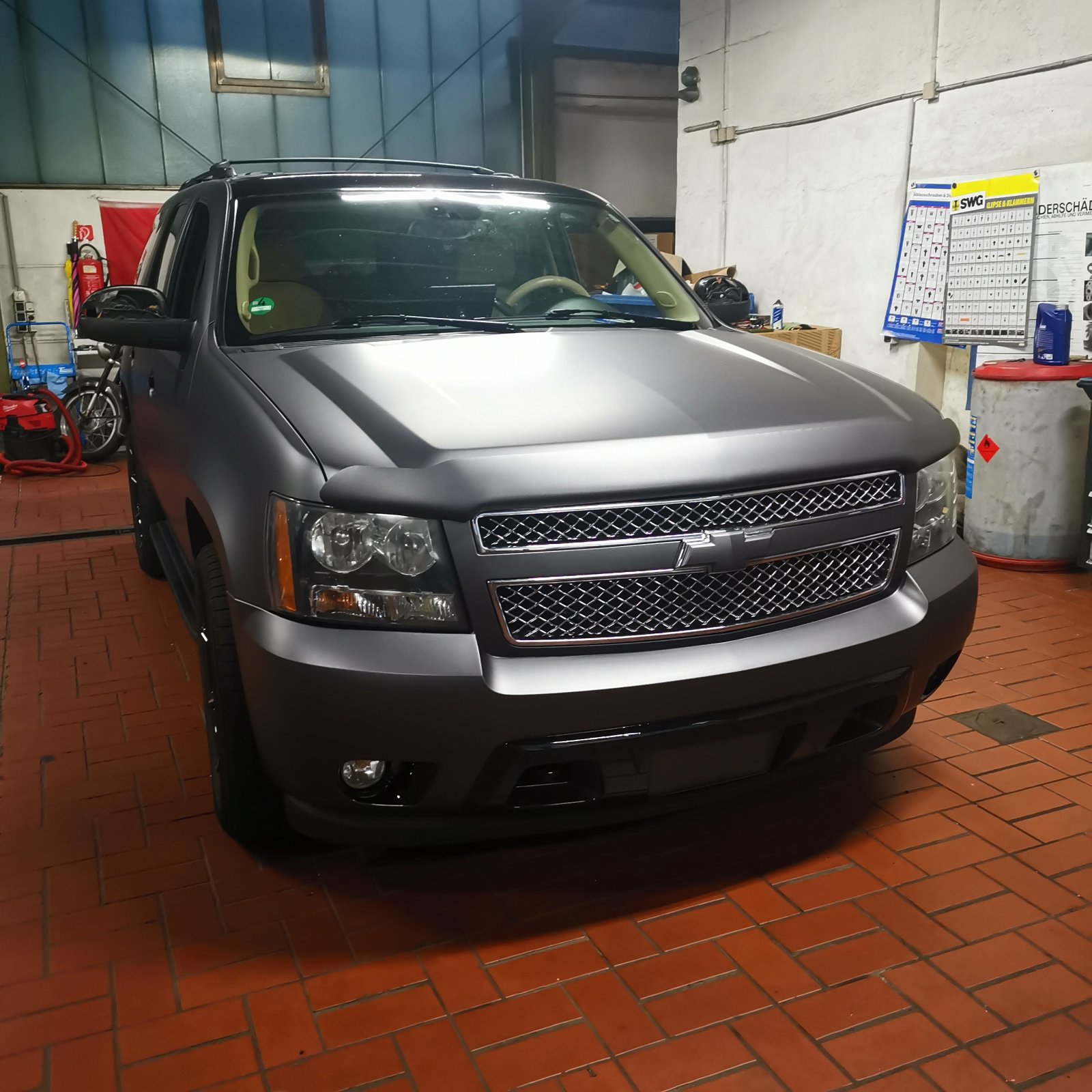

If someone like to see how my Tahoe Looks Like. Here some Pictures.
Now lowering all Standard.
Its the best car I even drive.. Actually build 2007. 424000km with 1 Motor and 1 Gearbox. Its an LTZ with 3 Seats in Front.. I have an Flow master under it. And ist still a nice Daly driver.
