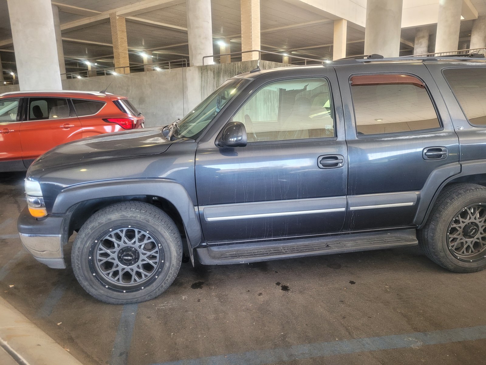

Here's a couple of pics of my hoe. Not perfect needs some work but she mine.
