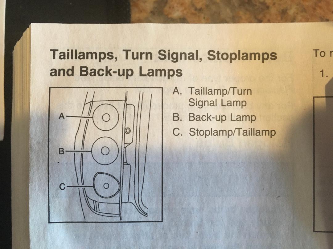

I will refer to these as top - middle - bottom. According to page 502 in my owners manual Top is taillamp/turn signal lamp. Middle is backup lamp and bottom is stoplamp / tail lamp. That does NOT appear to be the functions and replacement bulb pattern ( too difficult to explain ) I am 100% positive I DO NOT have any lamps bulbs in the wrong socket.

NOTE: the bottom lamp on BOTH sides never comes on in any function. According to the suspect owners manual ( page 502 ) the bottom lamp is stoplamp/ tail lamp. Once again I think this is wrong.
If someone can confirm top middle and bottom lamps true function would be helpful moving forward.

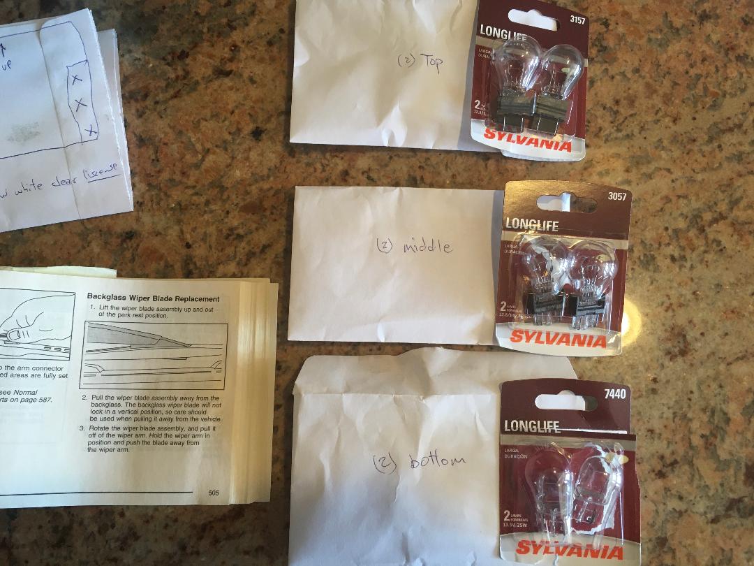

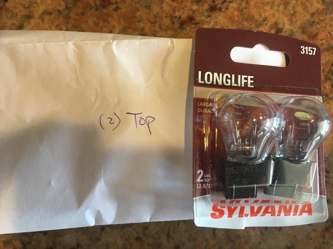

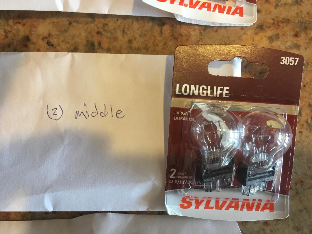

pics

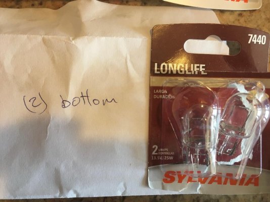

pics

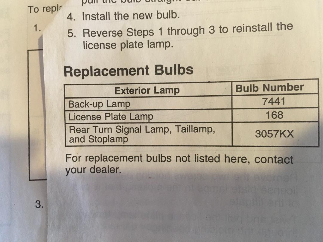

The owners manual is WRONG.
The stoplamp / tail lamp 3057 will NEVER fit into the socket that is C position in the owners manual as the lamp plug assembly DO NOT match.
Why the incorrect info in a owners manual ?? I have no ******* clue what is normal now or not normal.
All I know is my right rear lite assembly is possessed by demons and I have no clue how to troubleshoot / fix it

I think the owners manual may be referring to the Chevrolet tail light assembly as the Chevrolet has the reverse light in the center.

10,344
15,000
The two dual-filament bulbs (turn signals and brakes) are 7443 (ACDelco 15194045 and GMC 13591401)
The single bulb (backup) is 7441 (ACDelco 15524109 and GMC 15524109)
My owners manual is incorrect as well.
Top is lights on running and brake light. Middle is lights on running and turn signal. Bottom is back up.
You likely have a bad ground and/or a short in one of the right rear circuits.
