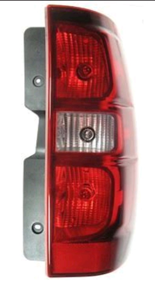

The two dual-filament bulbs (turn signals and brakes) are 7443 (ACDelco 15194045 and GMC 13591401)
The single bulb (backup) is 7441 (ACDelco 15524109 and GMC 15524109)

The owners manual is WRONG.
The stoplamp / tail lamp 3057 will NEVER fit into the socket that is C position in the owners manual as the lamp plug assembly DO NOT match.
Why the incorrect info in a owners manual ?? I have no ******* clue what is normal now or not normal.
All I know is my right rear lite assembly is possessed by demons and I have no clue how to troubleshoot / fix it
My owners manual is incorrect as well.
Top is lights on running and brake light. Middle is lights on running and turn signal. Bottom is back up.
You likely have a bad ground and/or a short in one of the right rear circuits.
