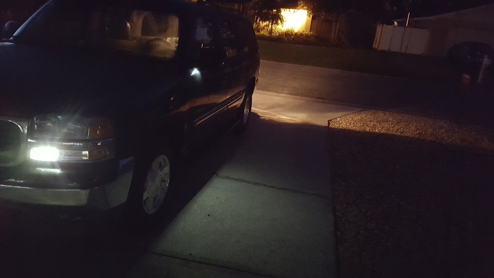

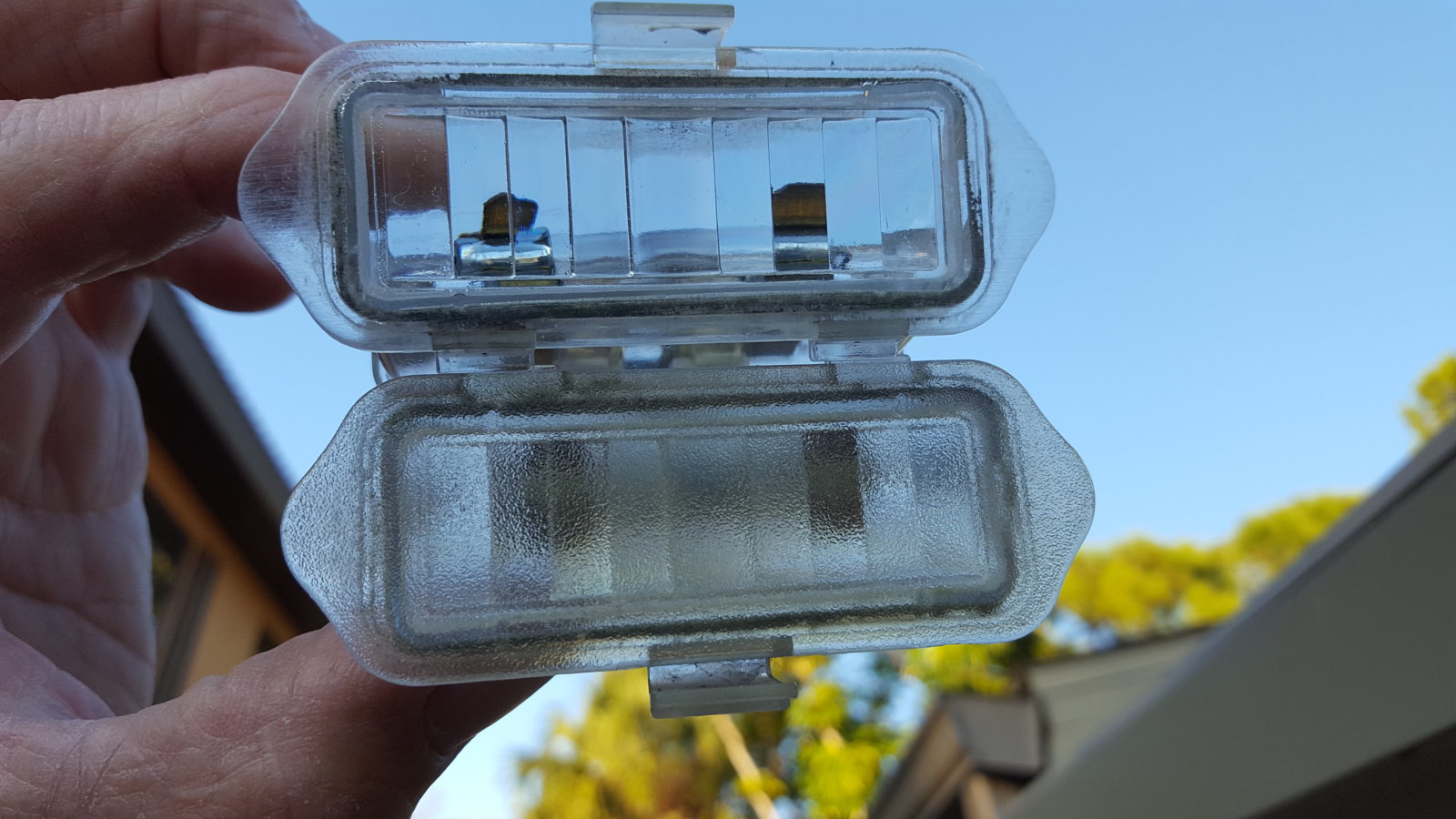

I solved the dim lighting from the puddle lens. I wasn't satisfied with the LED bulb.
It still wasn't bright enough on the ground. I am going to get a 'panel style' LED instead of the tube-bulb LED, with a frosted glass I bought....

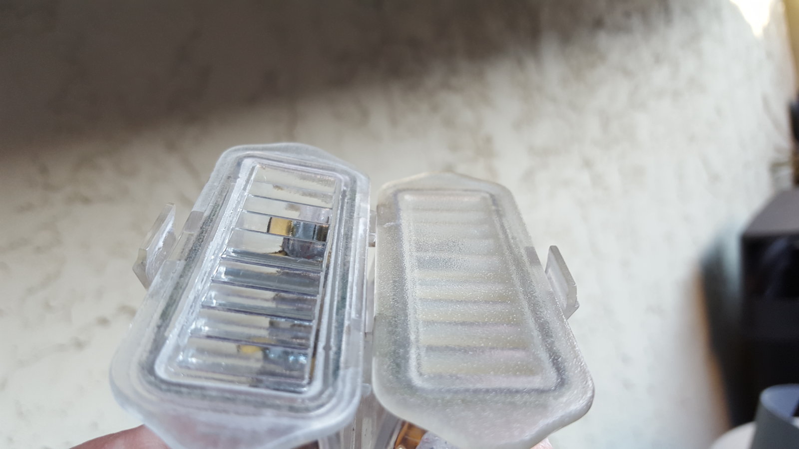

BUT.... The silly original GM style puddle lens is a heavy/ textured finish.... That sucked...
So, I went to the salvage & found 4 lenses.

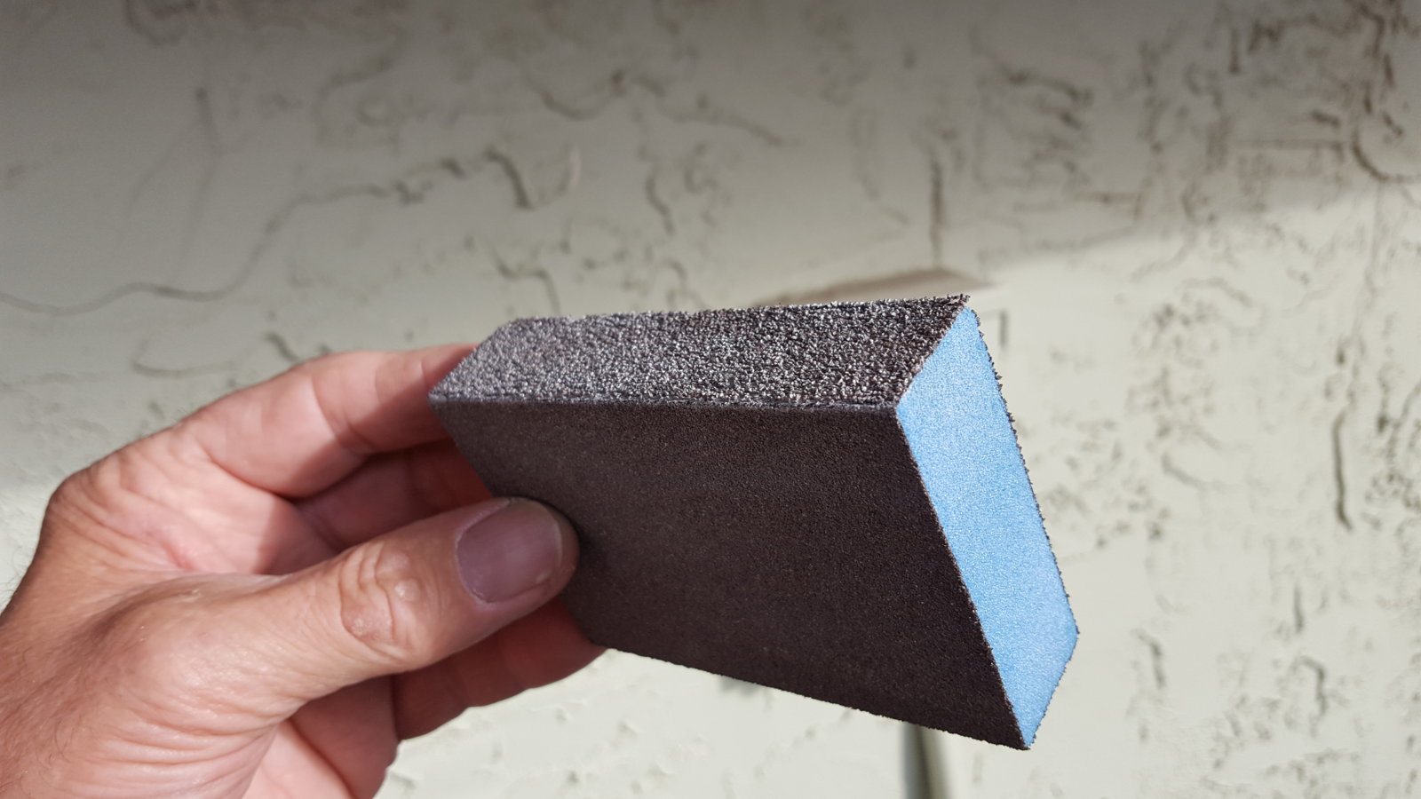

#1 - Get a medium grit sanding sponge. - Start with the heavier grit on sponge. Watch a football game and sand away. ( 20 minutes )...
# 2 - Switch to the lesser grit on the square sanding sponge. - Sand away , back-n-forth. 15 minutes.

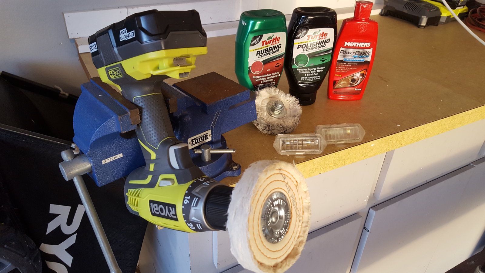

#3 - Mount a drill on your vice with a buffer wheel. Use Rubbing compound. - 10 minutes.
#4 - A second buffing wheel, use Polishing compound. - 10 minutes.
#5 - Plastic polish for a protective finish. - 1 minute
Done. CLEAR !! ( enlarge the last photo to see clarity )

But this sanding down the lens is pretty genius. Worked out perfectly. I vote sticky!:deal:

Your eagle eye was next, if my experiment didn't work. .... I try improving OEM first. My clear lens / LED still won't be as bright as your mod, ( which is very cool & more effective)....
But let's see when I get a 'panel LED' if it's brighter than what I have now...

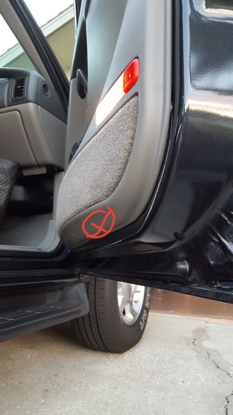

I have been considering a second light mounted on the bottom of the door panel -toward-ground, taping off the lens on the lower panel. That will light up the step & ground whenever you open the door. Hmmmm....

The daylight front is LED ( works great)....Aftermarket tail light, reverse lens is clear so stock bulb very bright ( can't wait to get an LED for that )..... And, Puddle light lens polished clear, using #578 LED 'barrel bulb - frosted' / 6000k / also part called a "212-2 Type ??".....
So many versions of the 578 LED bulb online, hard to know what is actually a brighter light.... The barrel bulbs are only frosted / flat leds should be brighter?
"They describe" the LED "as whiter"..... I want BRIGHTER. Uh, CANBUS? Uh, 'error free'? Sure, but HOW ABOUT LUMINS?????
I think a 'panel style' LED 578 will be brighter for a puddle light, but which one??

I always searched 42mm festoon led bulb. Same as dome lights. Right now I have color changing ones in my dome. I never really cared to get the brightest because hopping into your truck in pitch black and having the dome lights turn into sunlight isn't what I was looking for lol. I ran blue for a long time. I have bright footwell lights and that's what's important for me

I used these. They are a bit wide, so I put them in on an angle, and they turned out exactly parallel to the ground.
They are pretty frigging bright.
